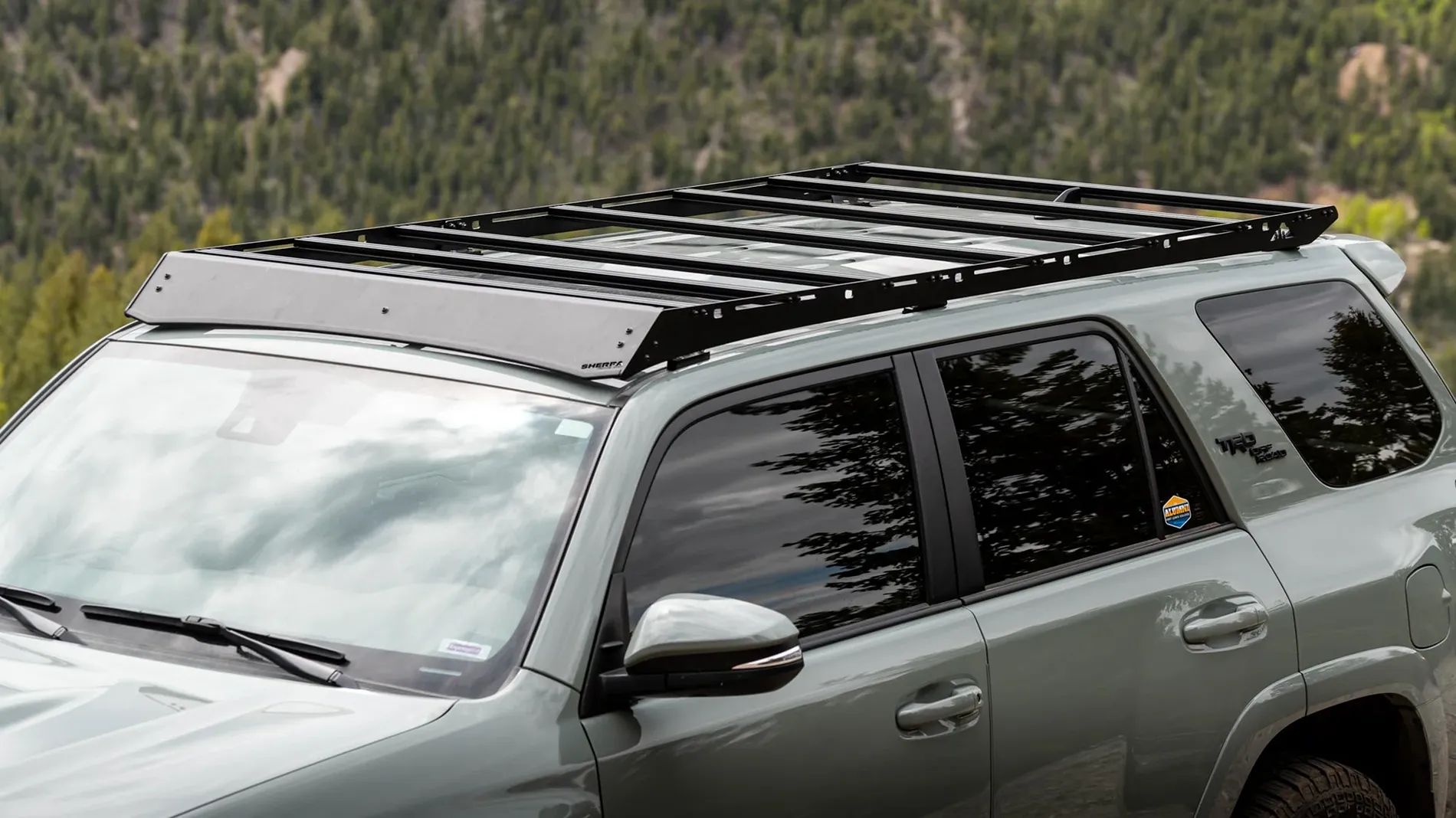

If you are struggling to decide which roof rack to purchase, you are not alone. Whether you're looking at Sherpa, Westcott, Prinsu, etc, there are a lot of choices available on the market.

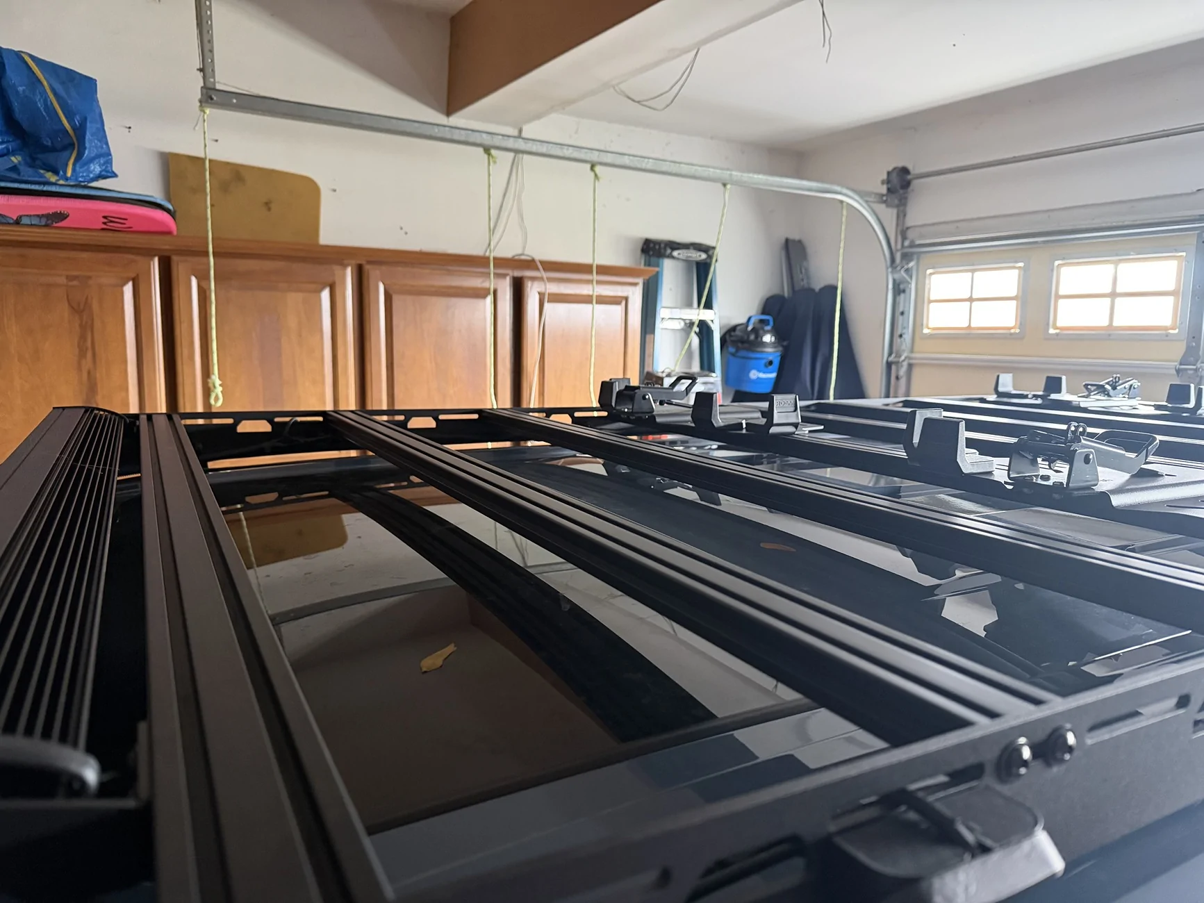

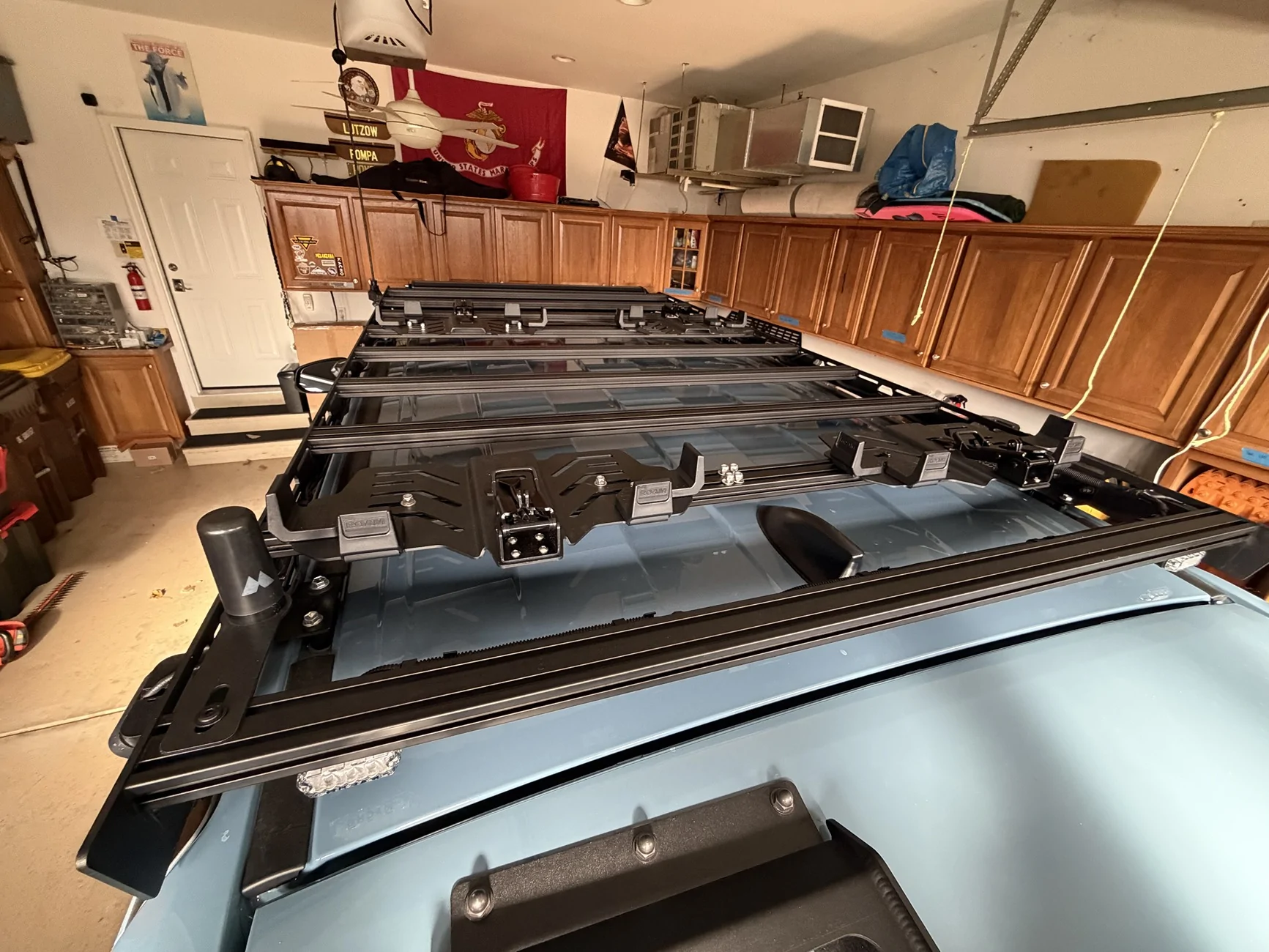

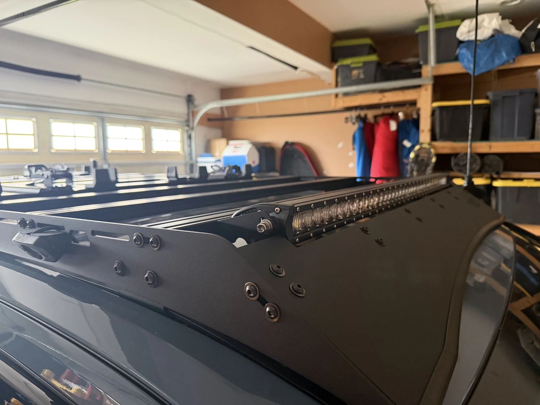

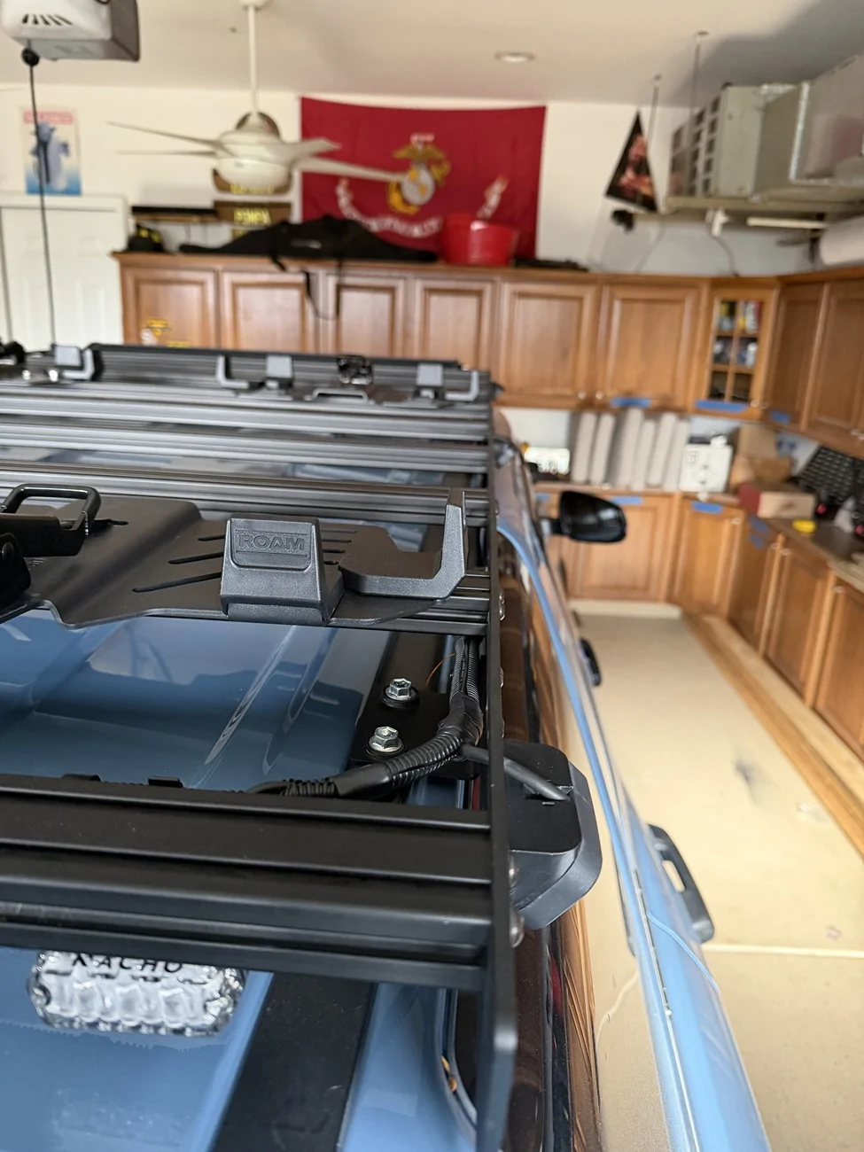

I ended up purchasing the Westcott Designs low-profile roof rack. They have a lot of strong advertising and confidence in their product, which is deserved. This being my first 4Runner, I didn't consider the mounting options, design, and flexibility that a lot of their competitors have. I previously owned a Rhino Rack Platform and just assumed I would have no problem finding hardware, brackets, etc for this new rack. As I am ordering parts in mounting brackets, etc., on my roof rack, I'm now regretting my decision for a few reasons. I'll tell you why....
  1. Mounting. Westcott designs roof racks require you to remove each cross member when mounting anything. If you look at some of their competitors' cross members/supports, you will see that they have notches on the cross bar, which makes it easier to slide in the mounting bolts or nuts. I knew this was going to be required when I purchased this roof rack, but I didn't realize what a pain it would end up being. This has proven to be excessively time-consuming. Not to mention that the bolts that hold the crossbars to the side rails are starting to strip due to having to remove them so many times to run my light and install the mounting brackets.
  2. Product availability. This is one of the things that has become a headache. Trying to find the right mounts, whether it's for traction boards, cargo boxes, or awning brackets, this has really become a hassle and made me have to look at numerous stores online and make phone calls or send emails to companies and wait days for responses before being able to order the parts I need. It seems Westcott is similar to Prinsu in channel width and shape, but again, I cant tell you how frustrating it has been trying to find (heavy-duty!) hardware and parts for this thing. Lightbars-what a pain in the a$$ this was. Trying to figure out which light bar I could use, and pairing that with the specific light bar brackets they offer, was a hassle. When I ordered the roof rack, I wasn't intending on purchasing a light bar right away, as I wanted to do a little bit of research on them. What I quickly found out was that since I ordered the low-profile roof rack with a 41" cutout, I was extremely limited on which light bars I was able to use and ended up having to go with one of the light bars that Wescott recommended, since it was previously tested by them to ensure a proper fit. Choosing a light bar that was not fitted by them and their warehouse could have caused me to order the wrong brackets and be stuck with parts that did not fit properly.

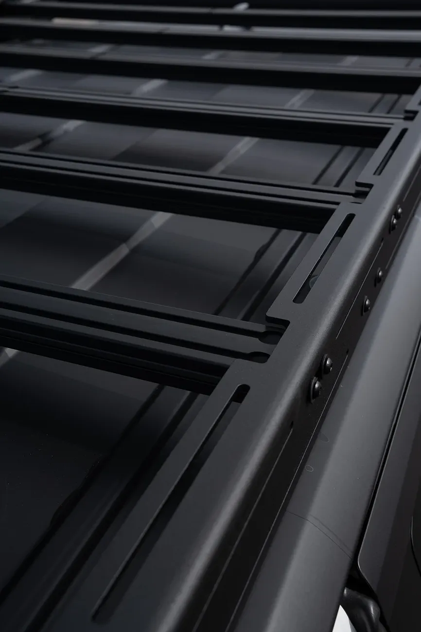

  3. Design. All roof racks are essentially the same, but it's the little details in some that have better design and build than Westcott, which make them more appealing after the fact. Prinsu and DV8 roof racks have a feature that a lot of the others don't, an added slot on the longitudinal supports that run front to back. It might not seem like a huge deal, and maybe you don't think you need them, but I guarantee you would find a use for them at some point (like I could have used one to mount my mobile radio antenna instead of taking up crossbar space!). I wish I had done my research before ordering a roof rack.
