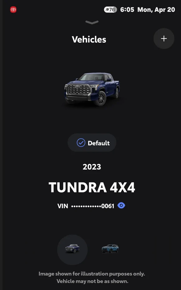

sucky part of the app, you can only set 1 primary vehicle to the account. too bad you cant set a primary vehicle per phone, so i set the wife's tunda as default and i have to go into the app and switch to my 4R if i want to remote start.
