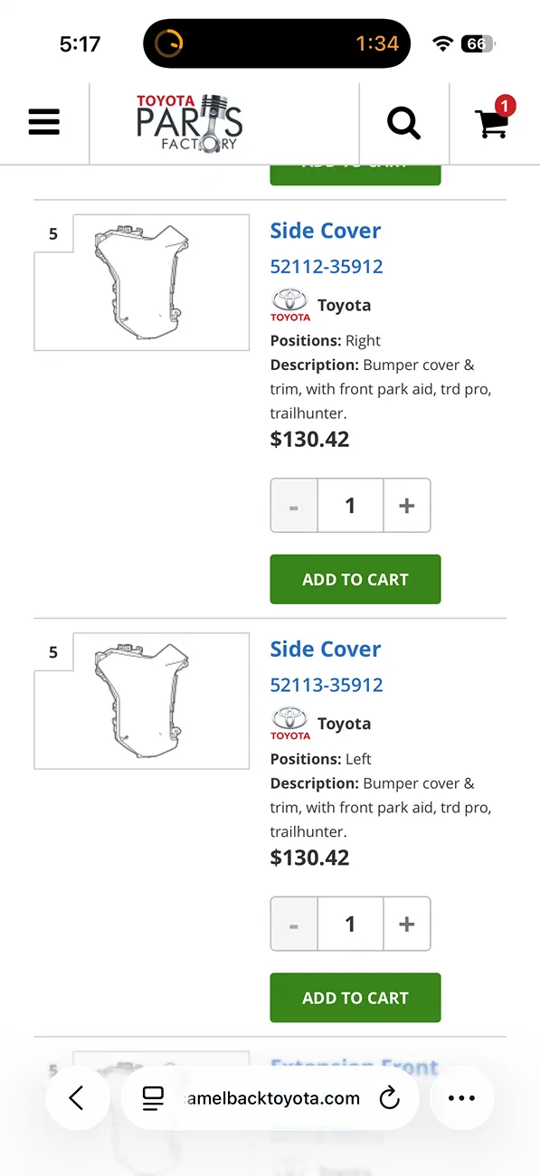

For anyone wanting the TRD Pro/Trailhunter viper cut side pieces for their front bumper, here you go:
52113-35912 (Left)
52112-35912 (Right)
These come unpainted.

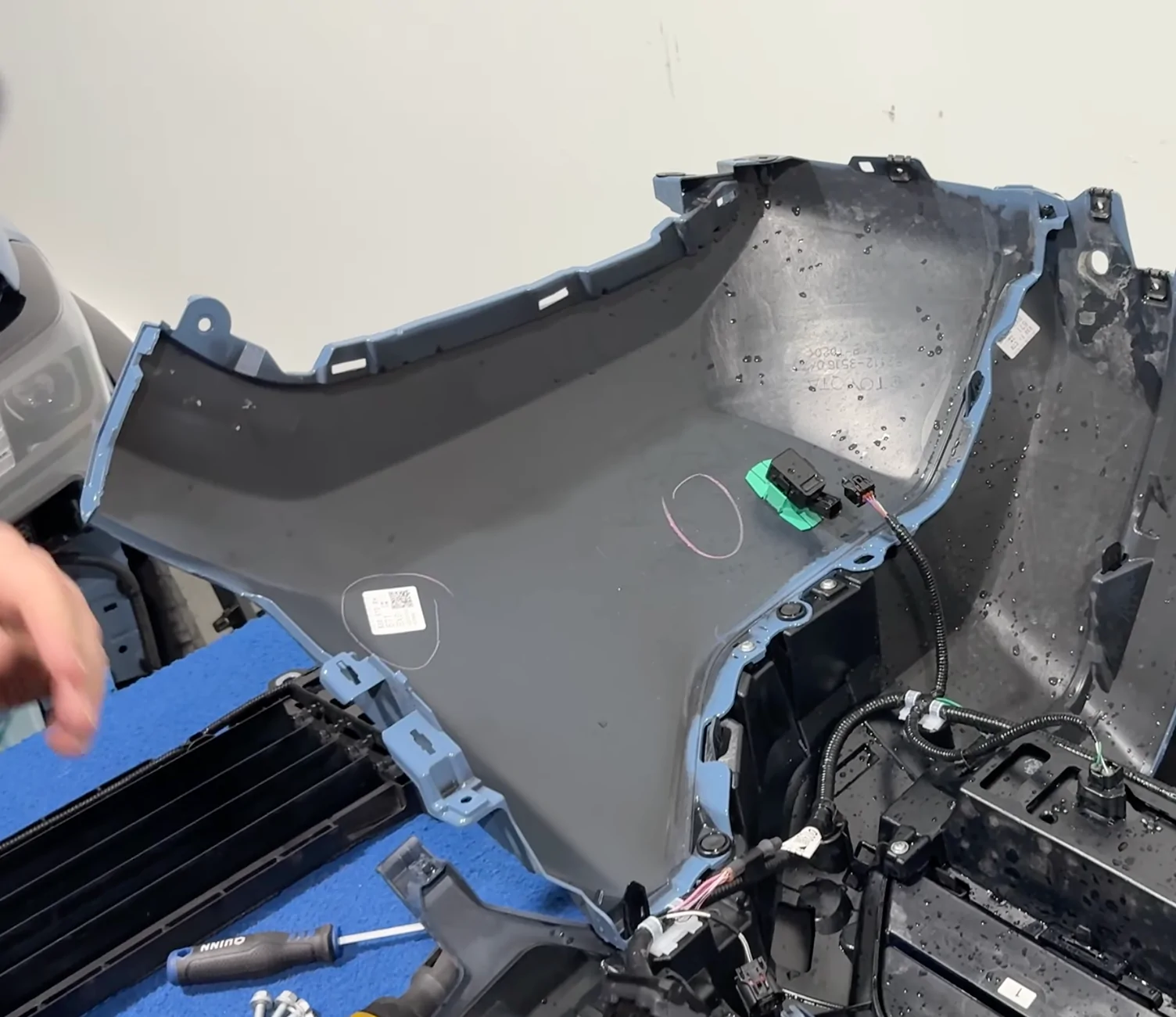

I doubt you could leave the bumper on.
If you watch the Rave TRD Pro grill swap video on YouTube you could probably look at the back side of the bumper and see what you would need to do.

Do you know if the bumper side covers can be removed/replaced with the bumper in place?
No, you’d have to remove the entire bumper. IIRC, there’s at least one screw and 3-4 push clip fasteners that need to be undone to release the side cover from the rest of the bumper (as well as unplugging the parking sensor).

Yeah, that bumper is coming off for this job.
