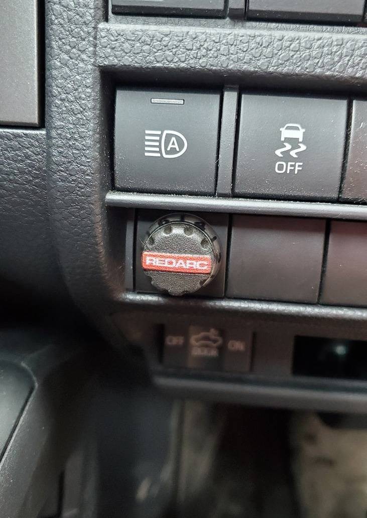

If the 2025 4Runner 6th gen is like the 2024-2025 Tacoma 4th gen, then unfortunately if your 4Runner doesn't come with Tow Tech Package factory installed, then it won't have a wiring harness to connect the OEM Toyota controller under the dash. And owners are finding it very difficult to retrofit install it. Even Toyota dealerships can't find a way to add the OEM brake controller
We won't know for sure until 6th gen 4Runner owners start pulling panels under the dash to confirm. But I suspect it'll be the same situation as the Tacoma.
AFTERMARKET
I've seen Tacoma owners installing Redarc trailer brake controller though, so there's aftermarket solutions at least. I've attached a couple of great installation guides for Redarc Electric Brake Controller posted by Tacoma owners:
Aftermarket Trailer Brake Install Guide #1
https://www.4runner6g.com/forum/att...tallation-for-2025-4runner-6th-gen-docx.7119/
Aftermarket Trailer Brake Install Guide #2
https://www.4runner6g.com/forum/att...instructrions-2025-4runner-6th-gen-docx.7120/
Here's what Redarc brake controller switch looks like installed in blank dash position.
2025 2026 4runner 6th gen Trailer brake controller - installing Factory OEM Toyota or Aftermarket redarc trailer brake controller 2025 4runner 6th gen
Hope that helps!
