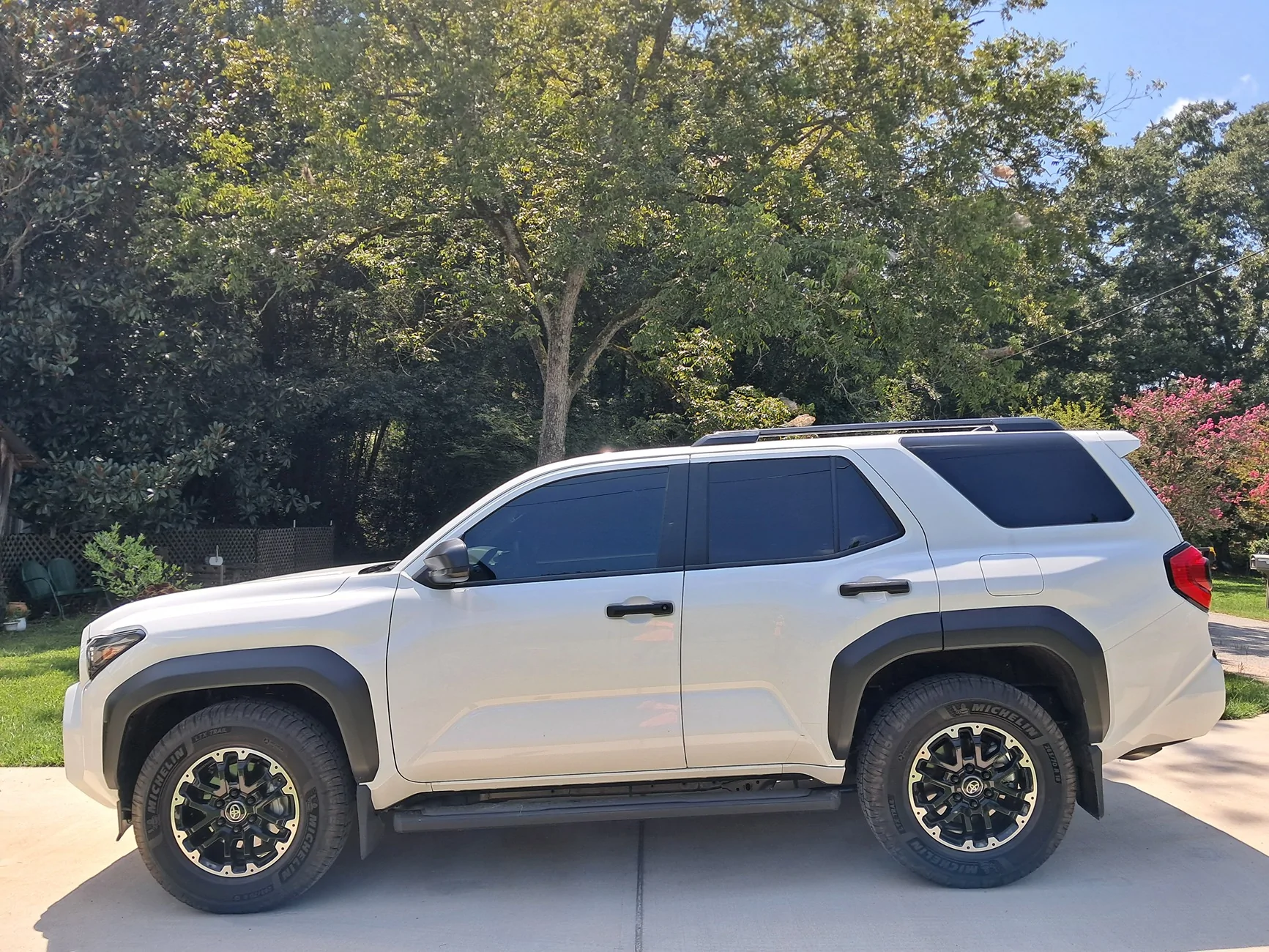

My dealer swapped out my wheels for me when the preformed the 5K service for no charge. Changed SR5 17" wheels/tires for Tundra 18" wheels/tires, both 2026. They didn't reset the TPWS for me and I asked parts dept. and was told they are different p/n. Am I able to program the Tundra TPWM to work on the 4Runner? If not, what is the easiest/best solution? I still have the stock take-offs if I need to use the old TPWM sensors, but they will charge for 8 tire mounts/dismounts, etc. Thanks in advance!

Thanks to all for the suggestions and feedback. I ended up going to Discount tire as they said free to check the sensors and program if needed! Turned out that the Tundra wheels had the TPWS removed and the seller didn't mention it. Discount tire moved the ones from the stock SR5 wheels to the Tundra wheels and programed them... All is GOOD now!
