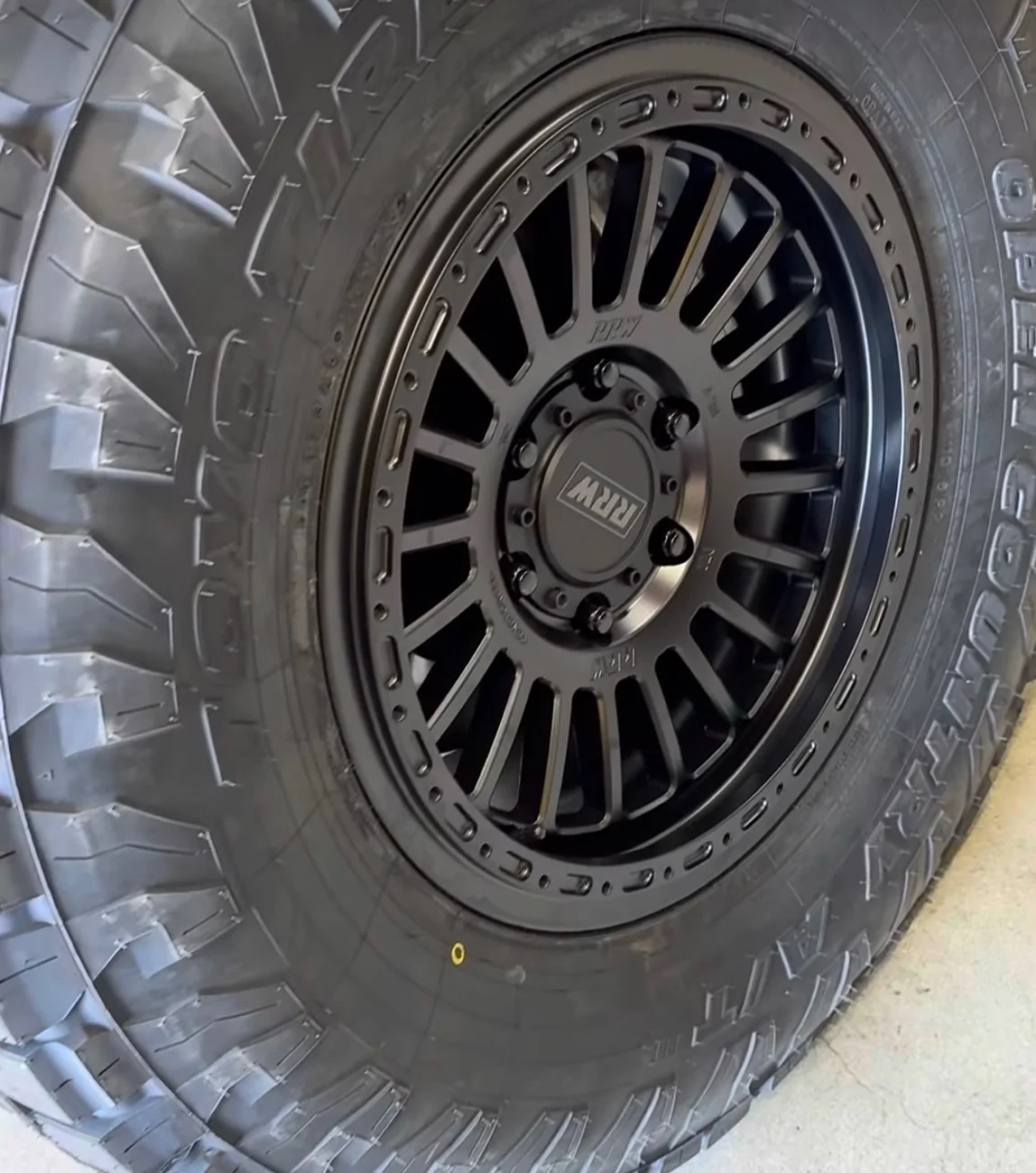

Hey everyone,
I’m having an issue with my OEM TPMS sensors after transferring them to a new wheel setup and wanted to see if anyone else has dealt with this. I moved my factory sensors over to a set of RRW 17” wheels with Toyo ATIII 35” tires, and now I’m getting a constant TPMS malfunction error. For those who’ve run into this, did you end up reprogramming or replacing the sensors to fix it? I’m also about to get another set of RRW wheels with a more aggressive offset, so I have the chance to either install new TPMS sensors or reuse the OEM ones, just trying to figure out the best move to avoid the same issue. Any recommendations for reliable aftermarket TPMS setups. Thanks.

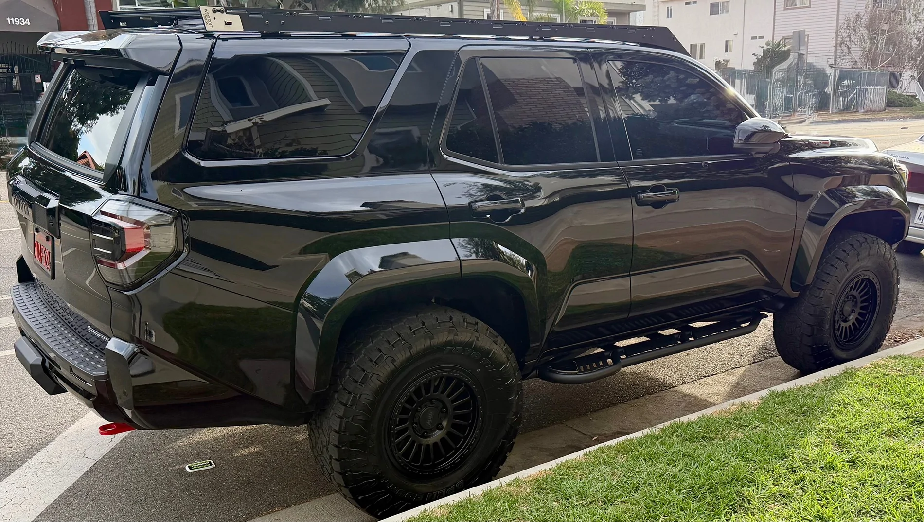

Thanks for the reply! I recently had the Westcott pre-collar lift installed along with new wheels and tires (RRW 17” and 35” Toyos). What’s strange is that the TPMS malfunction didn’t show up right away — it appeared after about a 45-minute drive, then disappeared on its own two days later. Yesterday, after another 45-minute drive, the TPMS malfunction warning came back again. I’m getting new rims soon, so I’m planning to have the installer reprogram the sensors when they’re mounted to see if that resolves the issue.

Wanted to share an update, the TPMS malfunction ended up being caused by removing the spare tire. I didn’t realize the spare actually has its own TPMS sensor, so once it was off the vehicle, the system threw the error. I removed the spare since I’m running larger tires and wanted to cut some extra weight, especially after adding the roof rack, rock sliders, and heavier tires. Plus, with the Westcott pre-collar lift, my TRD Pro has a bit of a reverse rake, so I figured removing the spare might help balance that out a bit. Lesson learned, TPMS sensor is in the spare and that caused the error!

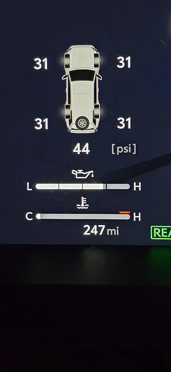

does your TPWS display show 4 or 5 pressures ?
I have a donut, not sure if it has TPWS in it, my display only shows 4 tire pressures

Yeah, the display only shows four tires, but the TRD Pro actually has a full-size spare. Same wheel and tire setup (though the spare tire might have a slightly different load rating). I stopped by 88Rotors, and the guy there told me that removing the spare is what caused the TPMS malfunction. It's common for there to be a TPMS in the spare tire.
1,611
927
older gen's and on other BoF vehicles they didnt always have a 5th sensor.
on the new 4R the MID screen will show tire pressure for 5 tires or 4, depending on trim
