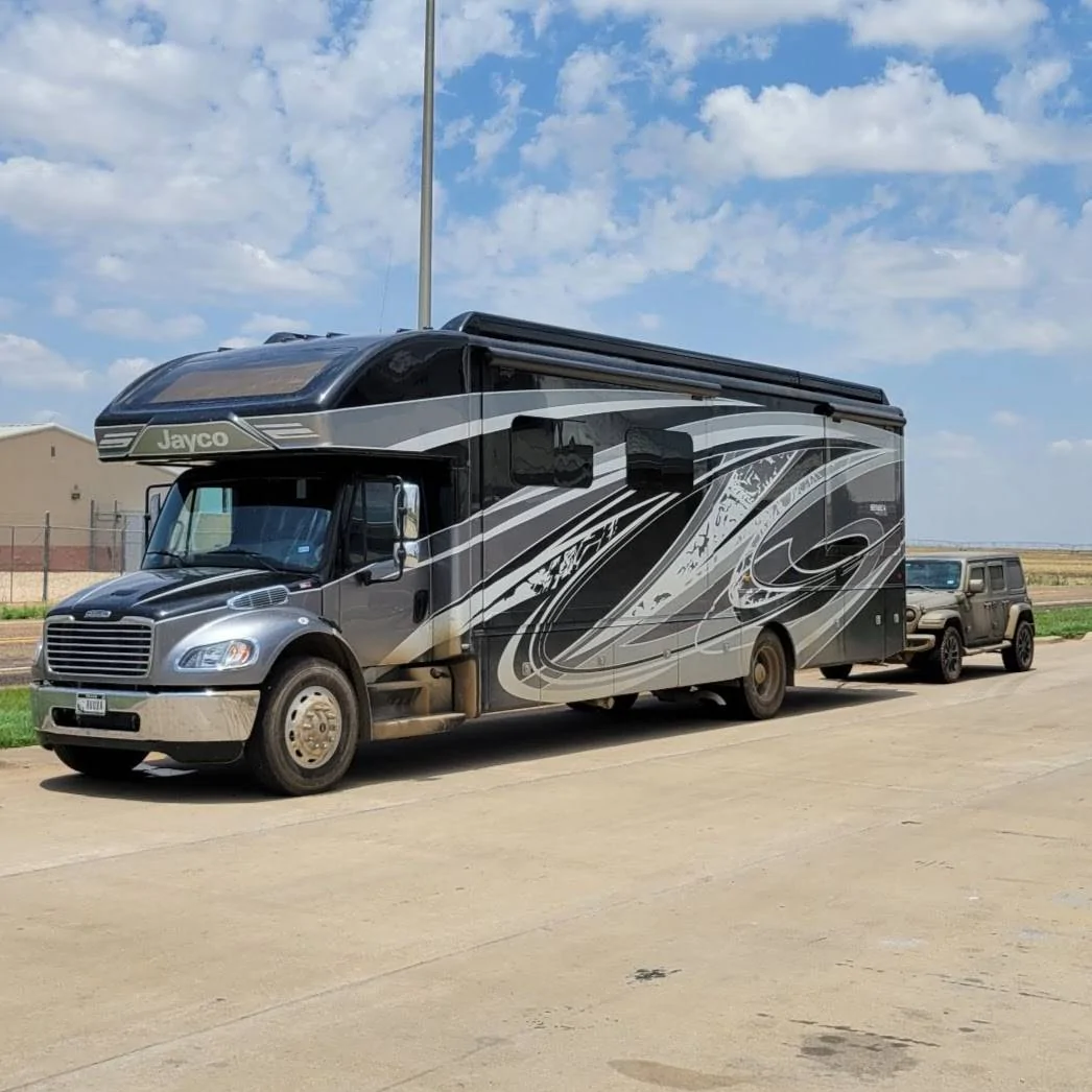

Toyotas cannot be flat towed behind a motorhome like a Jeep can. All Jeeps have a complete drivetrain disconnect, that includes the plug-in hybrid 4xe that I owned, that allows for flat towing. I recently got rid of my motorhome and my Jeep, been an rver for well over a decade. Motorhome dealers and rv magazines publish a list of vehicles you can flat tow and Toyotas are not on those lists. Jeeps always behave great when being pulled and they're not going to automatically jump into gear due to the process required to put them into full disconnect mode. I towed my 2021 Jeep Wrangler over 50,000 mi with no issues. I have seen some Toyota 4Runners put on a flatbed trailer and pulled successfully behind motorhomes. Since Toyotas don't have drivetrain disconnect you will ruin the transmission. I have seen some people disconnect the drive shaft of Toyotas but that seems like an awful lot of trouble to go to. I just bought a Toyota 4Runner Trailhunter to replace the Jeep, much better drivability on the highway, not as capable as the Jeep was off road however.

Having owned four Jeeps primarily to pull behind a motorhome, there's only one process to disconnect the drivetrain and it's very simple. Jeeps automatically going back into gear is not a thing if following the owner's manual instructions. If the instructions aren't followed it won't disconnect the drivetrain in the first place. There's a reason you usually only see Jeeps pulled behind motorhomes is because they are built for that. There are a few other vehicles that do the same like some Ford trucks but if you're an off-roader like me the Jeep is a superior vehicle to pull. That being said, the reason I got rid of my motorhome and the Jeep, My 2021 Jeep Wrangler was recalled seven times and broke down on the trail and the 1-year-old motorhome was in the shop 4 months out of the year. I won't be buying any more American built products since my first Toyota 4Runner lasted me 21 years, I went back to that, and Airbnb.

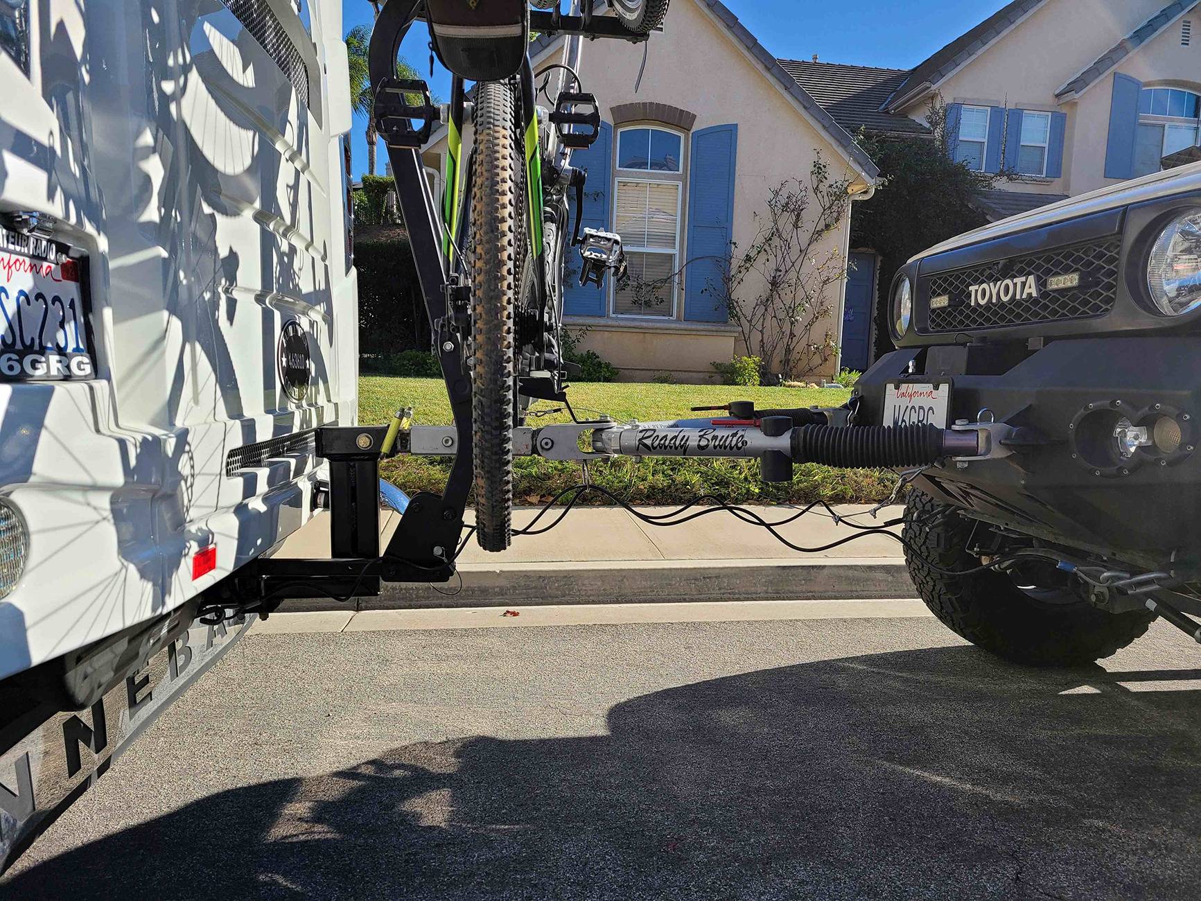

II have a 2025 4Runner gas that I am converting to flat tow. It is replacing my 2010 FJ Cruiser that I have flat towed for 10's of thousands of miles over 15 years behind my motorhomes. A driveshaft disconnect is easy to use, just a little costly to install. Luckily I can reuse some of the parts removed from the FJ.
Only issue I have ever had was the time in New Mexico that I forgot to take off the emergency brake. Never even felt the car dragging, just wondered what the noise was. Only about 100 feet but had to put up with a bumpy ride until I replaced the rear 2 tires with the flat spots!
I'm just not a Jeep person, love my Toyotas!

763
476
2014 4Runner
its surprising that small bar and itty bitty attachment mount is the only thing holding that vehicle attached to the rv.
