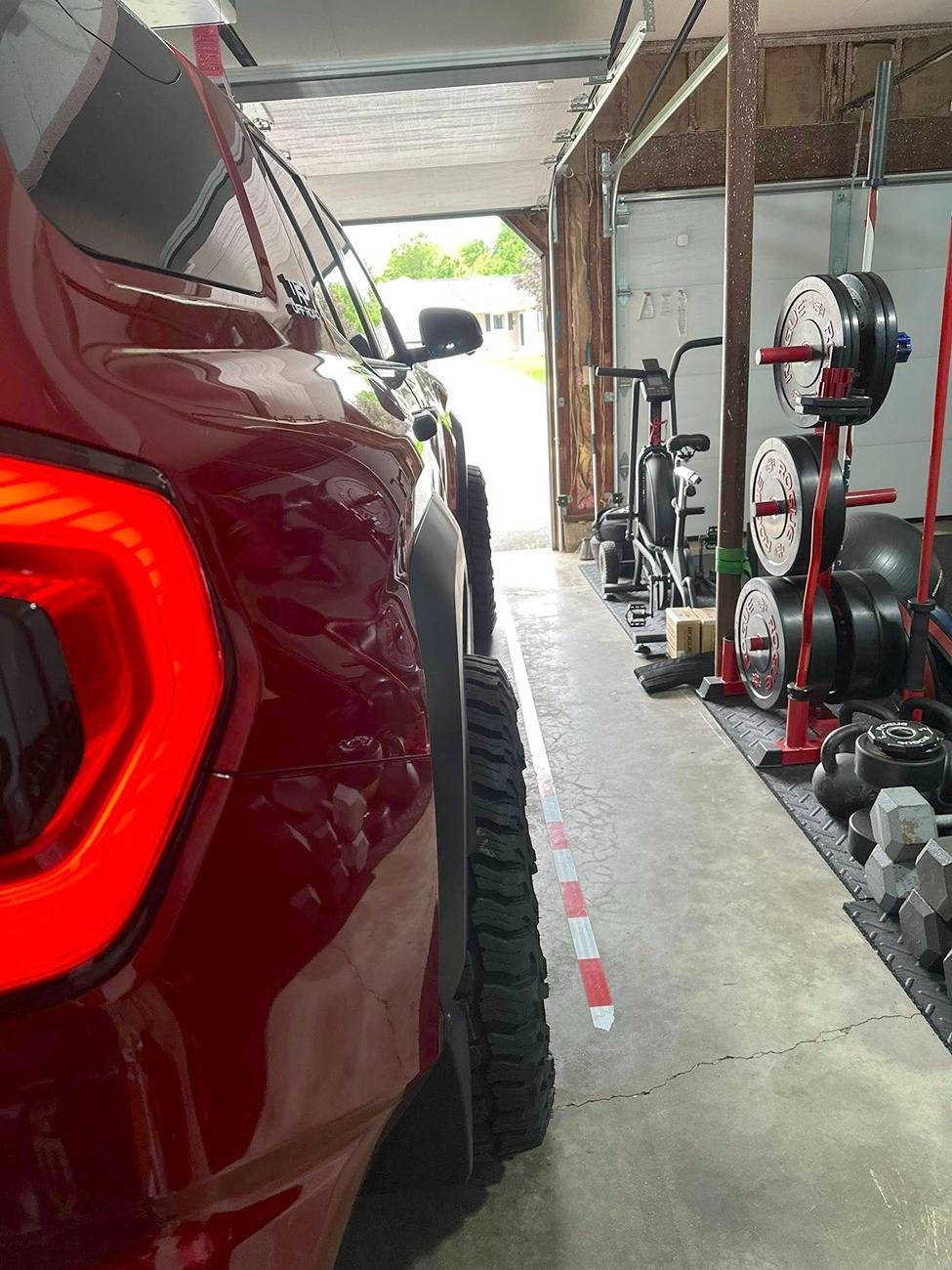

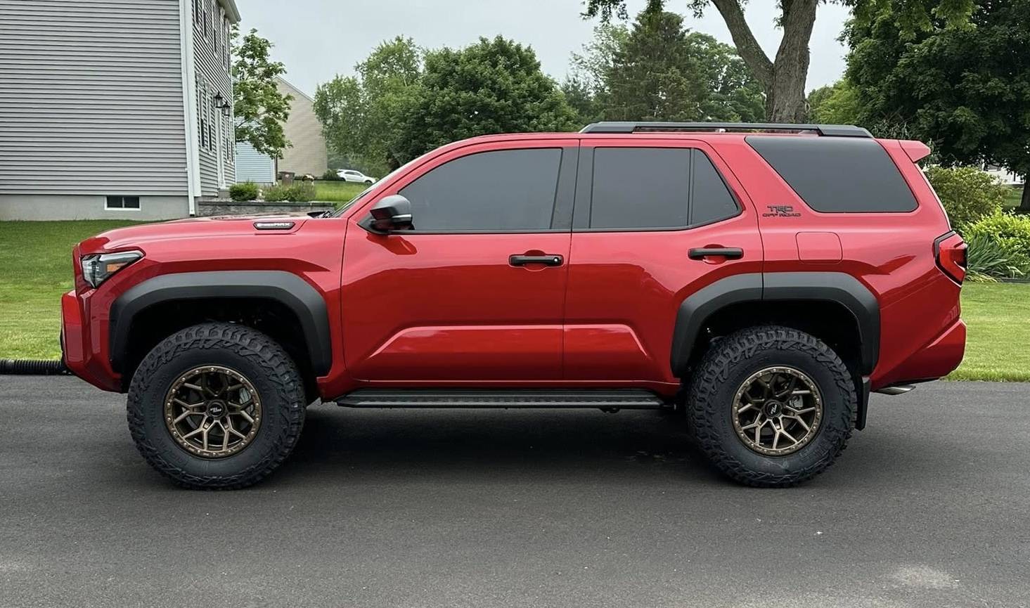

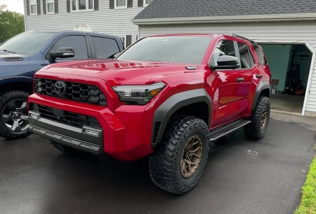

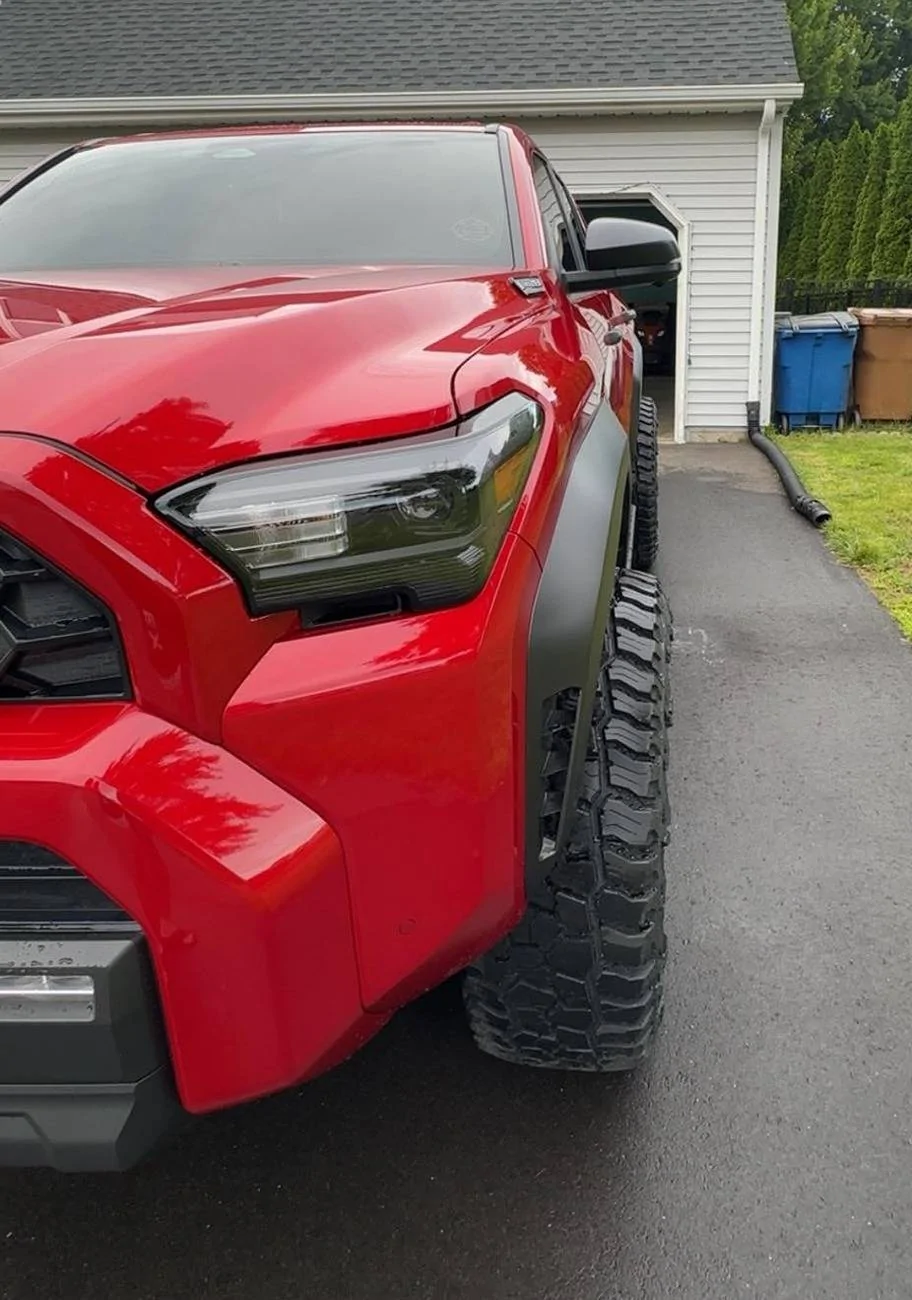

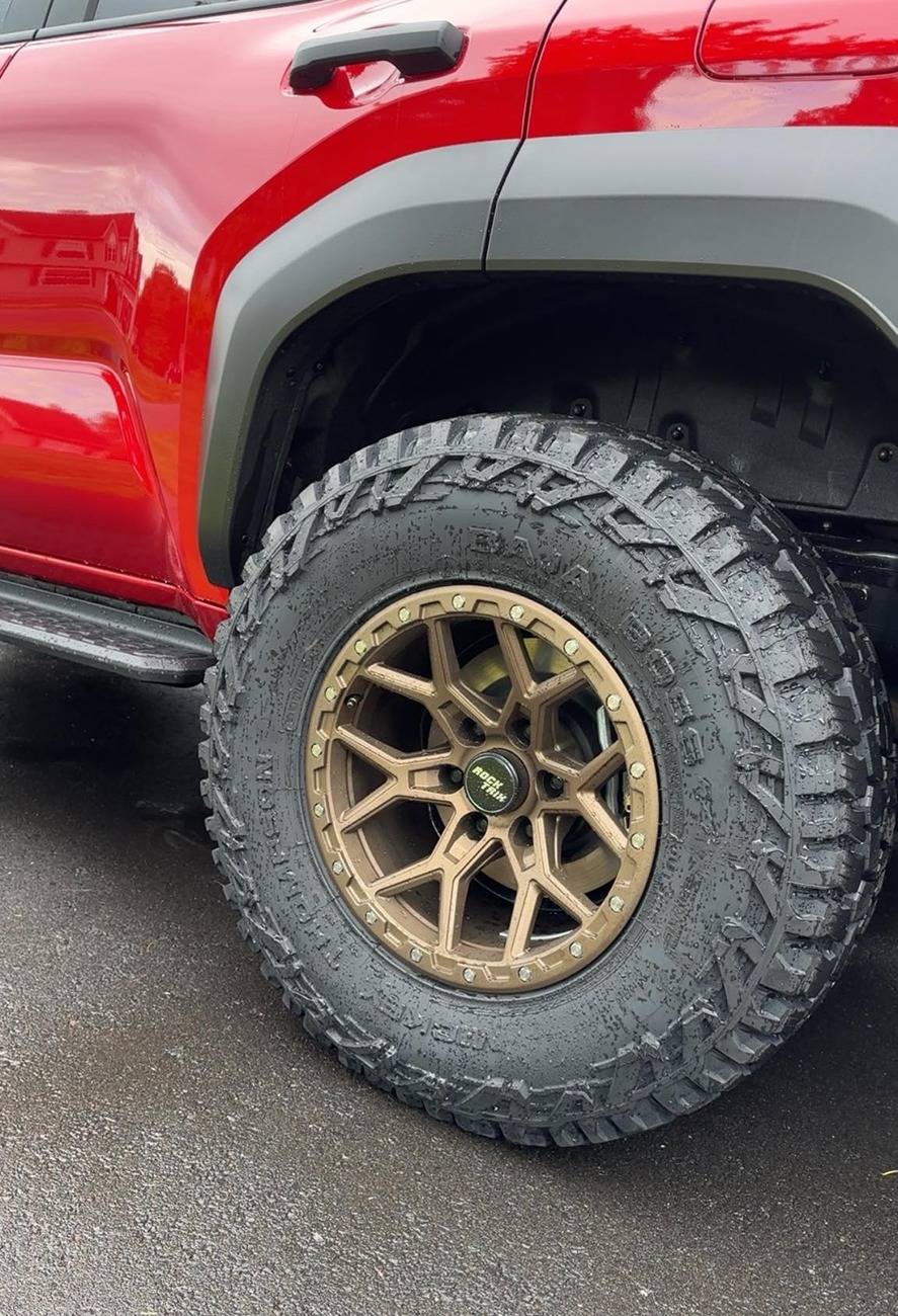

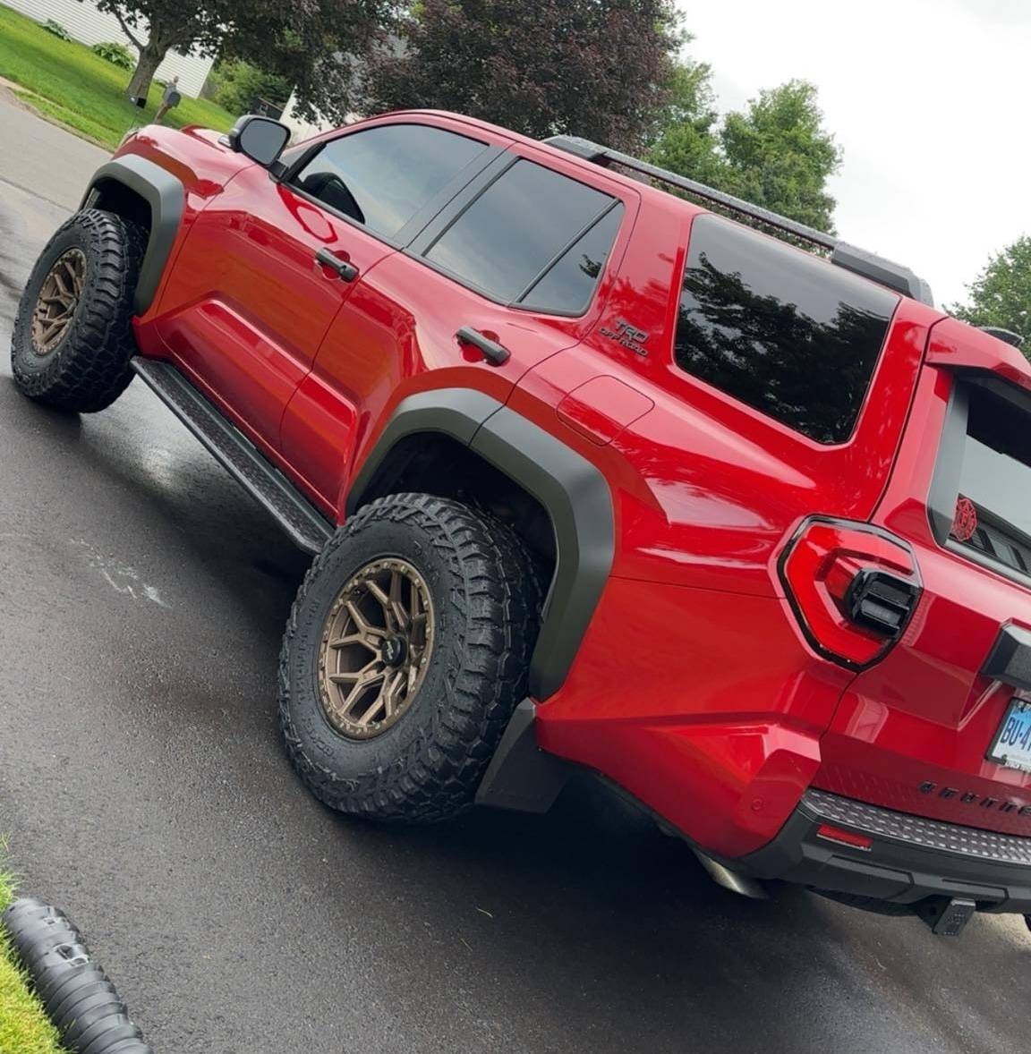

Not my build but sharing for anyone looking for an aggressive wheel and tire fitment.
17x9 RockTrix - 12mm offset bronze wheels (Style RT107)
295/70/17 Mickey Thompson Baja tires (33")
Westcott lift kit
According to the owner: Had to give her a trim a little to make it all work, slight rub against the safety bar, easily removed only three bolts, but pretty decent rub against the bumper. Gonna dremel it tomorrow, won't even notice honestly.
