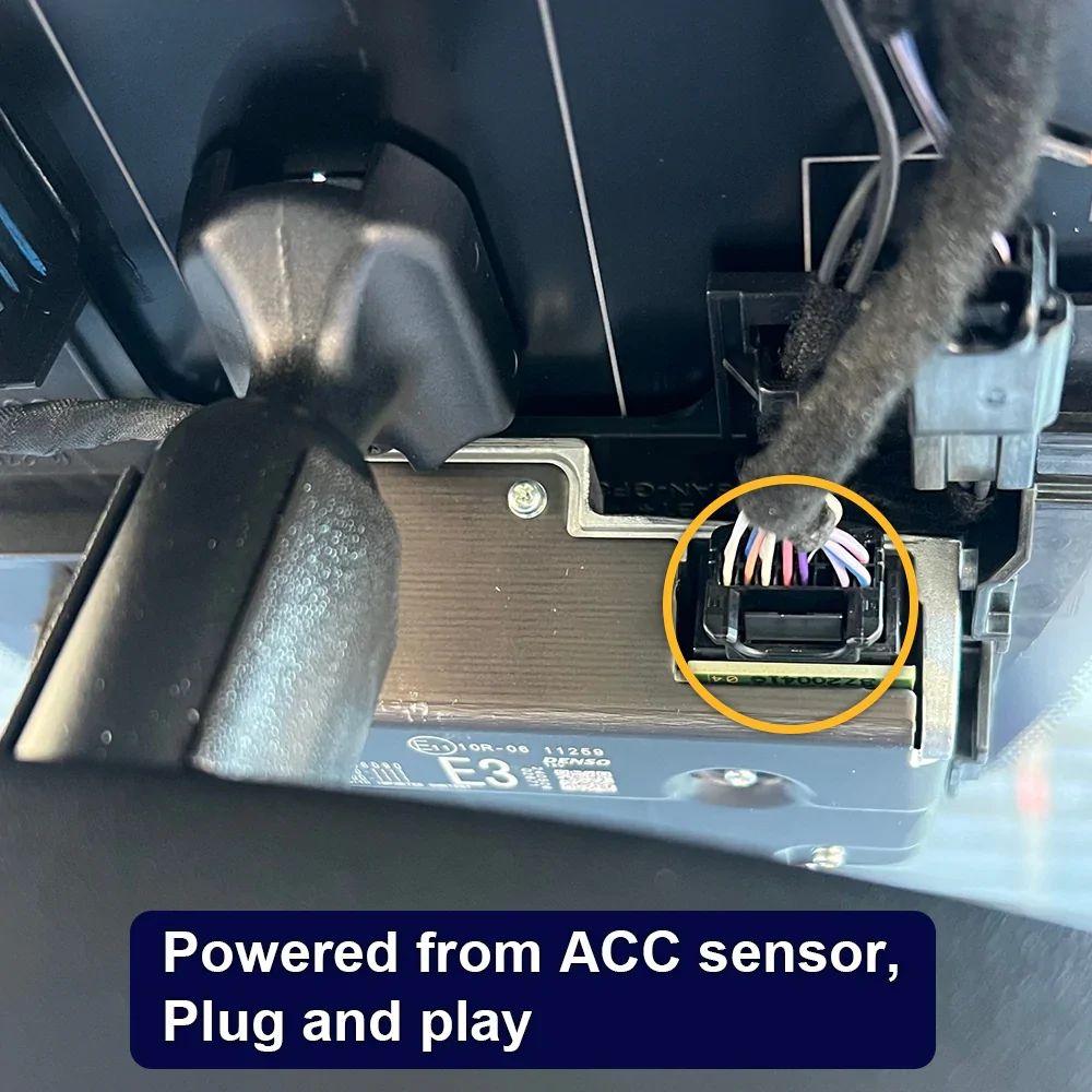

No need to mess with fuse taps, Toyota already provided you with the right power next to where you need it...
Well I have a total of 4 cameras running I used the oem Toyota one for the FitcamX and went into the fuse panel for the wolf box to get 360 parking mode. However you are 100% correct if you only have 1 camera.

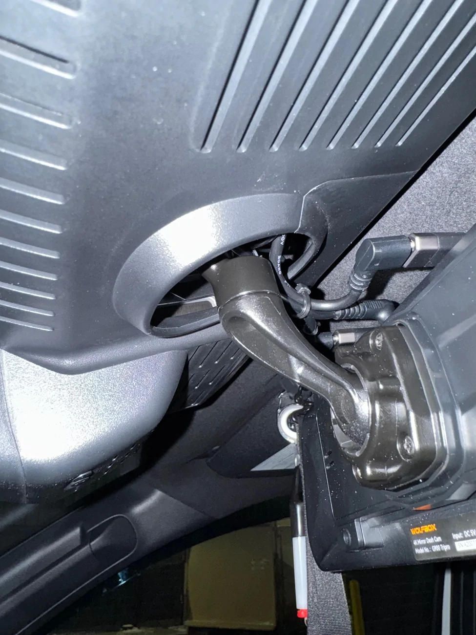

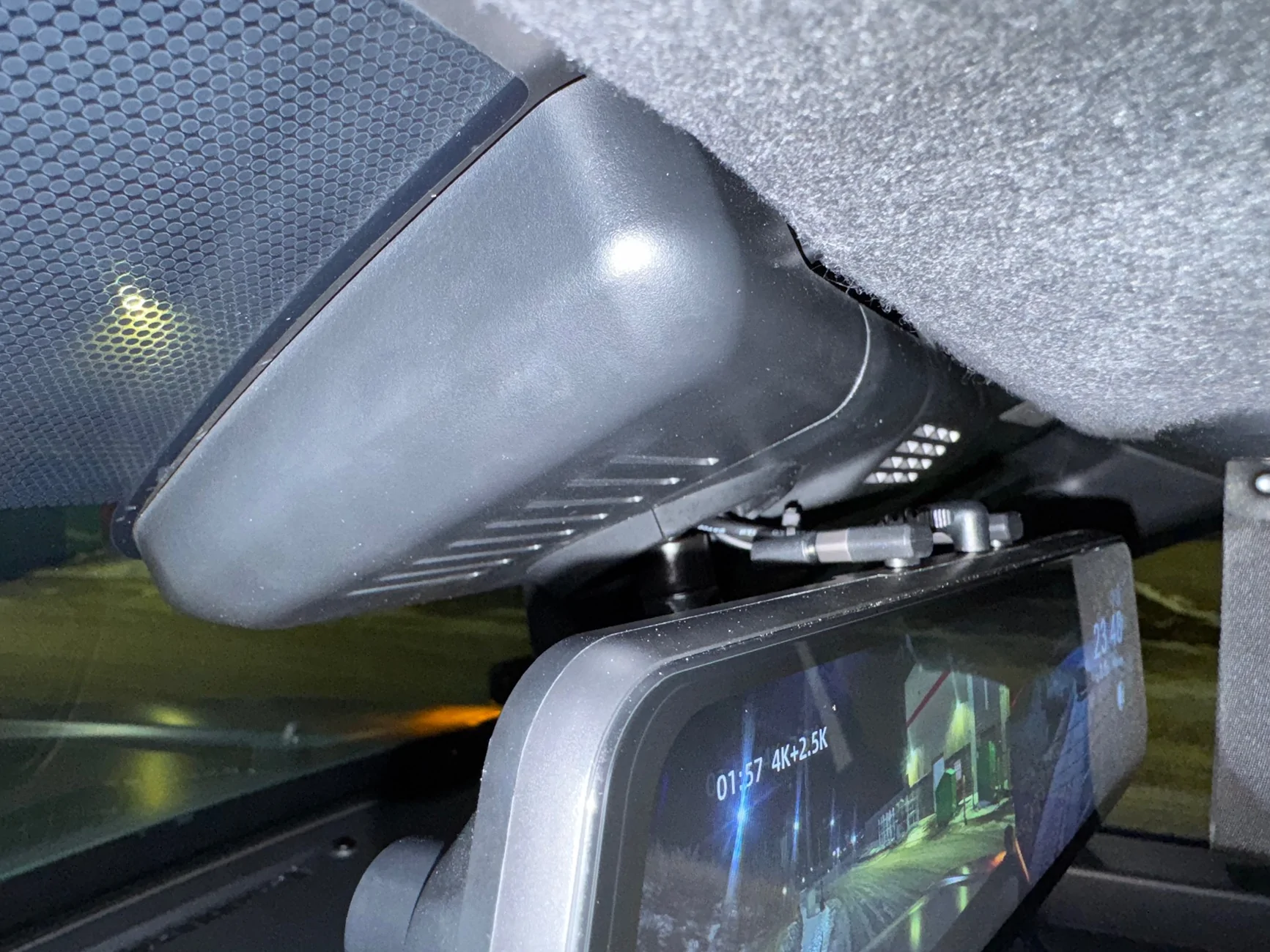

Living with the WolfBox G900TriPro Series.
So I have had this Wolfbox now for the past week in our 4Runner with the #190 Wolfbox Mirror bracket it has made a real impression on me. However I must say that with the bracket they included in the kit really sucked as it just would not sit right and I was not going to strap in over the original mirror as it just looks wrong and is to bulky.
Image of the #190 Bracket:
2025 2026 4runner 6th gen Stormtrooper by Van-Solo 4R (TRD Off Road Hybrid) tempImageZAcz7
Now I also just updated the firmware on this unit and must say the new interface is cleaner and we are enjoying the simplicity of the G900TriPro Series.
For those 4Runners that do not have the OEM factory Digital Mirror this is a must have.
Simple installation and vey enjoyable to have. Currently we only have the mirror and the rear camera installed the bumper cam will be used in the near future as an undercarriage cam as we have the factory bumper cam options already. This Camera (Bumper cam WolfBox) will allow for a more detailed wheel view on the trails.

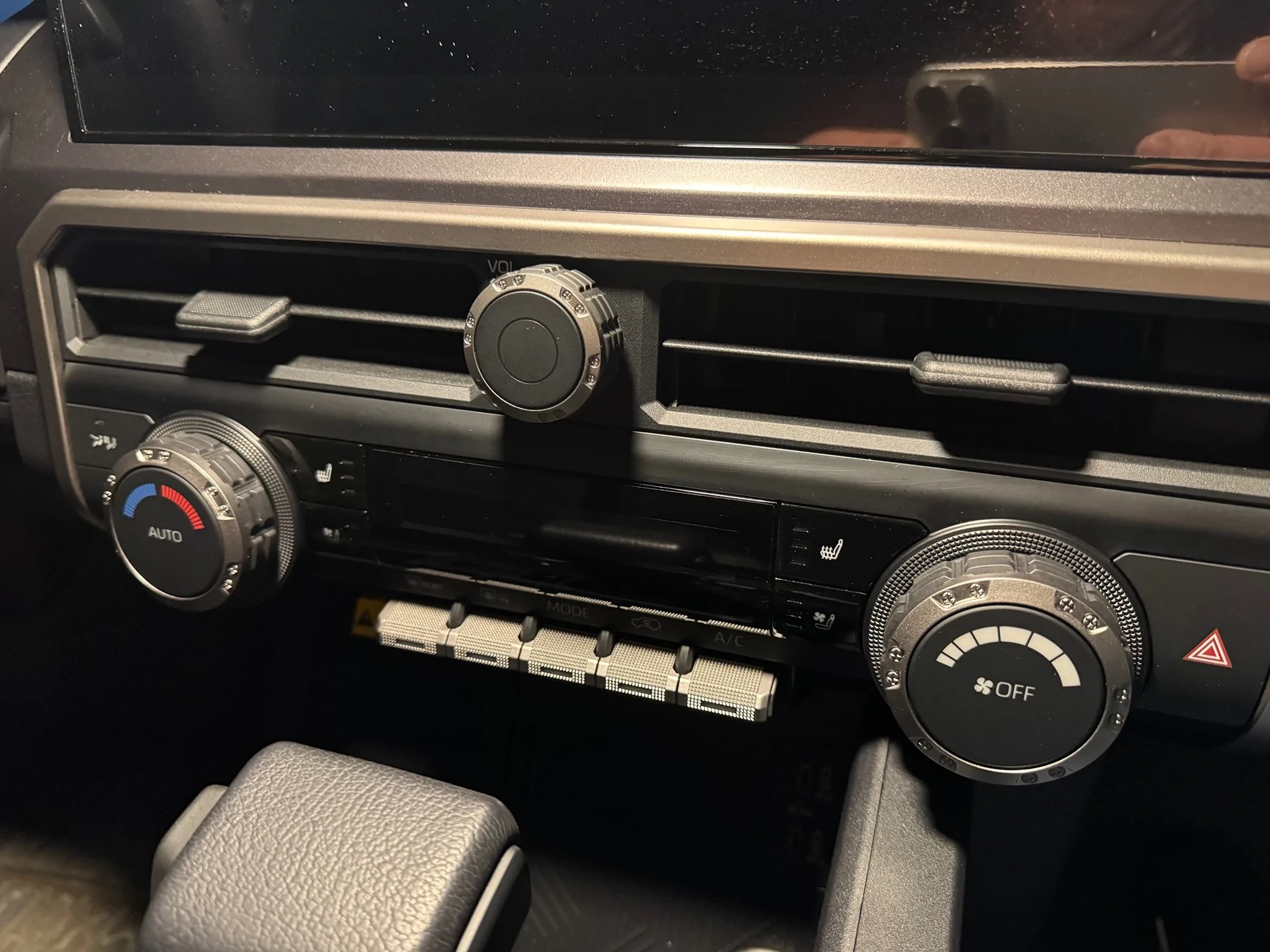

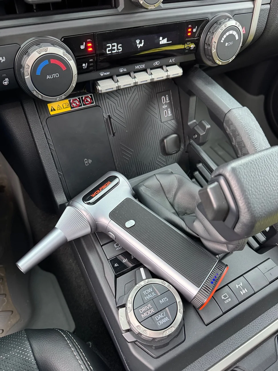

@Wolfbox MF 200 Air Duster
2025 2026 4runner 6th gen Stormtrooper by Van-Solo 4R (TRD Off Road Hybrid) IMG_2676
So I took delivery today of the @Wolfbox MF200 Blower, an item I was not to sure about to be honest I asked myself what do I really need this for?
I first tried it out on the air vents on the top dash, you know the ones that collect a lot of dust that you can't really get too. Well the MF200 blasted the dust away and it looked like the day I took delivery of the vehicle. Further I attacked all the air vents and got them all cleaned out of the dust.
What else can I use this for I asked myself and yup we sprayed the dash with the Gyeon Interior cleaner and instead of wiping it I used the MF200 to blow the cleaner into every crack corner and button crevice I could find. Not having to wipe it down was amazing! Faster and more efficient in every way. Next we tackled the door panels and remaining interior panels quick and easy.
Getting under the seats to blow out the debris such as sunflower seeds or other food particles made it easier to vacuum it up once it was all blown out.
The unit has 3 settings and using the lightest settings was nice for blowing out the cabin air filter and the hybrid filters being able to slightly extend the life of those filters by a bit instead of buying a new one right away.
(A little extra savings never hurt's)
Using the MF200 on the perforated seats was so great too as a cloth always rubs in the dust and debris.
Overall I am finding new ways to benefit from the Wolfbox MF200.
My wife used it to blow out the dust from behind the TV and soundbar as she normally uses the swiffer's and was surprised how much dust she was able to vacuum up after using the MF200. Now I know I am ok having gotten the WolfBox MF200 she loves this thing too.
Before spring cleaning we needed to take our woozoo fans apart to clean them fromm all the built up dust, but now we use the Wolfbox MF200 and it is done just like that!
Now I am not about to use it to dry my 4Runner, however I will say I am impressed with its power and overall runtime. We will continue to use it and most likely buy another battery to have as a spare in each vehicle.

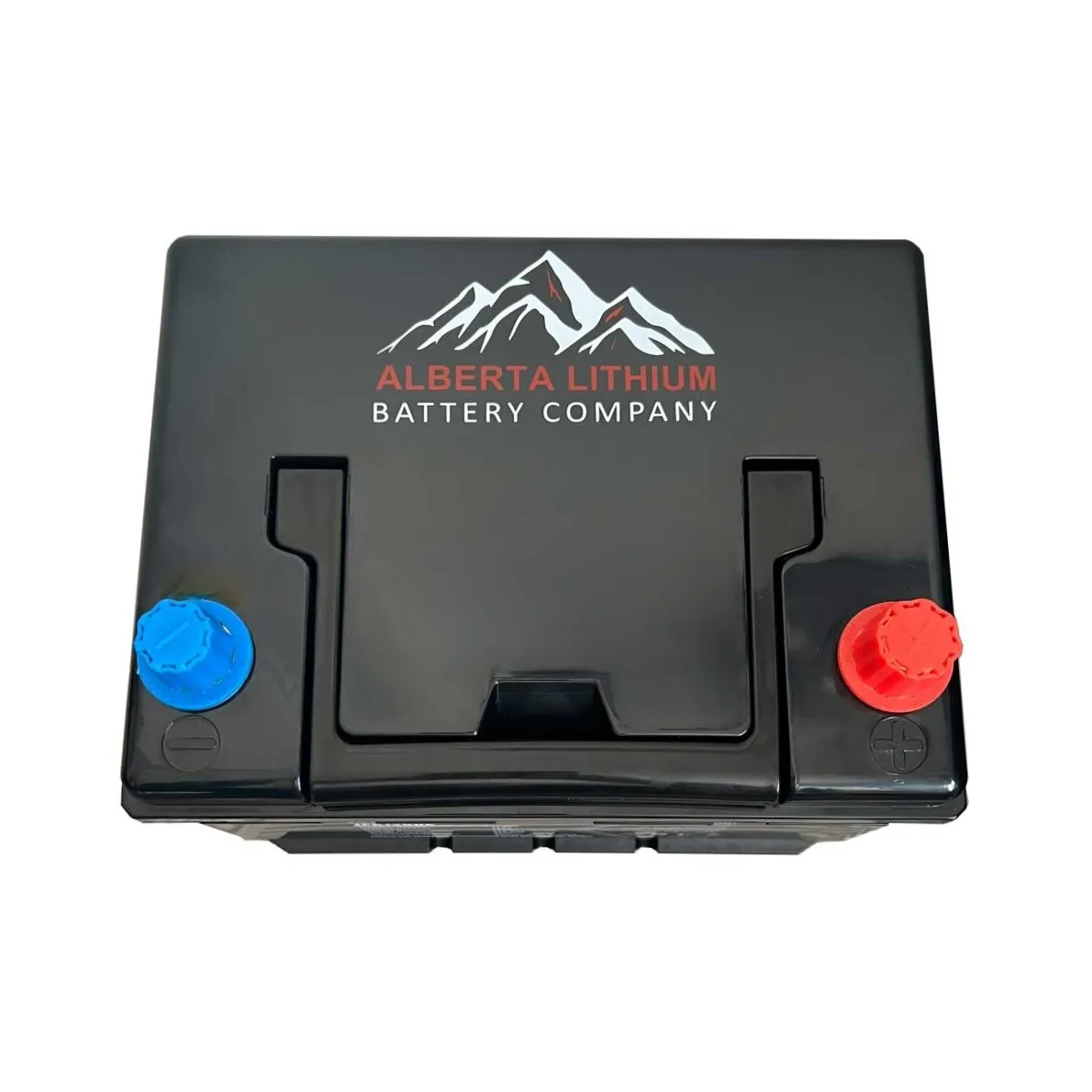

I was looking for an alternative to the 12Volt Lead Acid battery group 48/H6 when I came across this Alberta Strong Company.
I had a great conversation with them that lead me to choose this company for my new battery to power our 4Runner.
The technology this company has put into these batteries is a game changer in my opinion.
Bluetooth that keeps you informed of your battery life and realtime values.
https://www.ablithium.ca/?_gl=1*1nh...BwE&gbraid=0AAAAAD4YHFb2oOGgjt02PN-0LDn2EgTjI
2025 2026 4runner 6th gen Stormtrooper by Van-Solo 4R (TRD Off Road Hybrid) IMG_2696
We decided on the 60Ah 850CCA unit, picking up Wednesday the 21st of January 2026.

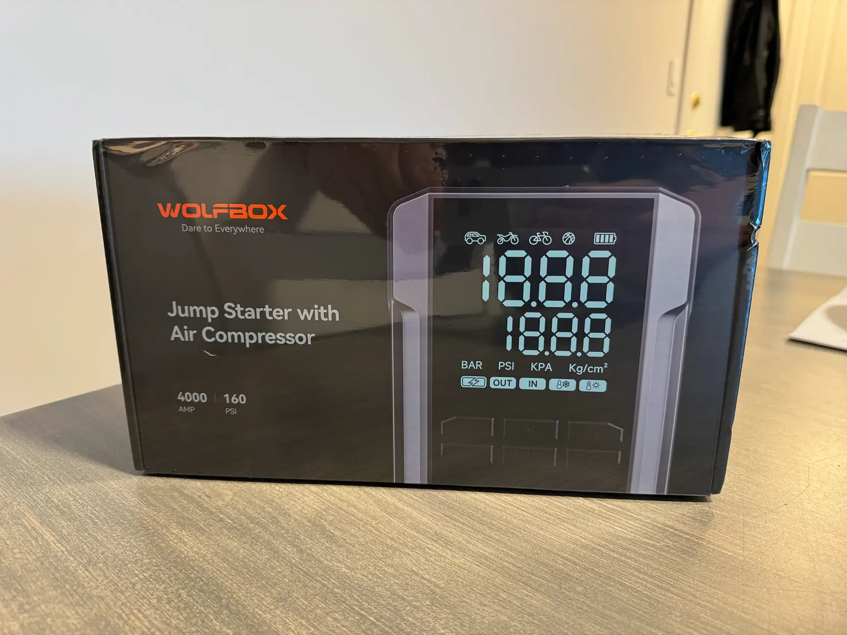

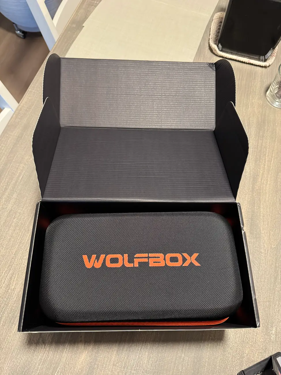

Wolfbox MegaVolt24 Jump Starter & Air Compressor Review
Charging up, Finally just one device to carry instead of two units!

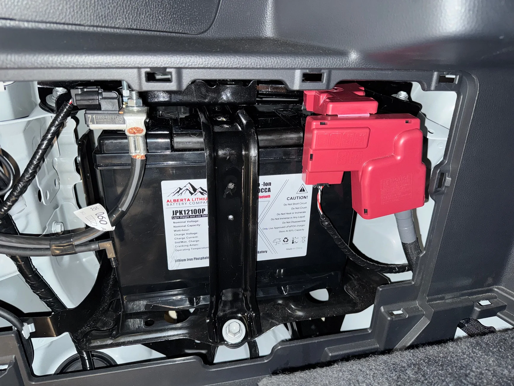

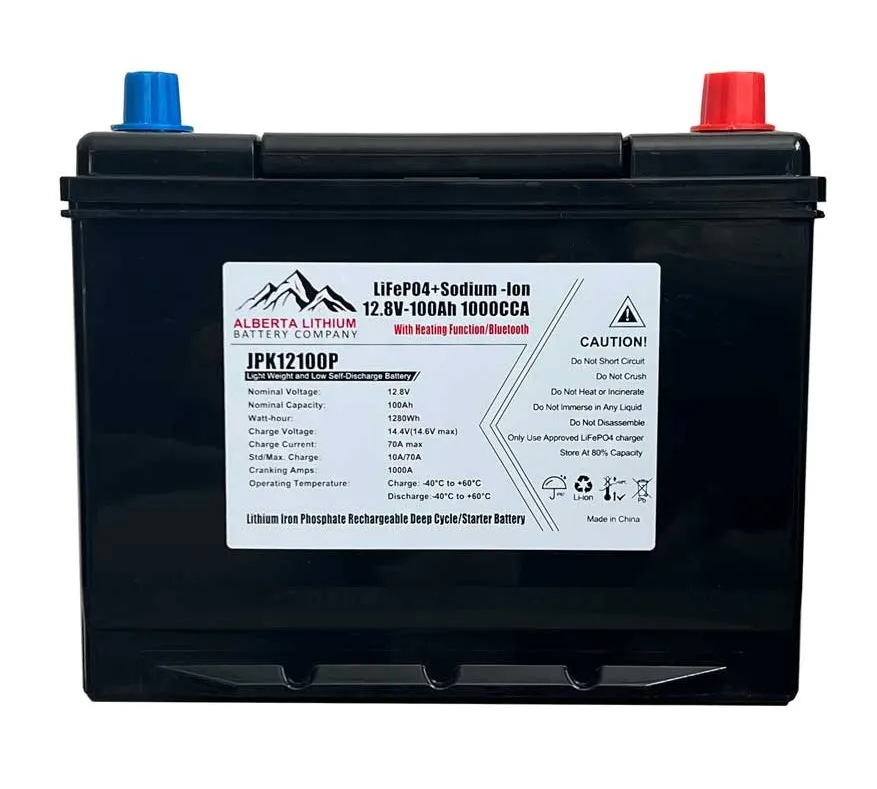

Update: Alberta Lithium Battery
https://www.4runner6g.com/forum/thr...van-solo-trd-off-road-hybrid.4232/post-103120
Upgraded today to the Group 24 Sized Alberta Lithium Battery featuring:
100Ah / 1000CCA Deep Cycle / Starter Battery.
Tiny but mighty, Group 24 in size with 100Ah of capacity and 1000CCA of power!
Integrated heating system which will preheat the battery to 5 degrees Celsius when a charging source is detected. With the integrated Na-ion battery to absorb voltage spikes from high capacity or less than optimal charging systems.
  • Waterproof IP67 rated
  • Mercury Specification Compliant
  • 6000 cycle life at 80% discharge
  • Grade A dry prismatic cells
  • Short circuit protection
  • Over charge and discharge protection
  • High temperature protection
  • Integrated Bluetooth connectivity using our Alberta Lithium app for IOS and Android

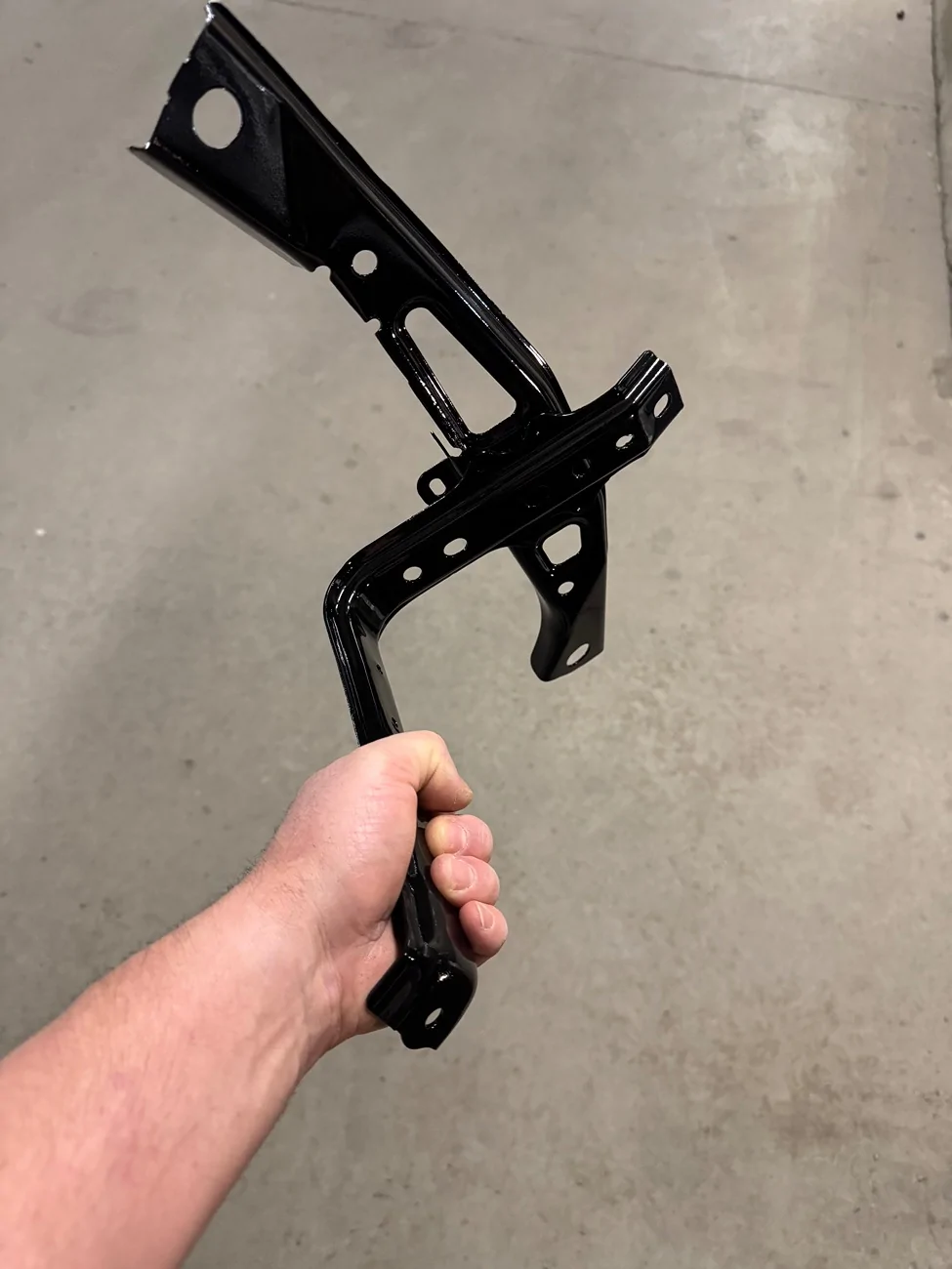

We had to modify the Top battery mounting bracket of the 4runner to allow for the Group 24 Battery to be accommodated (Images Soon)
(OEM Battery Bracket)
We removed the two battery hold down points from the back and front side of the bracket by drilling out the Spot Welds. We then filed the edges smooth and then proceeded to cut out a piece that runs near the Positive Battery Post as the battery is taller than the original H6 / LN3 and filed the cut edges smooth and started the painting process.

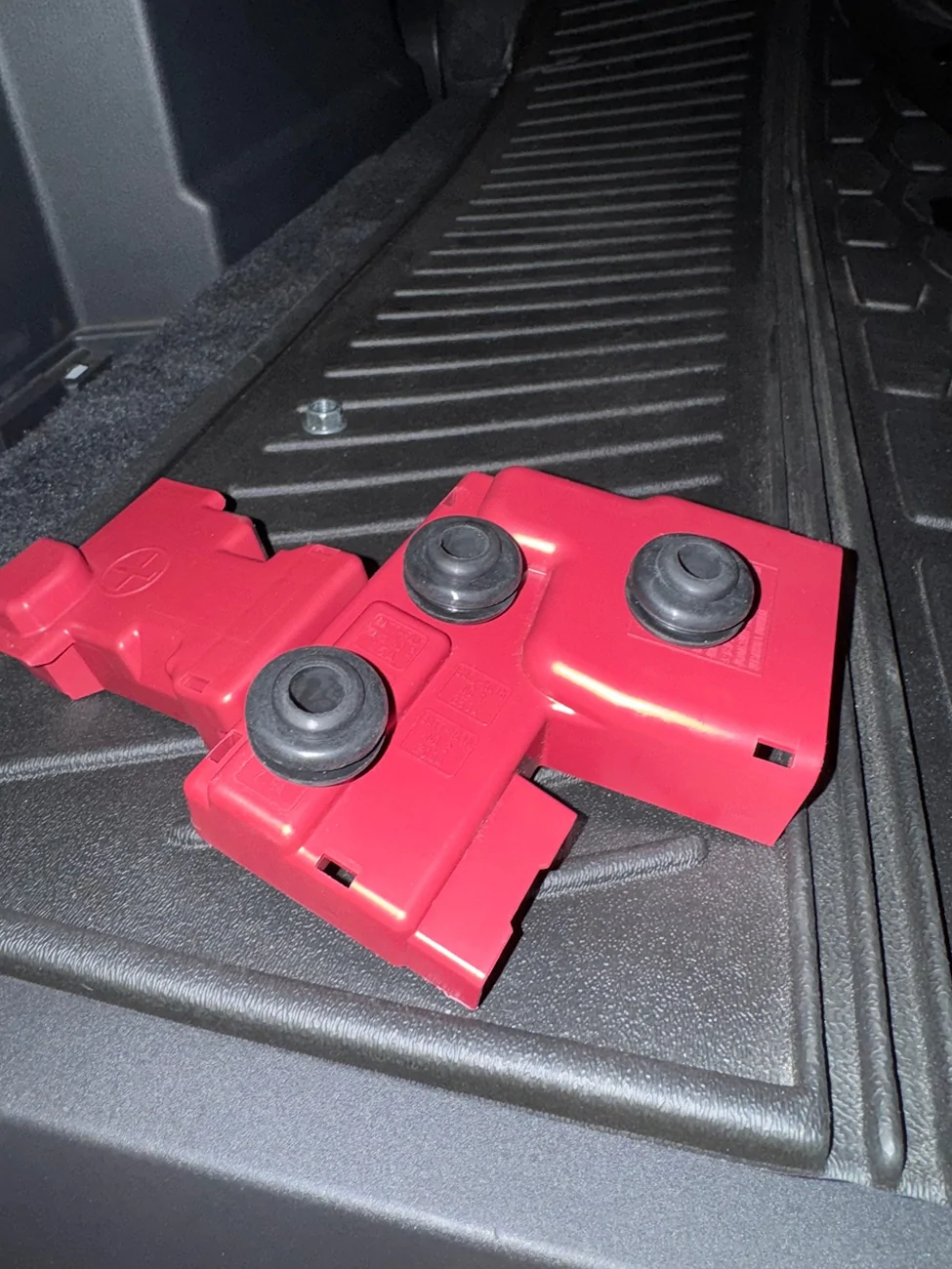

The OEM bracket has 4 points that attach to the vehicle.
1. Rear of the Battery (No Grommet or Spacer needed)
2. Front of the battery (1/2 inch robber spacer / grommet installed with isolator in the centre)
3. Left of the battery (1/2 inch robber spacer / grommet installed with isolator in the centre)
4. Right of the battery (1/2 inch robber spacer / grommet installed with isolator in the centre)
Images to be loaded shortly.....
(Below) Alberta Lithium Battery: Front Image SKU: 00055

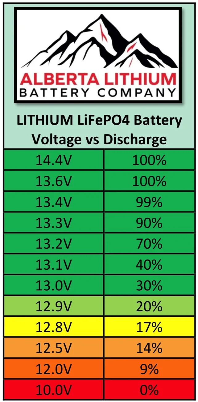

(Below) Alberta Lithium Battery: Voltage vS % Examples
2025 2026 4runner 6th gen Stormtrooper by Van-Solo 4R (TRD Off Road Hybrid) 132100a.jpg
