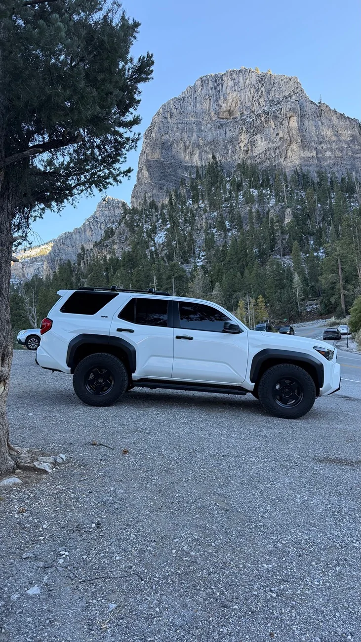

Here is my 2025 4Runner SR5! First ever car I bought new and no regrets so far. Came from the Subaru STI platform and was getting tired of scraping on speed bumps and the excessive oil burn lol. Only a month with the car and couldn't keep it stock.
Ceramic Tint
5 Front/15 Rear
SCS F5 Matte Jet Black
17x8.5 +20 offset wheels (6x139.7)
Falken Wildpeak AT4W
285/7017 C1
Next mod I’m waiting for to come in are the CBI full skid plates
2025 4runner 6th gen My SR5 Build So Far: Wildpeak AT4W 285/70R17 C1 and 17x8.5 +20 offset wheels (no lift) 23960-ee65707ac0e51c378fce9e4605324e7
2025 4runner 6th gen My SR5 Build So Far: Wildpeak AT4W 285/70R17 C1 and 17x8.5 +20 offset wheels (no lift) 23961-05bec4c1cf650fcd906cb805b49d4362
2025 4runner 6th gen My SR5 Build So Far: Wildpeak AT4W 285/70R17 C1 and 17x8.5 +20 offset wheels (no lift) 23962-be17730ece55407365e9d0a96547e09f

It looks descent without a lift! Great job so far! LOVE the white! Your 40mm increase in tire height and the +20 offset wheels make a tremendous positive difference from stock, imo!!

Could you please post a view from the side? If so, thanks!

Great build. No rub on full turn.? planning to do the same with stock suspension

No rub at all with this set up, took the set up on a mild off road trail and no rubbing
Nice! Just the mudflaps off? What bout the metal bolt on crash can on the front?

With this exact setup the crash bar portion didn’t have to be removed
Nice thanks!! The rims I'm planning to get is the same spec but just +18 offset. I think that should not be a problem. Hopefully 🤞

Thanks so much for posting the side view! Its a beaut!

Looks great I did the same tires. Just wondering did you notice the ride change? Mine is super stiff now. Love the look but bummed how crappy it rides
