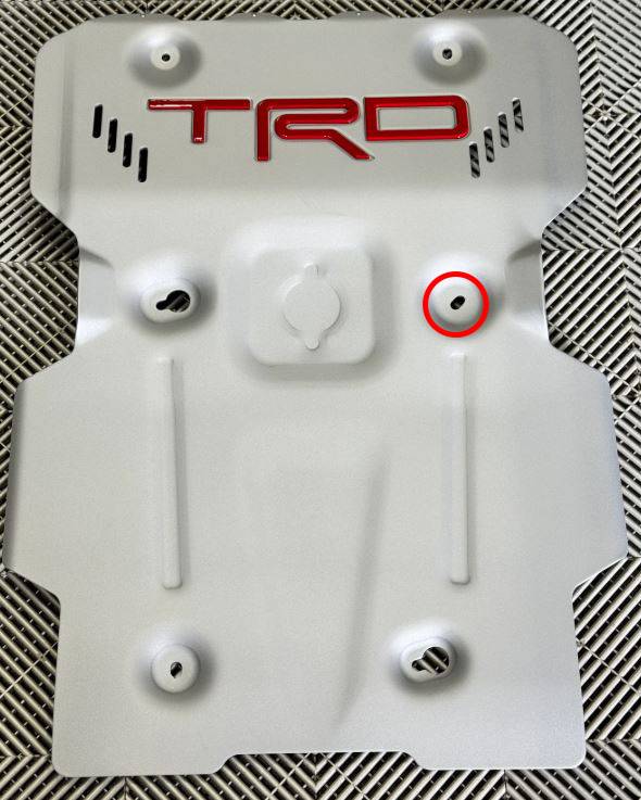

LC250 and 4Runner are exactly the same underneath. The Tacoma has a slightly different hole location (indicated with red circle in the picture below), about less than 1 inch apart from the corresponding hole on the LC250/4Runner.
This 45° angled slot on the OEM TRD Pro skid plate is what allows it to fit on both platforms.

Thanks for the clarification. It looks like this one uses different middle holes altogether?
