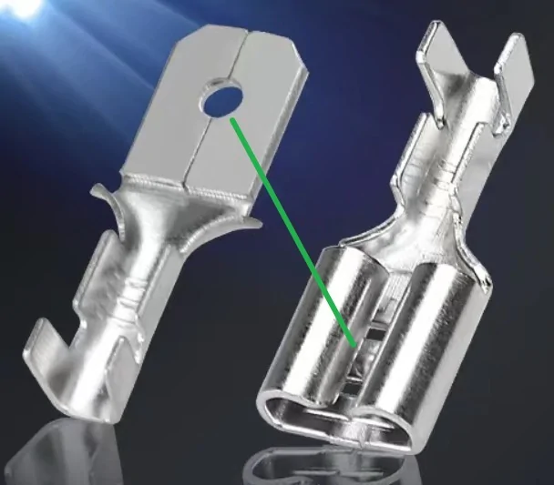

Spade type connectors often have a detent & ball feature to keep them from easily sliding off. This can require quite a bit of wiggle force to pop it loose.

I finally got the aftermarket mirrors installed. I broke one spade in the OEM passenger mirror. Took a pair of pliers and a lot of wiggling to get the spade out of the connector. The drivers side (I did it second) was no problem. I did a little gentle wiggling and it came apart easily.
