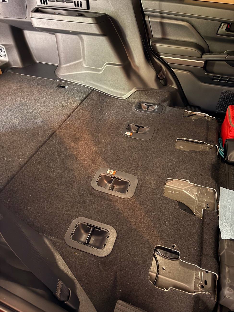

Got a pic how it looks like after the seat was removed completely?

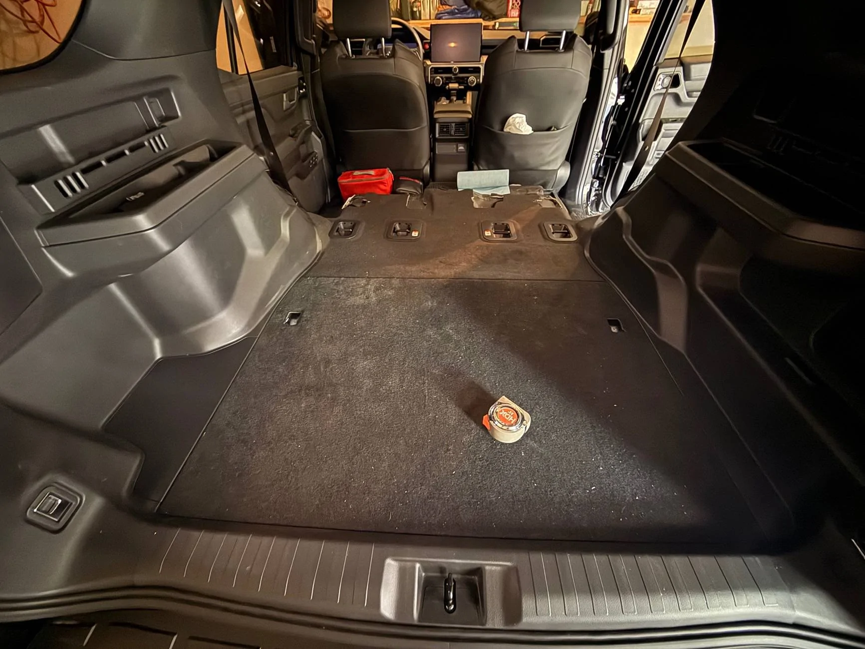

I’m in the process of building drawers. Here’s how it looks after seat removal.
The power lift gate continues to throw a curve ball. In the event of a jam, there is an access panel inside the rear hatch right where the drawers will be positioned in my build. I had to redesign everything so the drawers are narrow enough to allow a 5” center channel for storage and future emergency access to that panel in the event of a rear door that won’t open.

@timelapse Thanks for the pics! It looks almost completely flat with the seat removed. I think I will at least remove the single seat on mine to make room for sleeping.

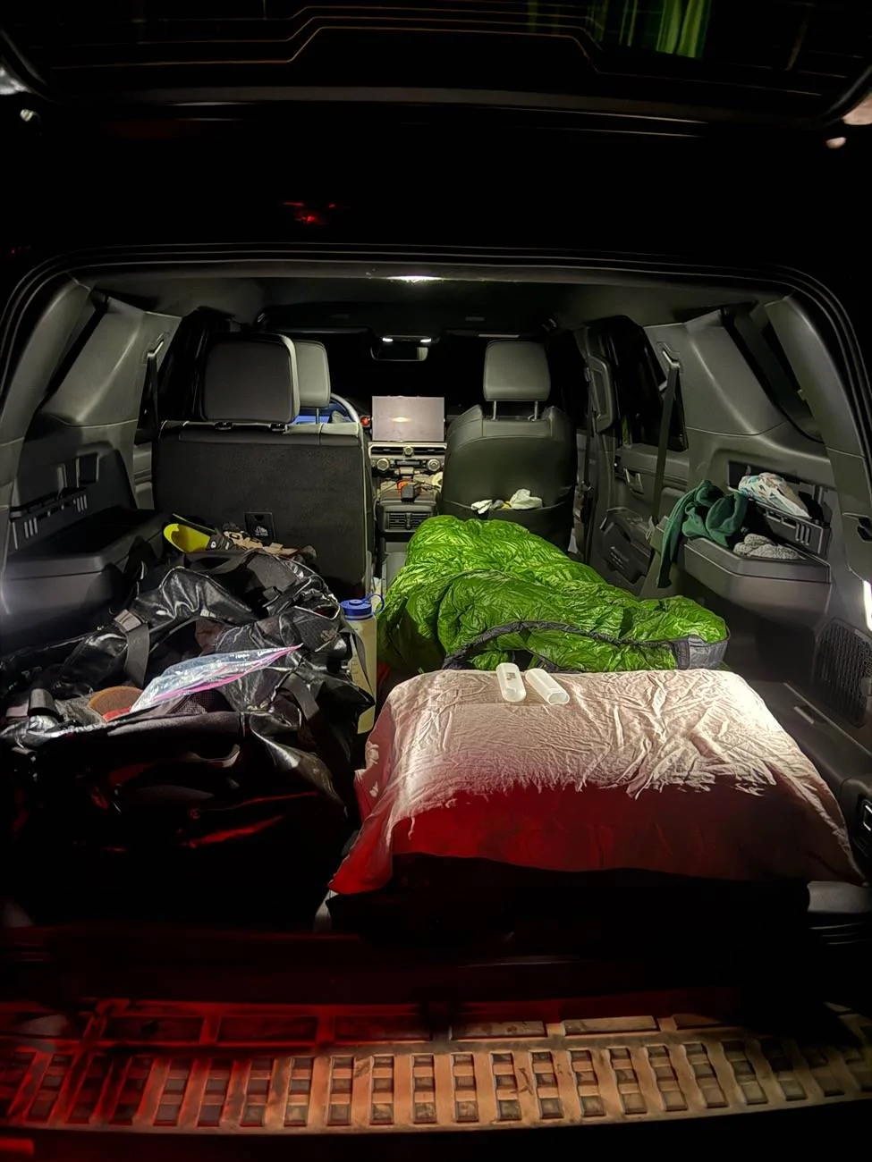

I started with a single rear seat. You do need to cut a basic extension out of some 3/4” sandie ply or birch to flatten out the subtle dip where the seats had been.
Works great for me at 6’ 4” (with passenger seat all the way forward).
Still waiting on my ORP.. can you provide approx. dimensions of the space after seat removal.
Thanks
