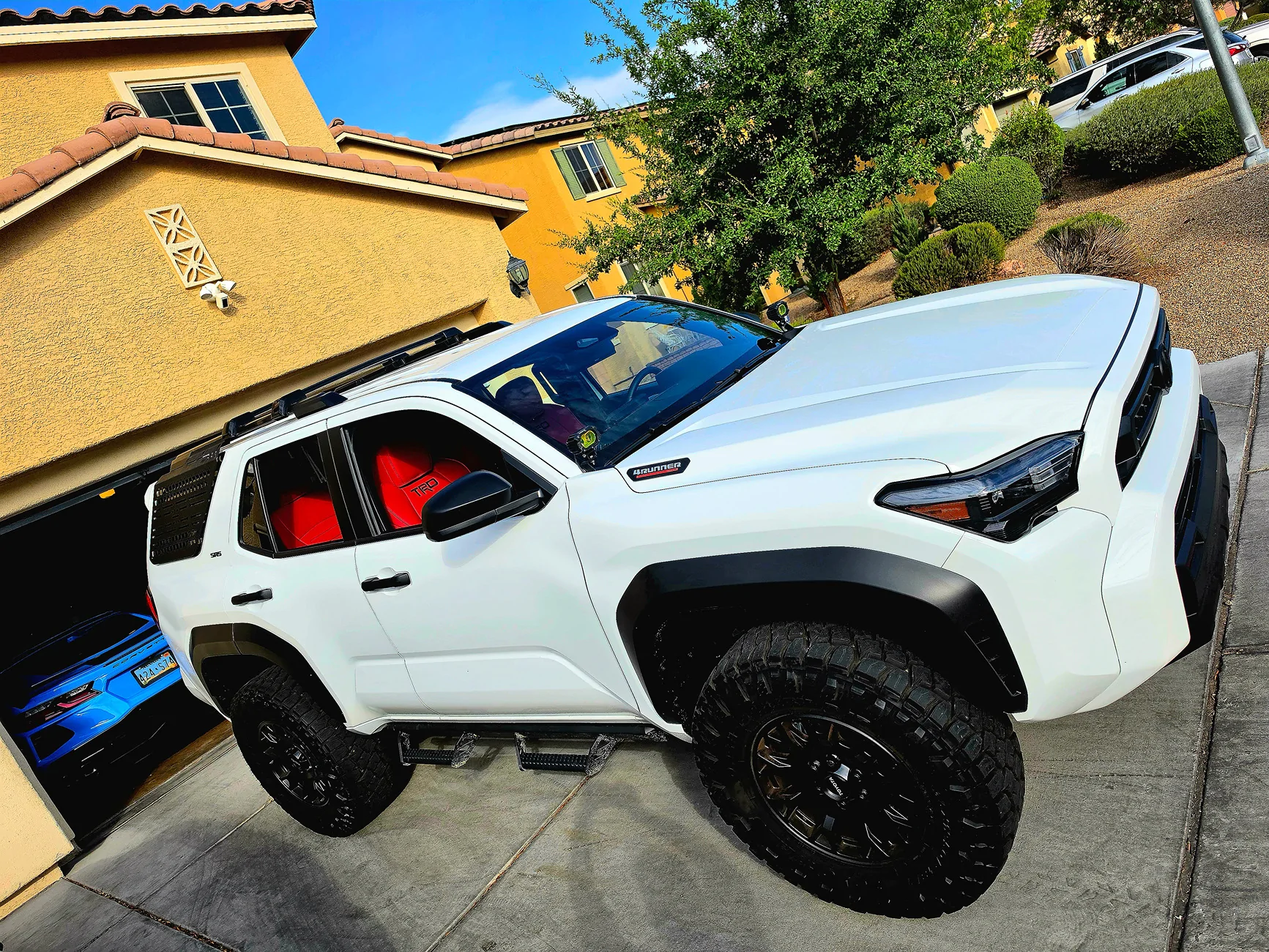

I did mine in 2 hours without removing the seats. Your hands and fingers will hate you for a few days after but so worth it.
