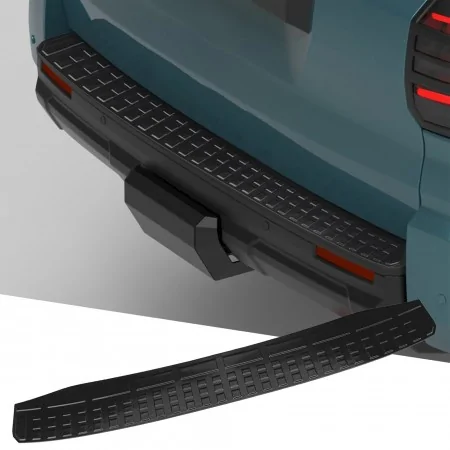

Does anyone know the steps to remove the rear bumper?
I'm trying to replace this piece and I assume that the rear bumper needs to be removed to do so:

I actually figured it out in case someone else was wondering...
You just pull straight up on the edge of it. Held in only by a row of clips in the front and back section. Really easy to remove.
