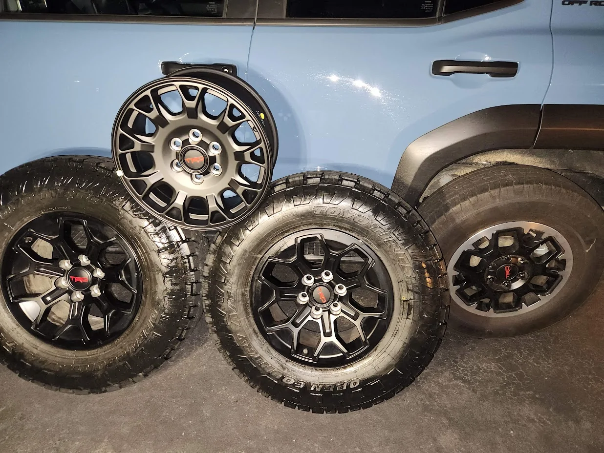

The stock tires for these 4 trims are different brands but same size: 265/70R18. The stock wheels have different offsets: (ref: factory-wheels-tires-oem-offsets-bore-sizes-widths-brands-2025-4runner-6th-gen.)
TRD Off-road: +55
TRD off-road flat black (option): +45
TRD PRO (Black): +20
Trailhunter: +20
I'm contemplating putting 285s on my TRD ORP, using the +45 offset wheels (since I'd like to avoid changes from stock (except tire size)). And I'm trying to figure out whether all those references to putting 285s on TRD PRO without lift or rubbing will be true for the TRD Off-road trims.

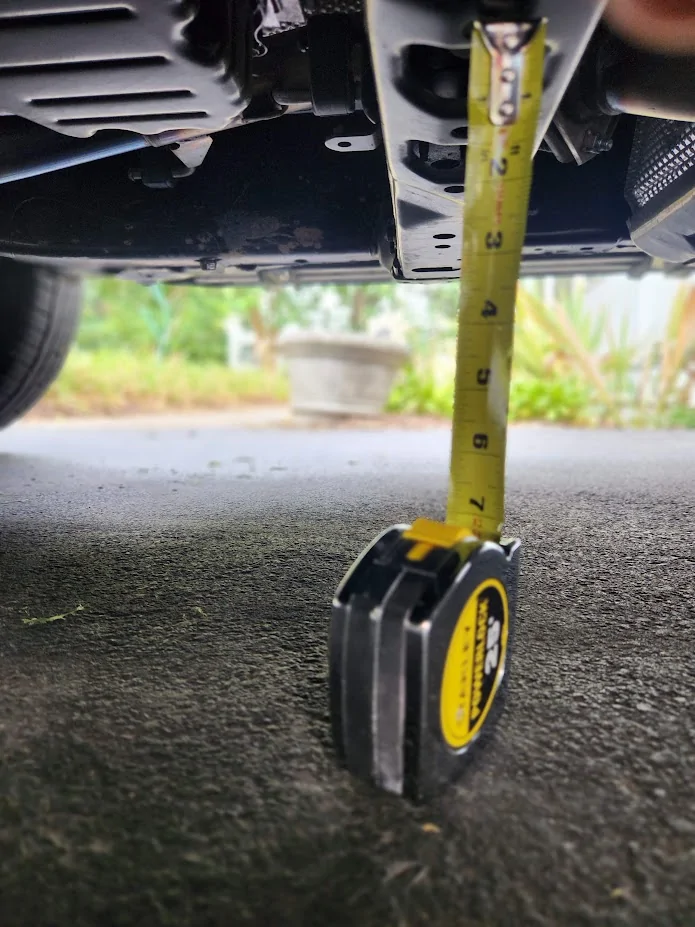

Ground Clearance:
OFR:: 9.1"
PRO/TH:: 10.1 "
I'm looking to better understand exactly how the PRO and TH get that extra .4" of overall height and 1" of ground clearance vs. the OFR trims AND how to reconcile those two differences. (I.e., I'd like to understand how both measurements can be true?)
I know the PRO has FOX QS3 shocks and the TH has Old Man Emos.
What is the "low point" where clearance is measured? Assumedly the suspended height is .4" higher from effectively longer springs/shocks but not sure if the clearance is to a frame location (or differential?) and where does that extra .6" come from?
