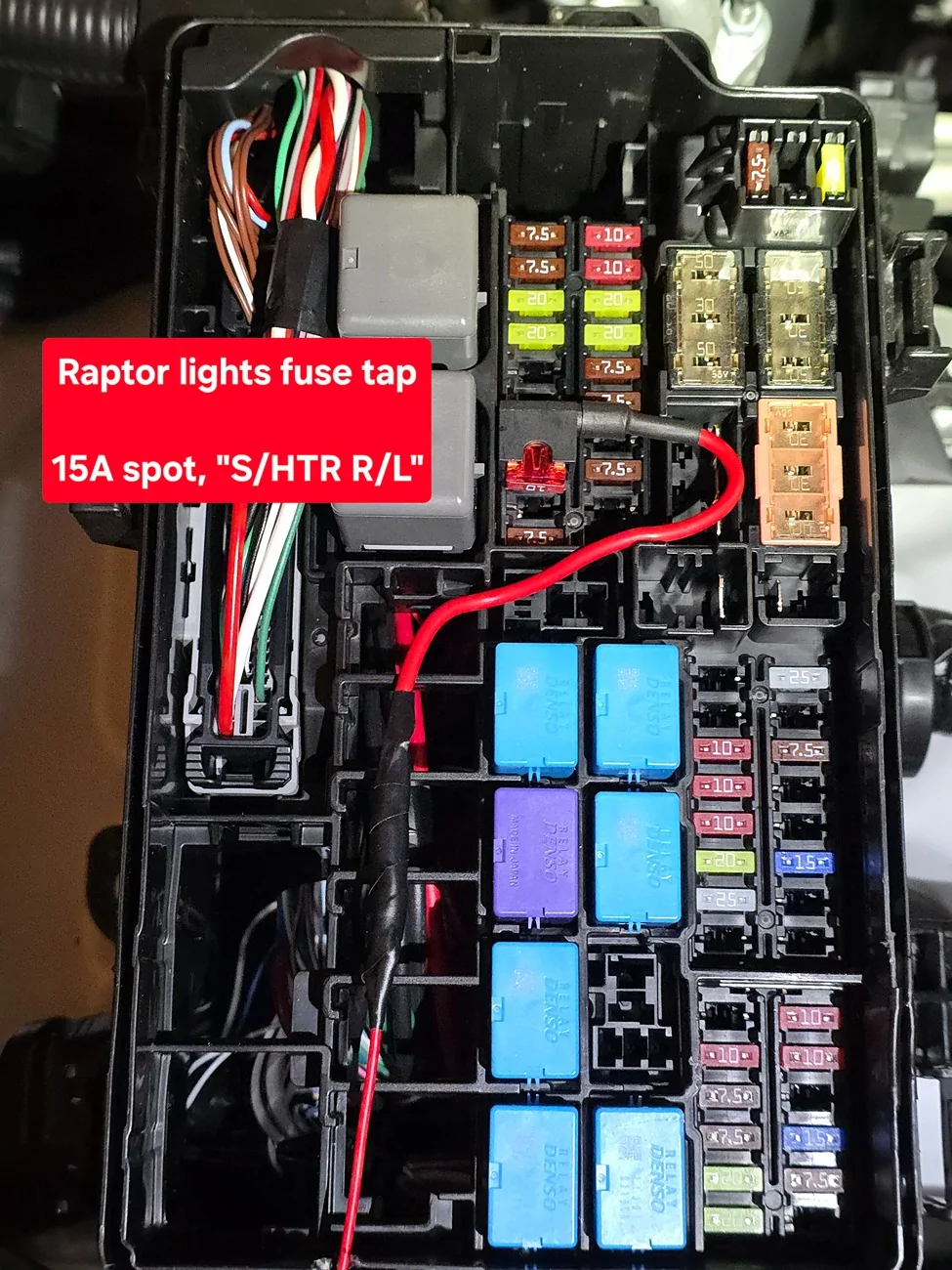

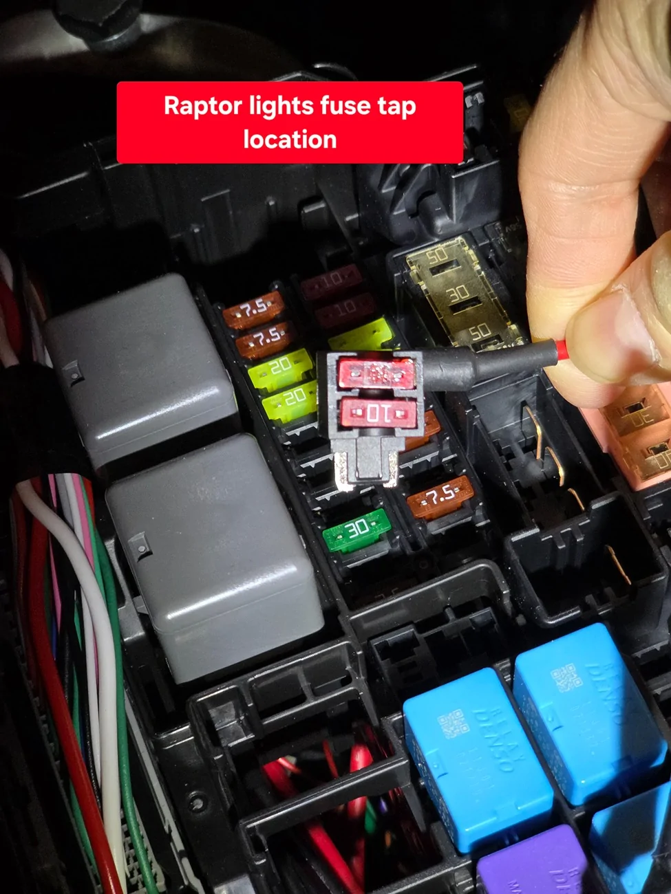

Hey OP, I found another fuse that you can tap into to fix the random turn on issue for the raptor lights. This was suggested from my certified mechanic friend. I tried & confirmed it's working!
You can use the same included 10A fuse.
“S/HTR R/L" 10A fuse refers to the seat heater circuit for the rear left seat. “S/HTR” is short for seat heater, and “R/L” means rear left. This feature is only on Platinum trim. It was blank in my car.

i forgot to say thank you. you are a saint
