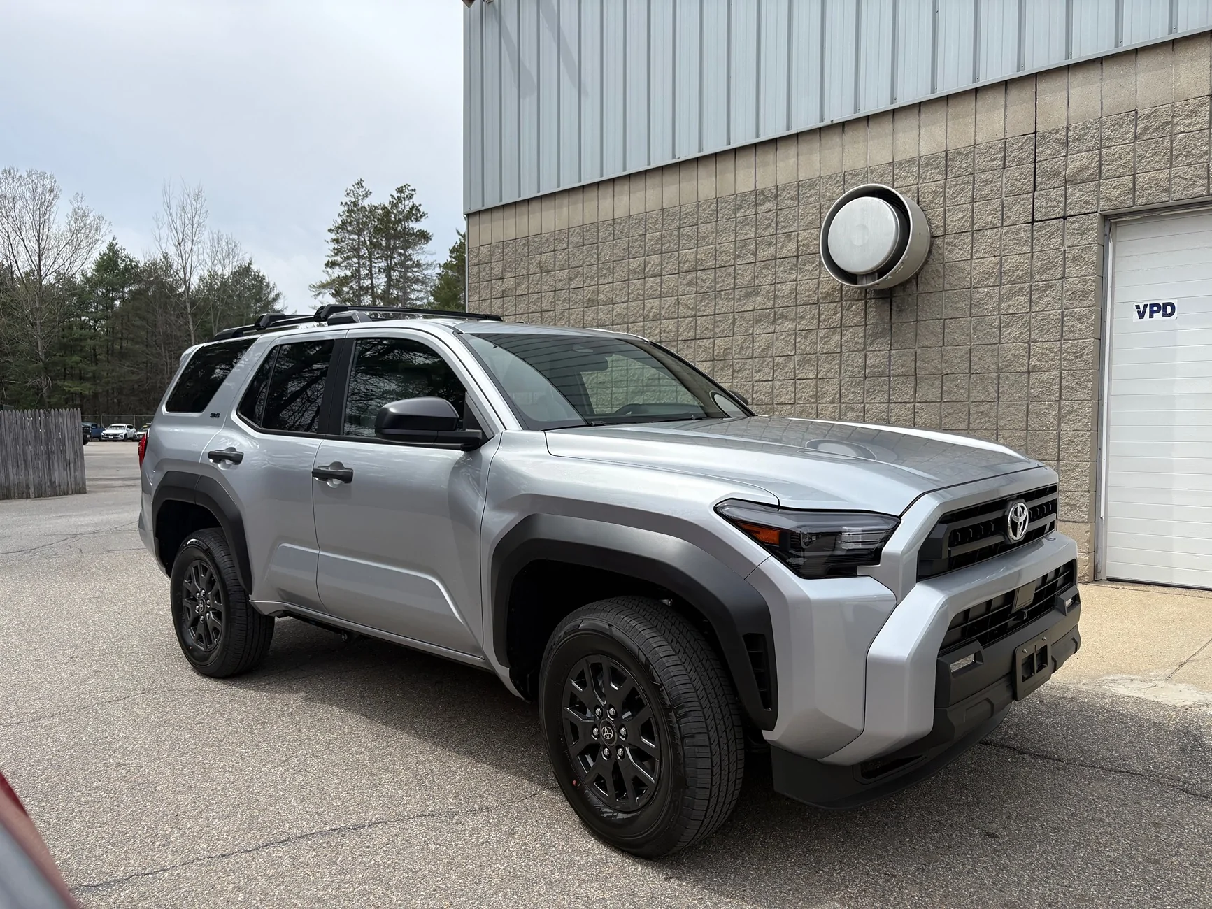

I wanted to share what I'm putting together on my Cutting Edge, 2026 4Runner SR5 (i-FORCE 2.4L, 4WD, Third-row) and get some feedback on tire choice before I pull the trigger. Going for a clean, drivable truck with the narrow-and-tall "expedition" or "Power Wagon" aesthetic.
2025 2026 4runner 6th gen Power Wagon vibes on a 4Runner - 34"x10.5"R17 Toyo AT3 fitment question Bilstein 6112/6100 + Westcott rear pucks IMG_3684 2
2025 2026 4runner 6th gen Power Wagon vibes on a 4Runner - 34"x10.5"R17 Toyo AT3 fitment question Bilstein 6112/6100 + Westcott rear pucks back
Main use case is to drive on the beach to surf and bring my family to collect shells, play in the sand etc. Just picked up this SR5 around two weeks ago. And I've already been scheming by reading build post after build post trying to find a build that is close to what I'd like to do.

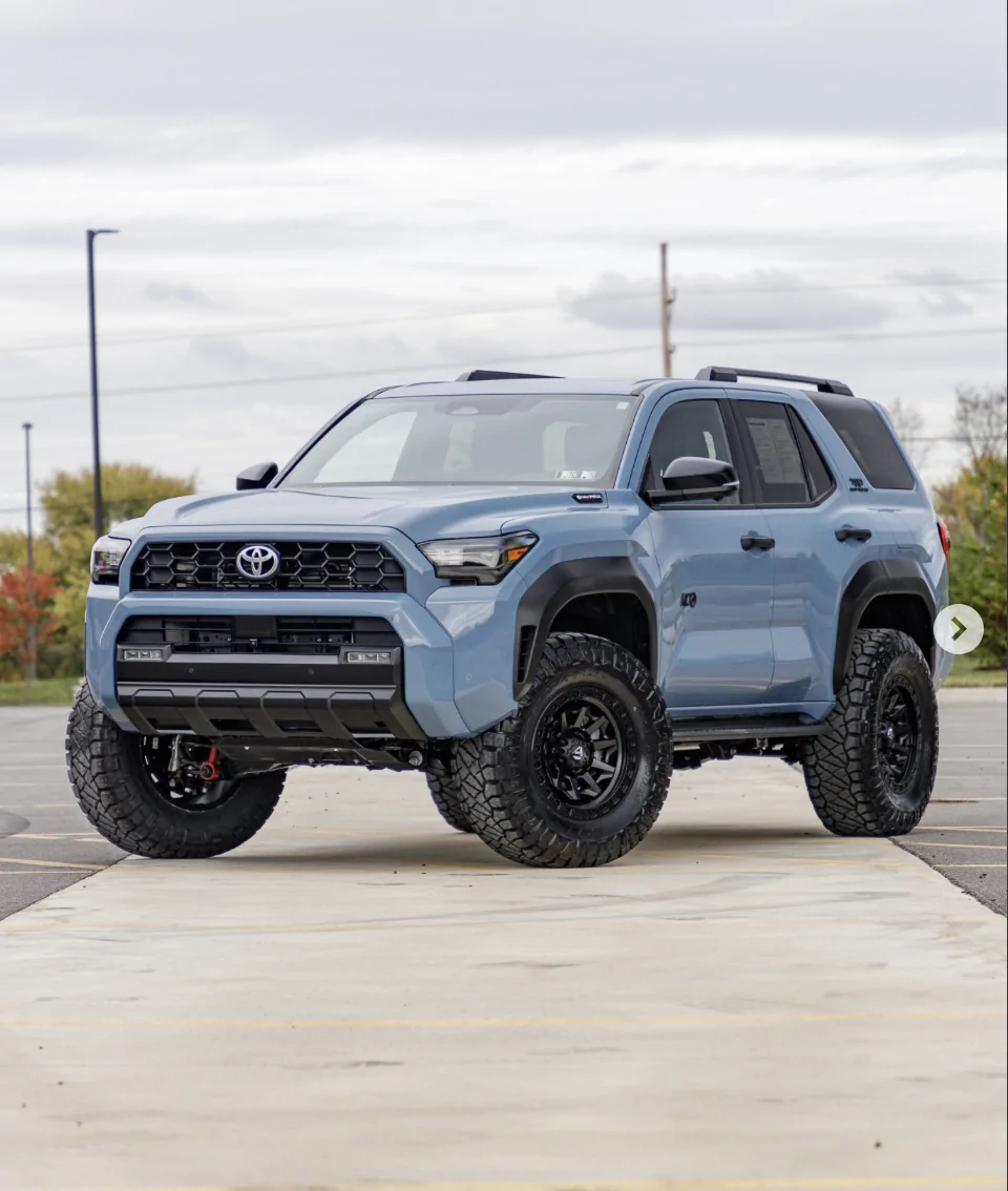

I've seen Haruharu's Heritage Blue ORP build with his 255/85R17 pizza cutters, and I think he mentions that there was only rubbing on the front mud flaps. Lucky for me I bought a stripped down SR5 without mudflaps so that is not an issue.

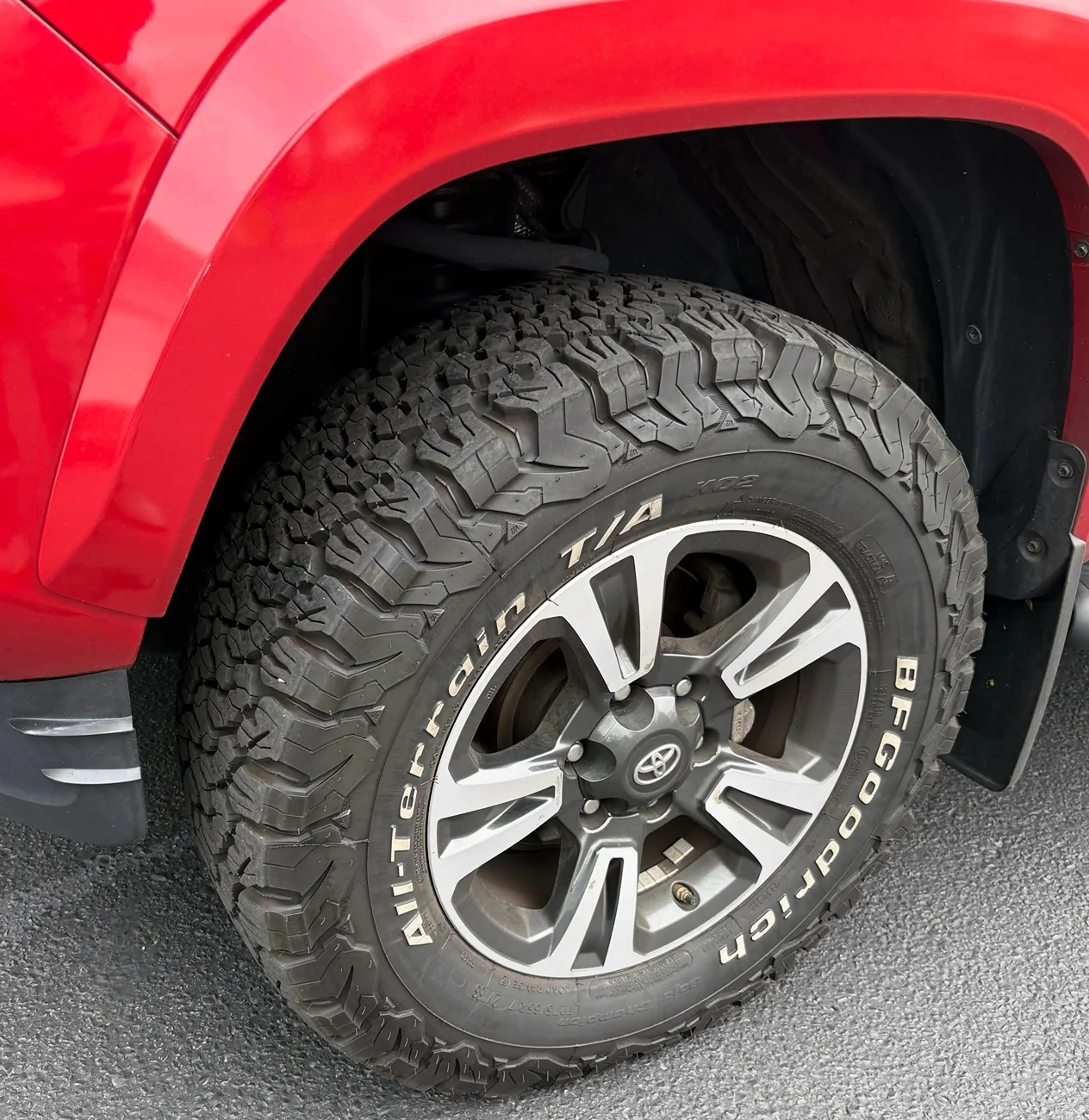

Additional context: Before getting this 4Runner to drive on the beach, I've been driving my dad's red 2019 TRD Sport with LT275/65R17 BFG K02s on the beach no problem (As long as I air down to between 20-18 psi and put it in 4H).
2025 2026 4runner 6th gen Power Wagon vibes on a 4Runner - 34"x10.5"R17 Toyo AT3 fitment question Bilstein 6112/6100 + Westcott rear pucks IMG_3718 2
That tire is only 10.8" wide and is an E load tire, and works fine, I do have to be cautious not to venture off into the super deep soft stuff but it works. So I'm not concerned about possibly running a 34"x10.5"R17, it has 8" of side wall that will deform plenty when aired down.

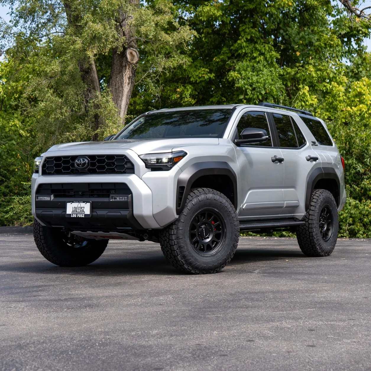

Here's a pic of a 6 gen 4Runner running 35"x11.5"R17 Toyo Open Country AT III
