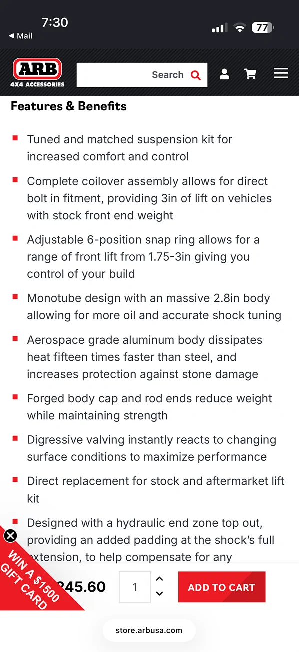

I don't see how I could lower the MT64s because the rear spring sets the rear height and they only offer the 2" lift option. I suppose it might be possible to substitute a different rear spring and then lower the front, but that would waste the cost of the OME rear springs in the kit. I'll have to give that some thought...
You’re right the rear is not adjustable. The front however I wouldn’t want 3” anyways because from the pics I’ve seen it give a negative fake look. So you could adjust the front, but ya won’t be factory ride height that’s for sure.

From what I can tell, the front is not adjustable with the current MT64 version. I don't see any slots in the images, and the person at Mudify said it's a fixed 3" front setting. Perhaps OME will release an adjustable version, but for now I don't think the MT64 will meet my needs. Too bad... On the other hand, I've been happy with my Bilsteins, so I can live that option if OME doesn't release anything adjustable before I buy my 6th-gen.
Third point mentions adjustable front. I did make sure it’s for the 6th gen.
