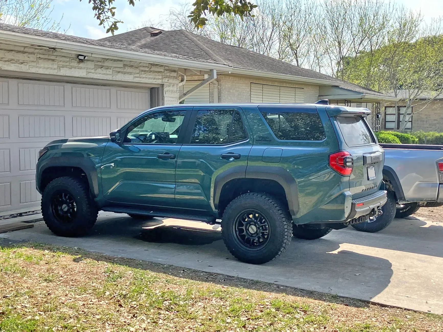

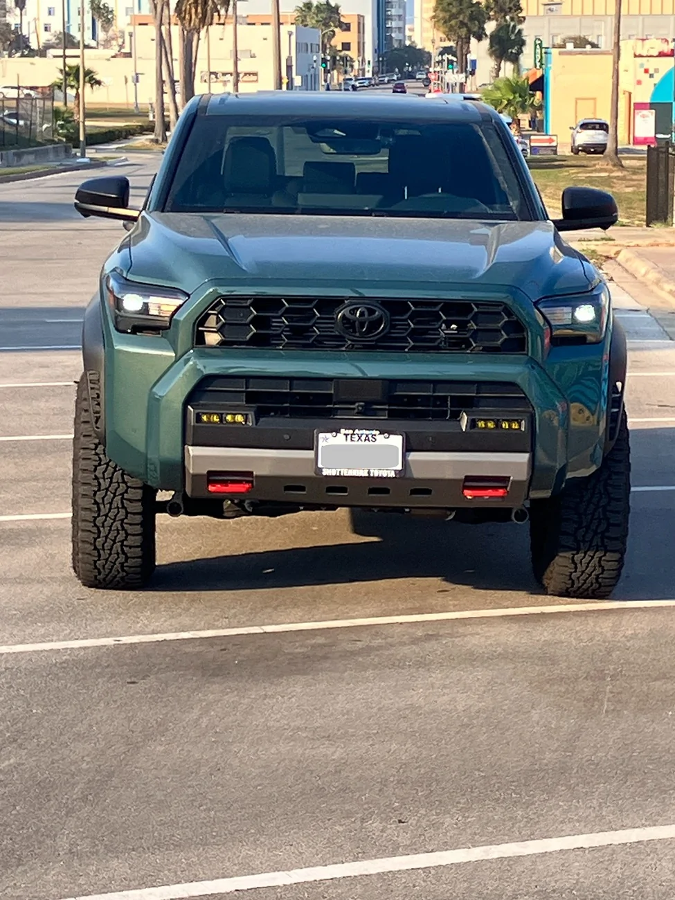

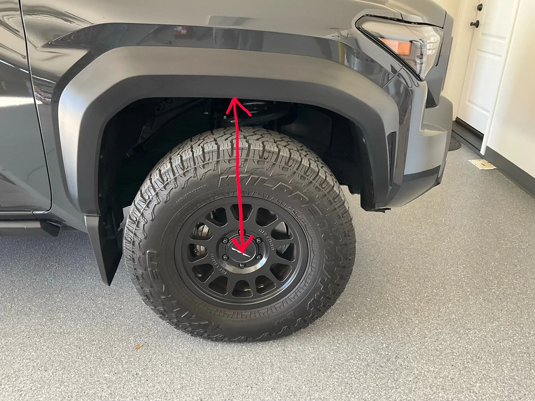

Had my OME MT64 lift installed today. Set the front at 2.25" and installed Dobinsons C59-885V rear springs. It has about half the rake than it did from the factory and rides smother than factory even with E rated tires...
This is a nice little mid lift that looks perfect on 275/70/18 tires while not going overboard. Super happy with this setup so far!
2025 4runner 6th gen OME MT64 lift kit installed (front set at 2.25") + Dobinsons C59-885V rear springs IMG_3496
2025 4runner 6th gen OME MT64 lift kit installed (front set at 2.25") + Dobinsons C59-885V rear springs IMG_3494222

@2012BAJA Looks like the perfect setup. I'm thinking the MT64s for my truck but maybe even setting them at their lowest setting. Good to know that there's a solid 1" rear spring option. Thanks for sharing!

What's the reason with the Robinson springs over the OME 3344?
Wanted a bit less lift than OME Springs which are set for the front set at 3" of lift. Those springs would make it look like a stink bug with the front set at 2.25". lol
I have no 3rd row seating in this truck so the rears sit at about 1.70" taller than factory on my truck. I think 1.75" on the front would be a little on the low side for these springs.

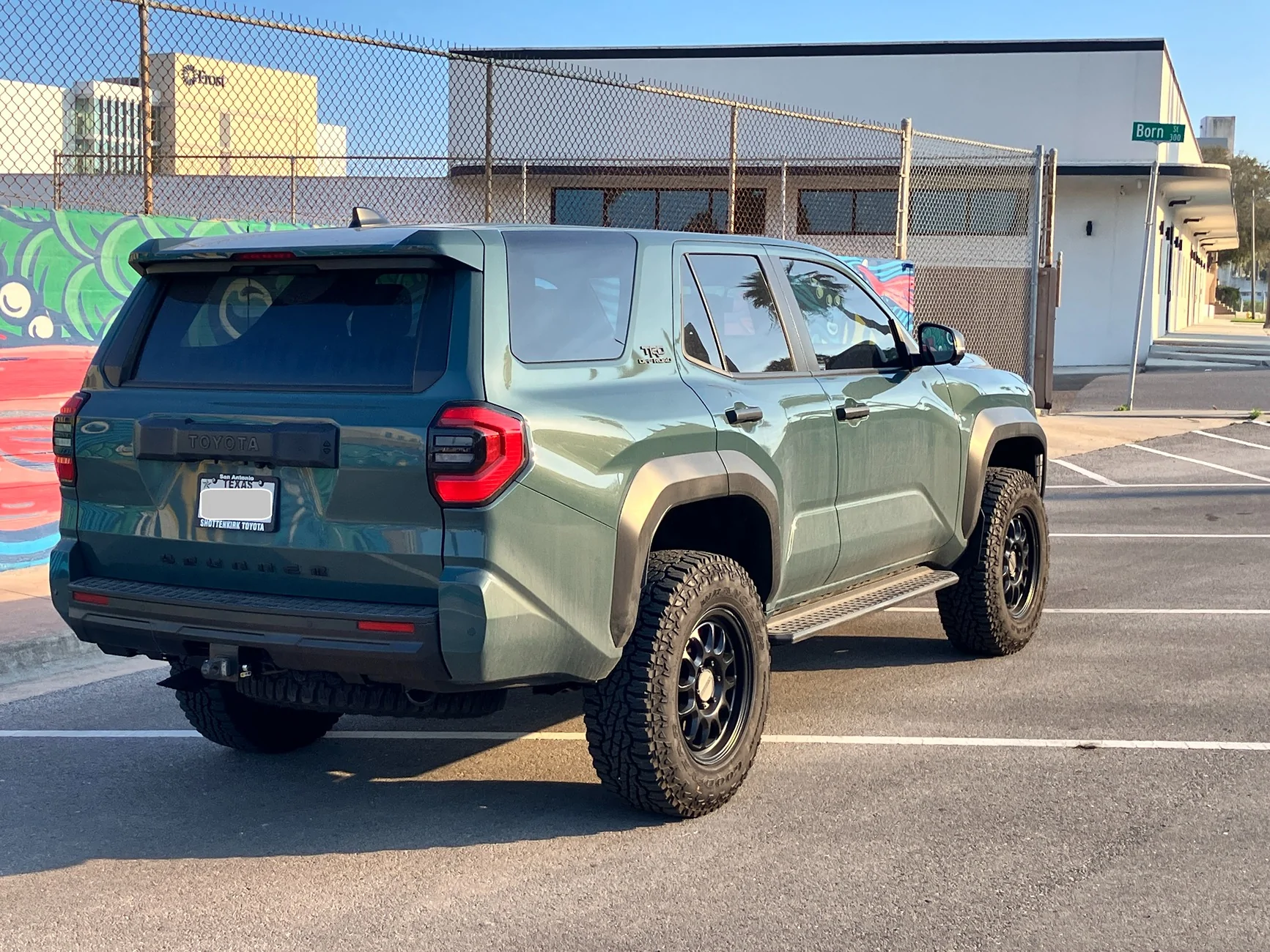

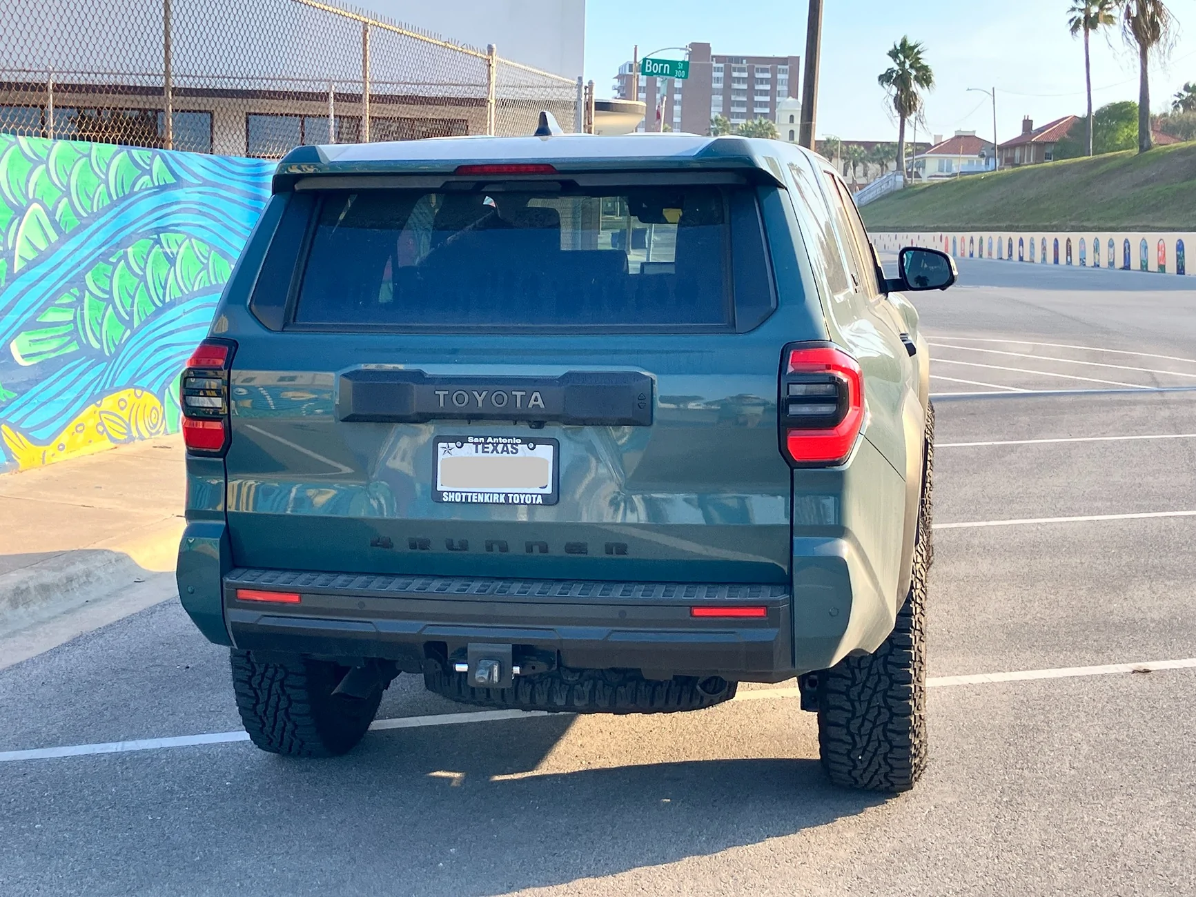

Few more pics of the truck below and some set up specs... NYTOP front Bumper with BD SAE fog lights. Word of wise on the fogs make sure they are at the same angle when assembled. Lay them on a flat surface face down and run a ruler between the driver and passenger side mounts to see if they are at the same angle. I also did a roof rack delete on it courtesy of SR5CampLife. For wheels and tires I went with Raceline Rogue's in 18X8.5 with Good Year 275/70/18 Ultra terrains. I like the fact that these wheels are a bit narrower which works well for this tire size. Last but not least I painted the NYTOP bumper in grey Steel-it along with the center section of the wheel center caps to match.. Any way loving this set up and honestly I do not miss my 5th gen with this motor and trans!
2025 4runner 6th gen OME MT64 lift kit installed (front set at 2.25") + Dobinsons C59-885V rear springs IMG_3523333333
2025 4runner 6th gen OME MT64 lift kit installed (front set at 2.25") + Dobinsons C59-885V rear springs IMG_3533222222
2025 4runner 6th gen OME MT64 lift kit installed (front set at 2.25") + Dobinsons C59-885V rear springs IMG_35299999999
2025 4runner 6th gen OME MT64 lift kit installed (front set at 2.25") + Dobinsons C59-885V rear springs IMG_35318888
