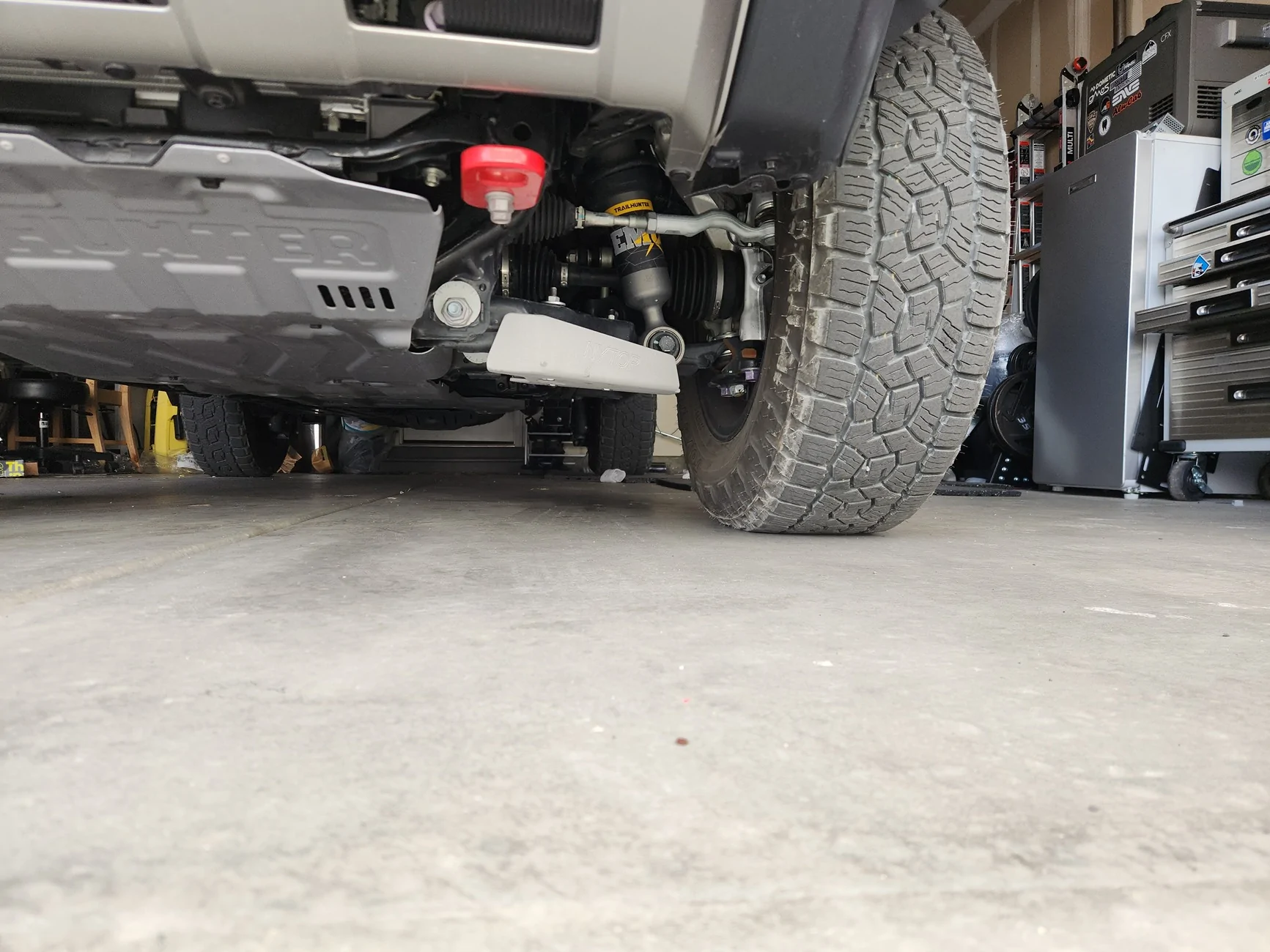

Installed the NYTOP skid plates for lower control arm, lower trailing arm and rear shock mount.
All went well, the only issue is passenger front trailing arm installing the trough bolt washer and nut as no room to get hands in-between the fuel tank skid and frame will need to revisit a cone wrench and superglue I think will work.
I was able to get to all of them on mine without jacking up the 4 runner.
I was eyeing those skids. Have any installed pics? Thx.
