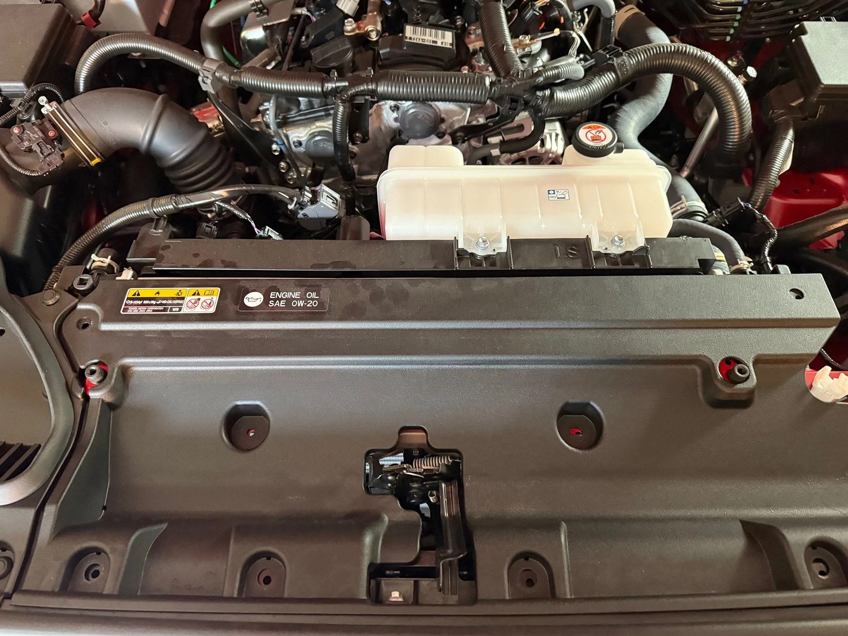

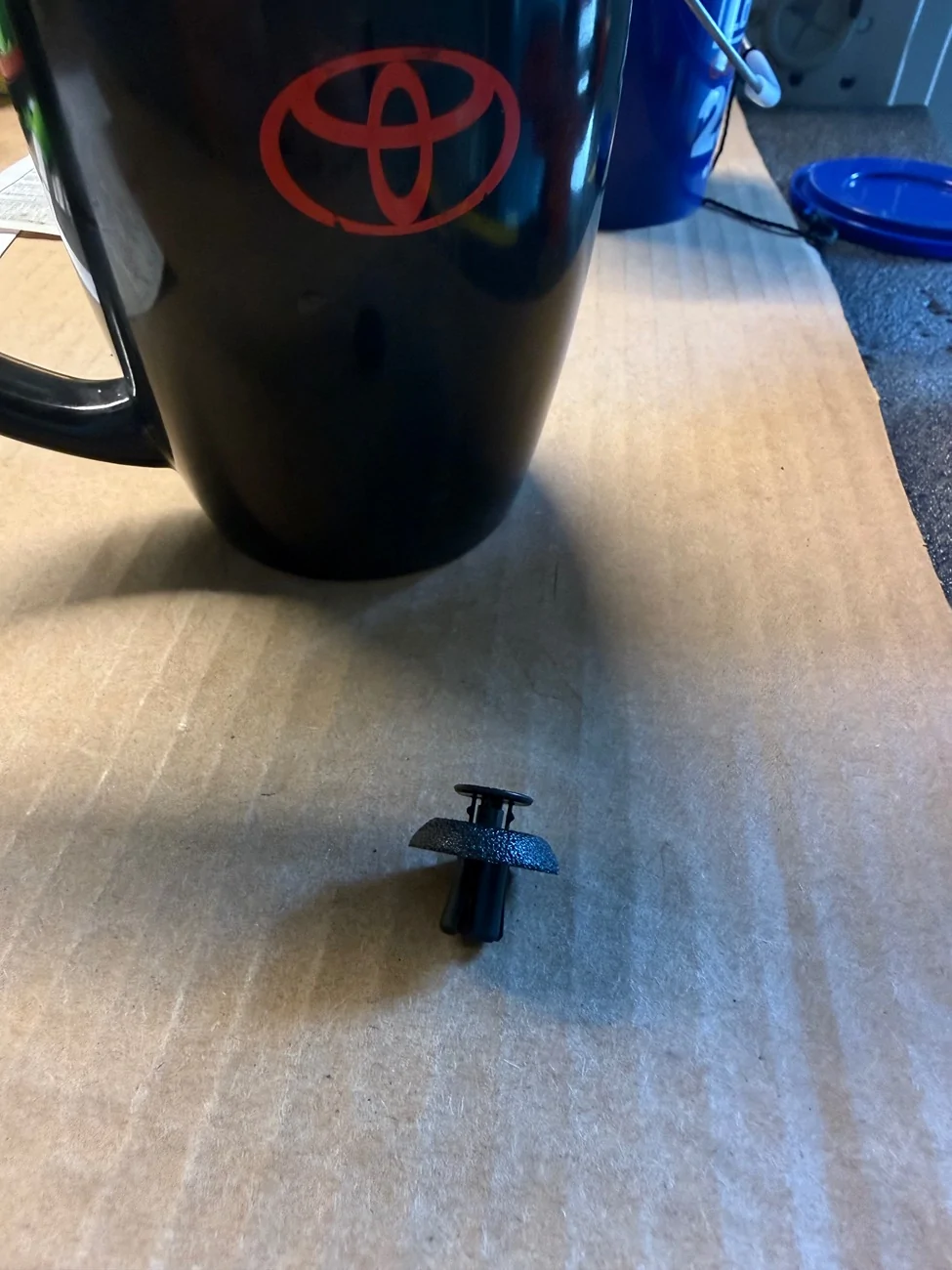

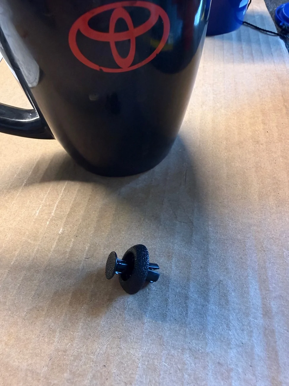

Replaced Horns, was Careful removing Fasteners, however, they will not snap in Securely.
2025 2026 4runner 6th gen Need part # for Radiator Cover Fasteners IMG_7119
2025 2026 4runner 6th gen Need part # for Radiator Cover Fasteners IMG_7118
2025 2026 4runner 6th gen Need part # for Radiator Cover Fasteners IMG_7117

If you push them too hard during reinstallation, they disengage again like they were when you removed them. You only push the center down to flush, otherwise you've pushed last the locking point to the removable state.

I pushed Beyond flush, you are correct, in pushed “downward” to remove them…
My mistake
My mistake
I only know because I made the same mistake.
