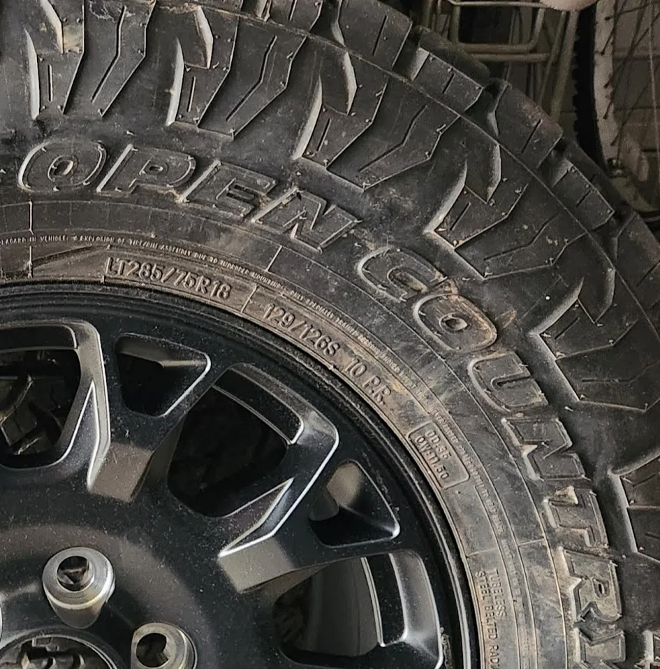

But you do not need a lift to run 34s. There are many examples on this forum (see Bigger Wheels, lift kits, etc. to start) of 34s (e.g., 285/70R18 - 33.7" typical) fitting without lift.
I'm running 285/75R18s (34.8") with just a 1.25" level kit and the crash bar removed and it clears with the front fender liner pushed in and air dam tab bent out of the way. (Offset MATTERS here.)

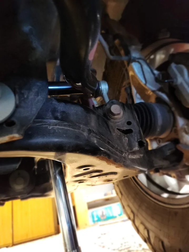

How big a deal is the front swaybar disconnect on the 4runner suspension? Its a rather large issue coming from a straight axel.
Good question. Getting the large (22mm I think) bolt broken free took some work with 10" of pipe beyond the end of my 1/2" Craftsman ratchet (which is about a foot long itself). Just barely enough room under the vehicle to get the leverage needed. Spec is 159 #-ft. And I think it was past that. See photo below.

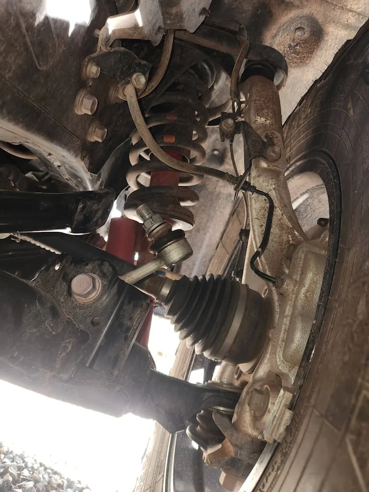

But after breaking it free and replacing it at 150 #-ft (the limit of my 2 foot long torque wrench), I was able to remove both connections in the field in <10 minutes. This shot is at the trailhead at an onX Black (7) trail where I wanted the additional articulation:
2025 2026 4runner 6th gen Switching from Jeep - what lift / parts to get? 20260418_093047
I was a little nervous leaving the link attached but it seemed that there was nothing for it to contact and I had no issue. But it was a pain and having a push button solution like I would have gotten with Trailhunter would be nice.
