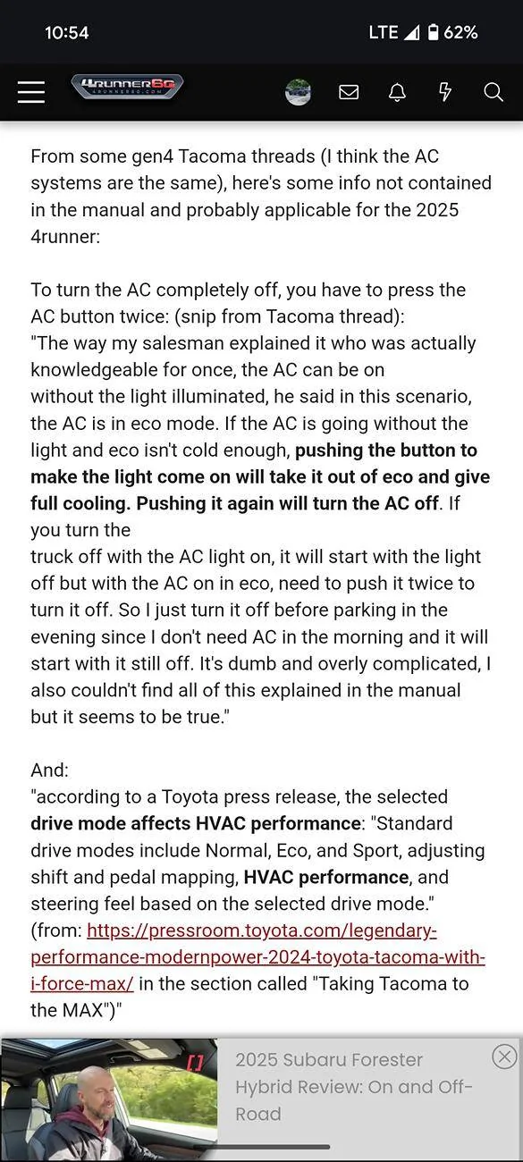

Apparently our AC runs in "eco" when we think it's off. I took this screenshot from a different thread but it probably explains the water spots even when you think your AC is off (it's actually not).
2025 2026 4runner 6th gen Mysterious drain tube Screenshot_20250603-105431
