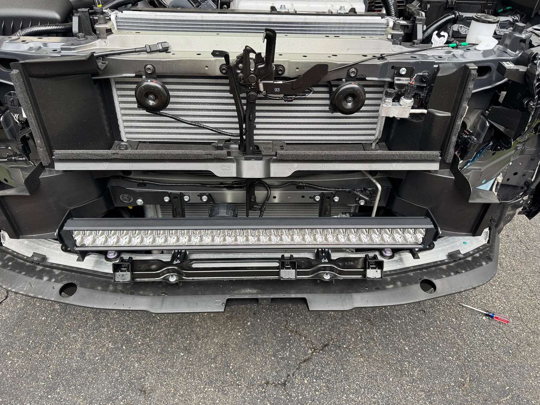

Apologies for the delays….life finds a way of interrupting upgrades. Have not yet fully installed the light bar, but was able to confirm my wiring using the factory option accessory power connected to the provided light bar wiring kit. Will post some pics of the install process once completed.

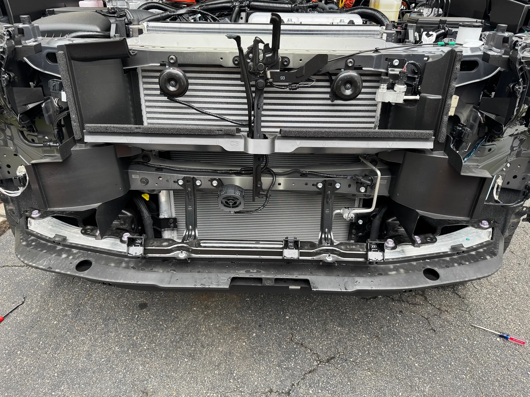

Based on my experience with the CaliRaised kit on my '16 Tacoma and what i'm seeing looking behind the grill and in the install video (below), there isn't going to be room to adjust after installation without removing at least the skid plate...more realistically the bumper.
As i did with my Taco, i'm going to point the bar level as possible and use a touch of blue loctite on the light bar mounting bolts. I had the prior kit on from 2017 until i sold the truck (June 2025) and it never moved. Hopefully this one will be the same.
Installation and front bumper removal for those looking:

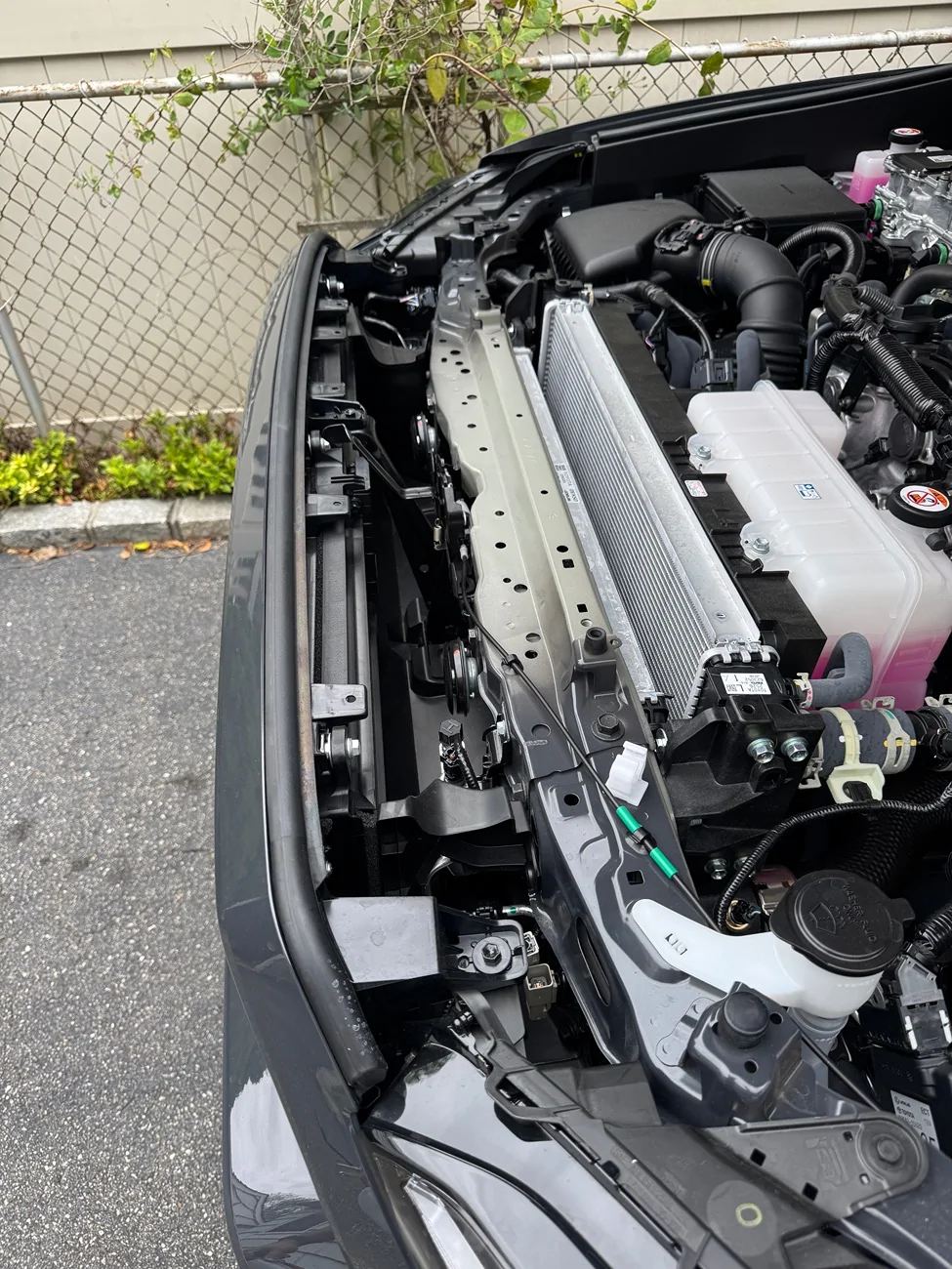

Bad news. After installing the light bar, i now have every check engine/sensor/system malfunction warning on the car going off. I went back and re-disconnected the battery for ~30 min and then the lift gate would no longer function.
Dropped the truck at toyota hoping its just a system reset and not a "we need to change ever sensor in the front of the truck"...
MErc0814
May 29, 2025
New York
2025 4Runner Off-Road, 2001 Miata
Good news! Toyota was able to clear almost all of the codes beside the front radar. The tech was able to determine that the connector was not completely seated. Irregardless, my $40 Amazon obd2 scanner would not have been able to clear the codes.
With that, the connectors that need to be disconnected when removing the front bumper are extremely temperamental and be sure to be very careful connecting/disconnecting.
The installation of the lightbar itself was super easy and wiring using the factory aux system with the provided pigtails was even easier. Will test the light more at night but I’m very happy now that the warning lights are off!
