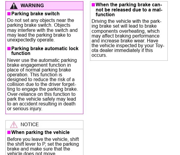

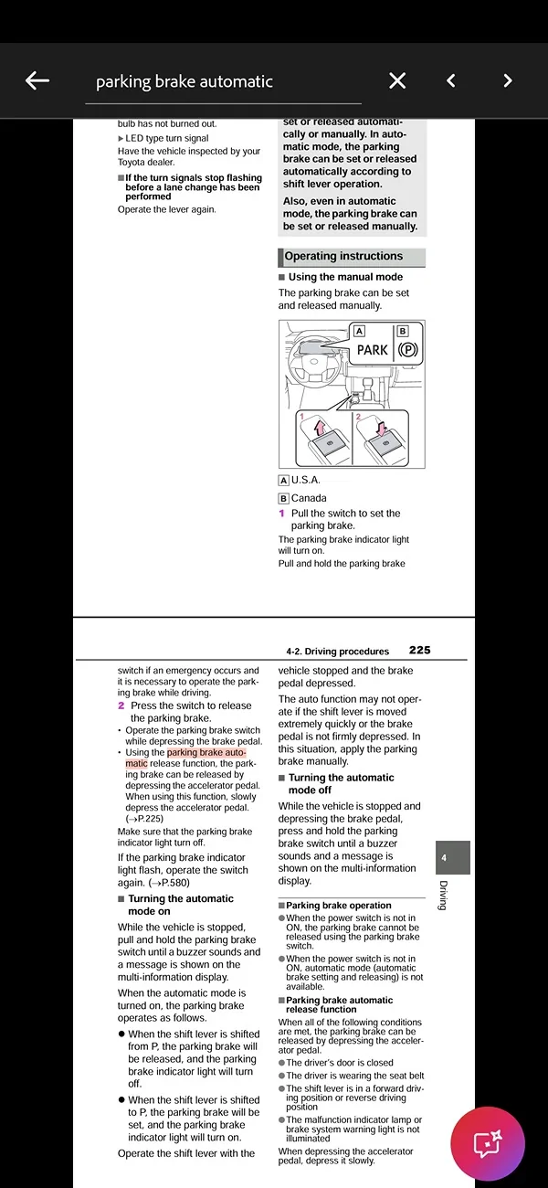

I use the auto parking brake. I know there is a button but why would you use that?
If I stop, hear the PB activate, what would pressing or pulling the switch do?
i guess if normal brakes fail, you can use to button carefully to slow the car???
very confusing statement in the manual shown above. Would like to know best practices.

The button exists because you can disable the automatic function and you still need to be able to operate the brake.
I agree. I used the switch to disable the automatic parking brake in the winter when snow and ice were building up for days without the temps getting above freezing to avoid issues. I could have manually used the switch to enable the brake if needed. After the weather improved, I re-enabled the auto parking brake to make sure it is being exercised and used as designed.
