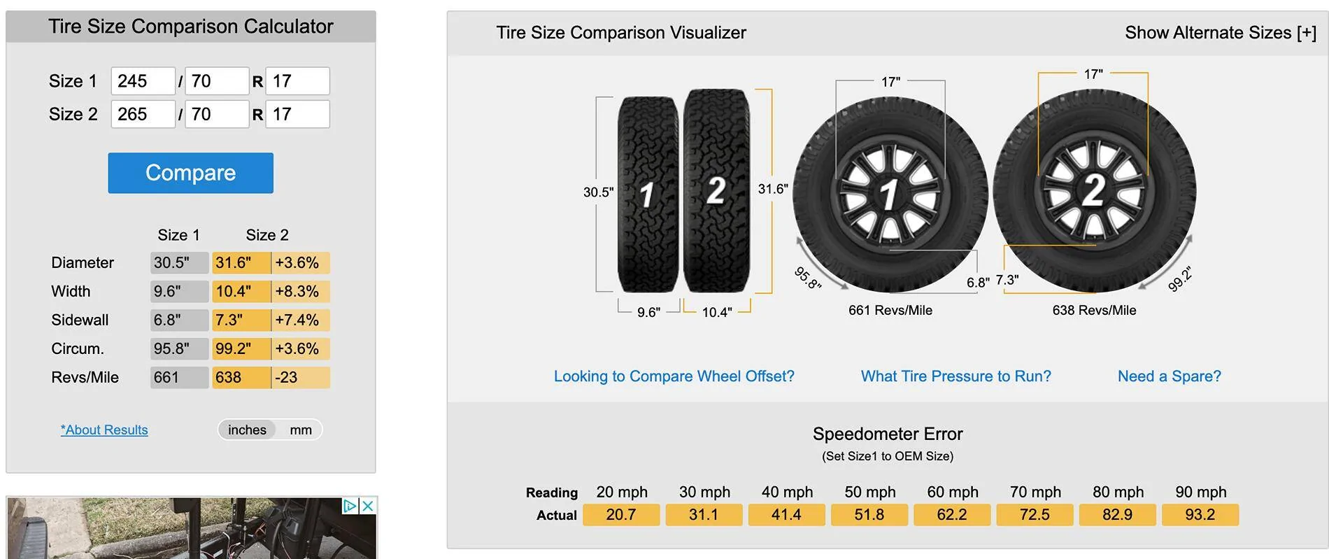

default = 245/70r17 my SR5 shows 65 mph when actual speed is 62-63 (many toyotas incl rav4
all have a 2mph average deviation in favor of you going slower for some reason)
default = despite the speedo being off, odometer is generous and on a measured mile
after 5 miles it under reports mileage by 1 tenth
I installed 265/70/r17's and now speedo is close to accurate and odo is even more generous
