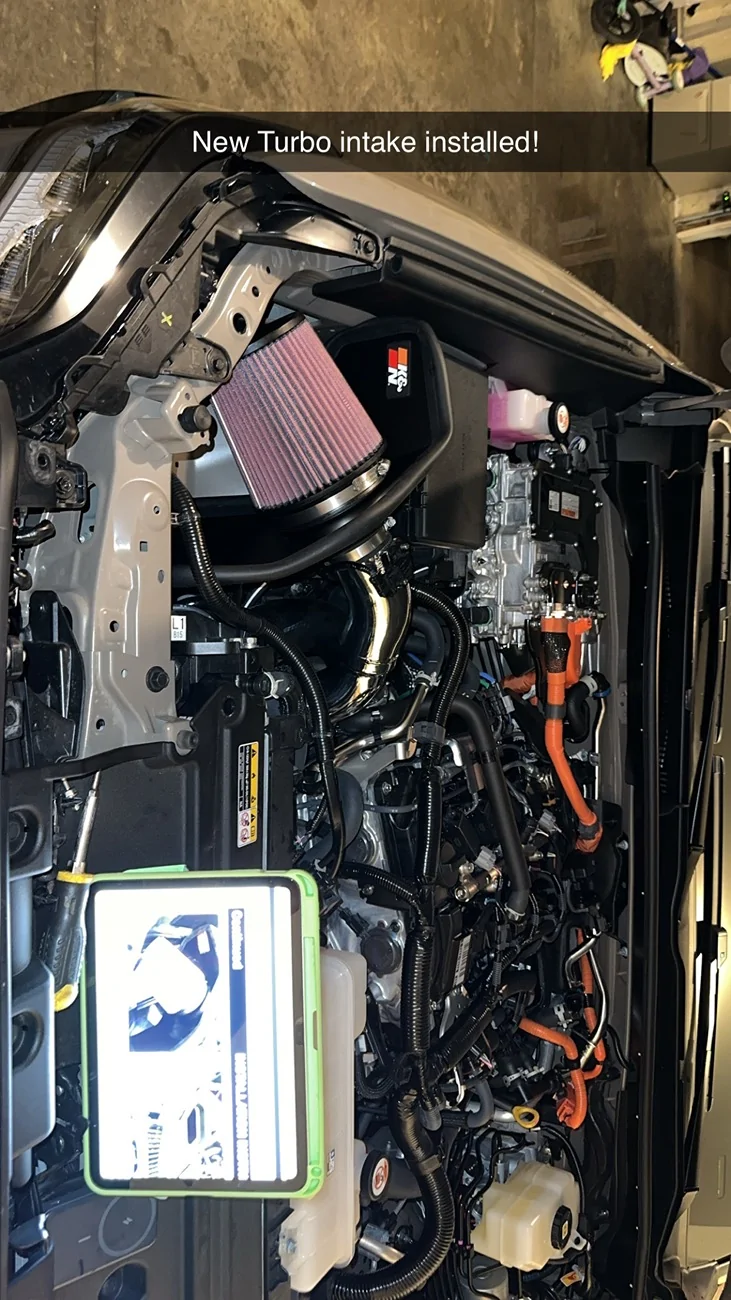

Long story short bought the K&N 77 intake installed on my TRD Pro thinking it was going to work which it do for a day sounded amazing then got the error message “reduce engine power.”
It was advertised to work on all models little did I know the TRD pro and the Trailhunters have different intakes and MAF setting then the other 10 models it works on that all have the same intakes.
I set up and appoint for OTT tune next week to turn the whole car and MAF sensor for the right airflow on the new intake. 2 questions is the is the OTT tune worth it ( looking at reviews it is) and second one will this tune or intake void my warranty.
I really want to do this cause I love the sound just don’t want to void anything on my brand new 4Runner…
