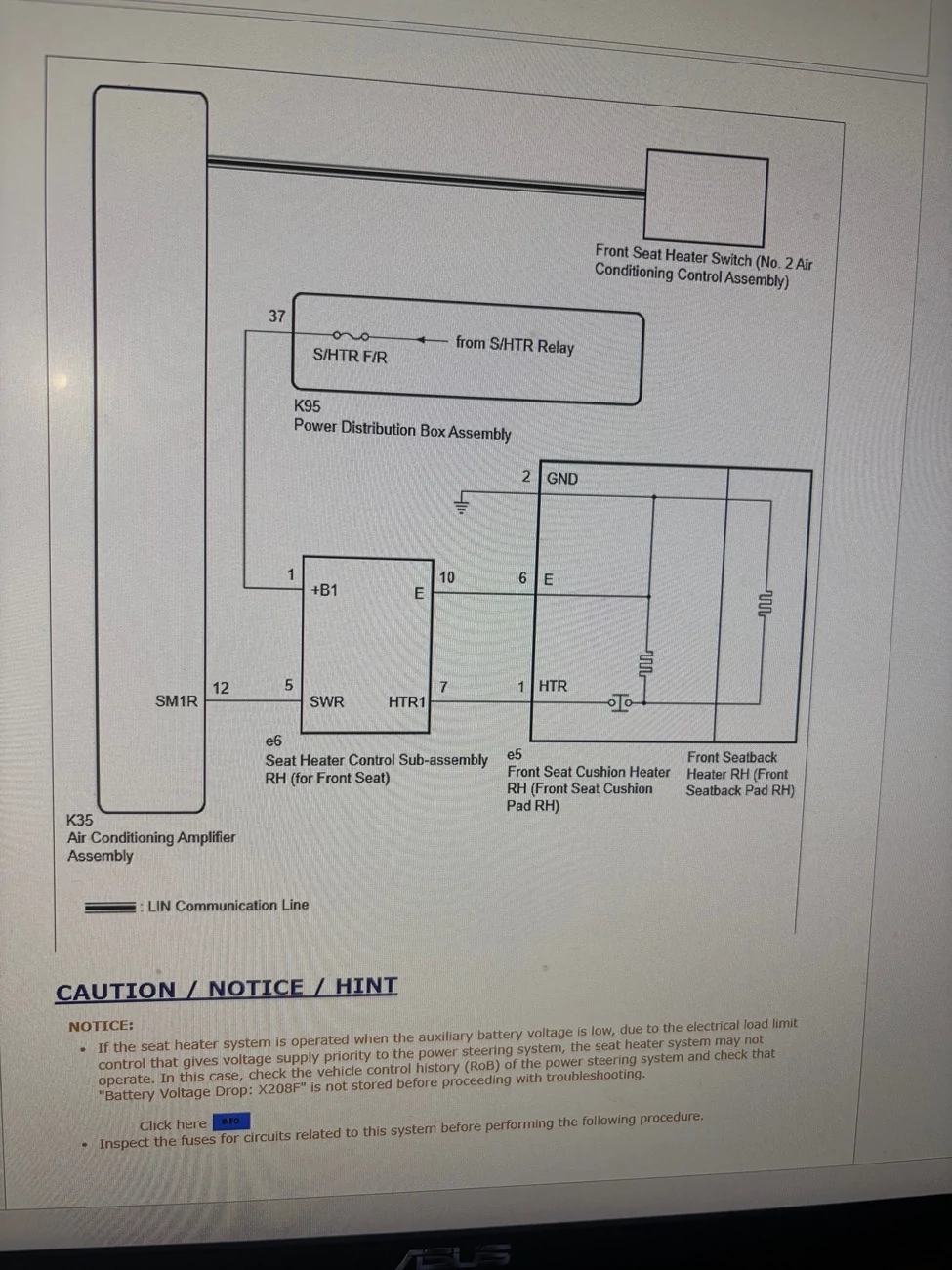

Hello All - I’m a new 4Runner owner and am looking to retrofit OEM heated seats rather than installing an aftermarket solution. I’ve subscribed to Toyota TIS and have been reviewing the factory wiring diagrams and system operation for the heated seats. Based on my research, this retrofit should be feasible, as the SR5 trim includes heated seats as standard equipment on Canadian-market vehicles.
The main point where I’m running into uncertainty is whether the A/C Amplifier Assembly needs to be replaced. I have not been able to find any explicit reference in the repair manual indicating that a different A/C Amplifier is required solely to add heated seats. No other HVAC changes are planned—the vehicle will remain single-zone, non-automatic climate control (no auto or dual-zone functionality).
From what I can see, the heated seat switch inputs route through the A/C Amplifier Assembly via the No. 2 A/C Control Assembly. Can anyone confirm whether the existing A/C Amplifier supports these inputs, or if a different A/C Amplifier Assembly is required for proper OEM heated seat operation?

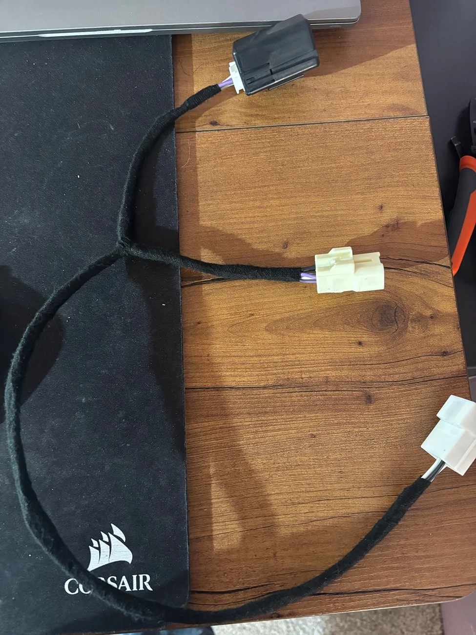

- Made my own seat harnesses with factory connectors/terminals and wired up the Heated Seat sub assemblies

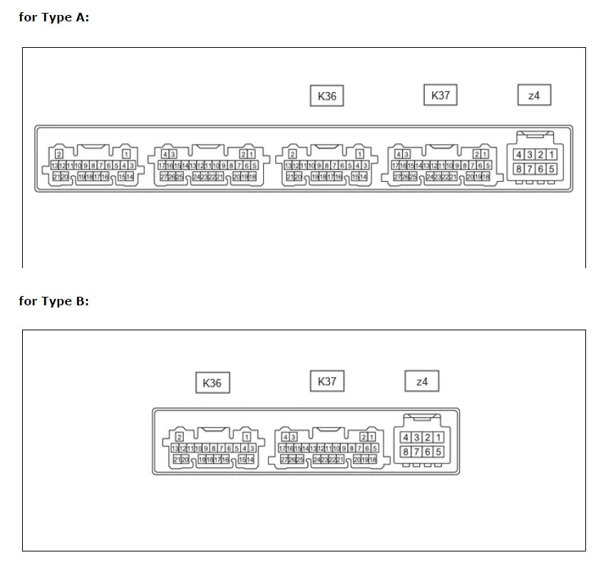

Update – A/C Amplifier Findings
I have some good news and some bad news after discovering a document in the Repair Manual I missed.
The Repair Manual identifies two different A/C Amplifier Assemblies: Type A and Type B. Type A uses five connectors, while Type B uses three connectors. The two additional connectors shown on the Type A diagram are K34 and K35. These connectors are dedicated exclusively to heated and climate-controlled seat functions for both the front and rear seats.
After lowering and inspecting my vehicle’s A/C Amplifier, I confirmed that the SR5 is equipped with the Type B A/C Amplifier Assembly. Unfortunately, this means the existing amplifier does not support heated seats. As a result, the A/C Amplifier must be replaced with the Type A unit, which is approximately $1,200 (after discounts I paid $930 with Tax, at this point I’m too invested to turn back)—this is the bad news.
The good news is that connectors K34 and K35 are already present in the vehicle harness. They are prewired from the factory and taped back.
I contacted my Toyota dealer’s parts department yesterday, provided a Canadian-market SR5 VIN for verification, and ordered the correct A/C Amplifier Assembly. Once the new amplifier is installed and everything is reassembled, I will provide another update.
I have scoured the Repair Manual and have not been able to determine whether the new A/C Amplifier Assembly will require programming or initialization using a scan tool after installation. The Repair Manual only provides removal and installation procedures, with no reference to any calibration, initialization, or programming steps.
I am not sure if we have a Toyota technician active on the forum, but if anyone can confirm whether programming or initialization is required after replacement, that information would be greatly appreciated.

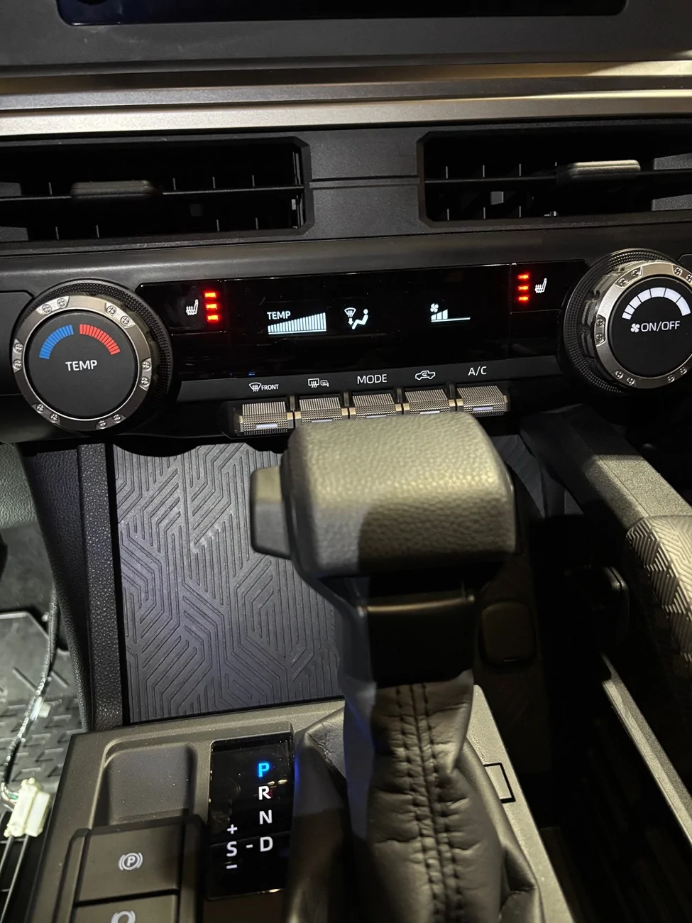

The A/C Amplifier Assembly has been replaced, and everything is now working as expected (the amplifier was 100% plug and play).
I will put together part numbers and photos to document my experience soon.
This project is not cheap, especially if you are having to source new parts.
