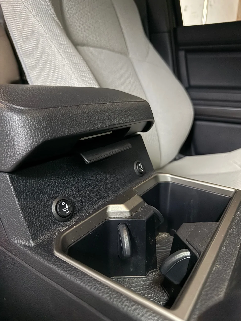

I'd shop around. Give your local car stereo / tint shop a call and see if they install them. I had mine done for $600 using the round rocker switch in the link you provided in the center console. The $600 was through the dealer which had a local custom shop do it. Had I know that the dealer would hire out I would have just gone straight to them and avoid the dealership taking a cut.

And not to be confused with the buttons where the rear locker and camera buttons go on other trims - this is what I meant by center console.

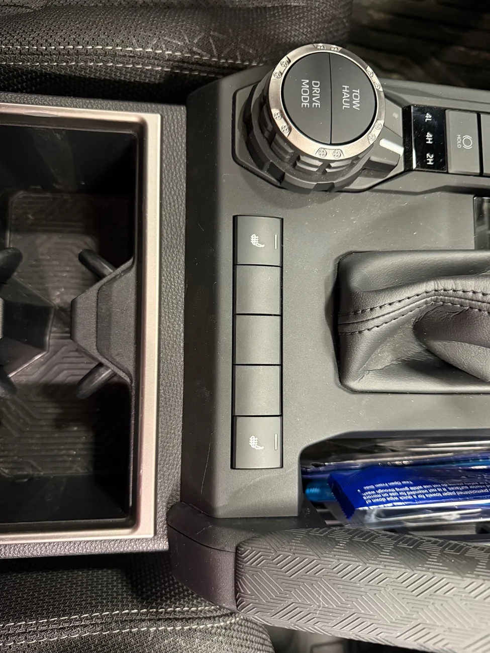

I just installed the Clazzio heated seats in my 2025 SR5. The install is not bad at all. The wiring is what took me the longest. These work great. The switches fit right in the console.

That's not bad looking at all. I want to be able to see if they are on in case my son forgets to turn his off :). I think IF I were to do this, I would go with the kit in the link above. I like the idea of factory looking switches. Thanks for sharing.

Slamkad - that looks awesome - the button placement is exactly what I had in mind. How did you figure out how to take apart the console and wire them up? How hard was it to dissemble the seat upholstery? Do you have any pics or links with instructions. This would make a nice DIY post on the forum. Any help greatly appreciated!

I did not have any instructions on disassembling the console. The part the shifter is on just pops off. Then I removed the 4 bolts in the bottom of the storage area in the center console. There are 2 additional bolts for the console under the part that has the shifter on it. I also removed the piece of the console on the passenger side that I would call a handle. It has 4 bolts. You have to remove 2 dash pieces to access 2 of the bolts.

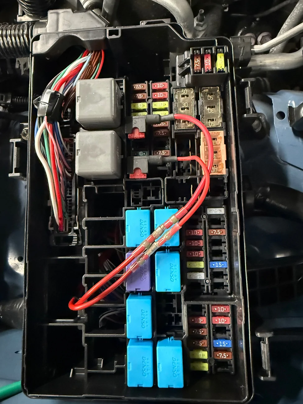

You need to connect 4 wires for each seat. Ground, Illumination, Ignition on, and 12v. Illumination I tapped into the wire that turns on the light for the shifter. Ignition on I used the wire on the cigarette lighter port. 12v I installed 2 add a fuse in the fuse/relay box on the left side under the hood. I took the wires into the cabinet through the boot for the speedometer cable.

I did not cut any of the factory wiring. I used Posi-tap connectors. I would suggest anyone else do the same.
I just picked to spots in the fuse box that were not being used. It’s possible they used wires under the seat. I wanted dedicated 12v wires ran for each seat.
