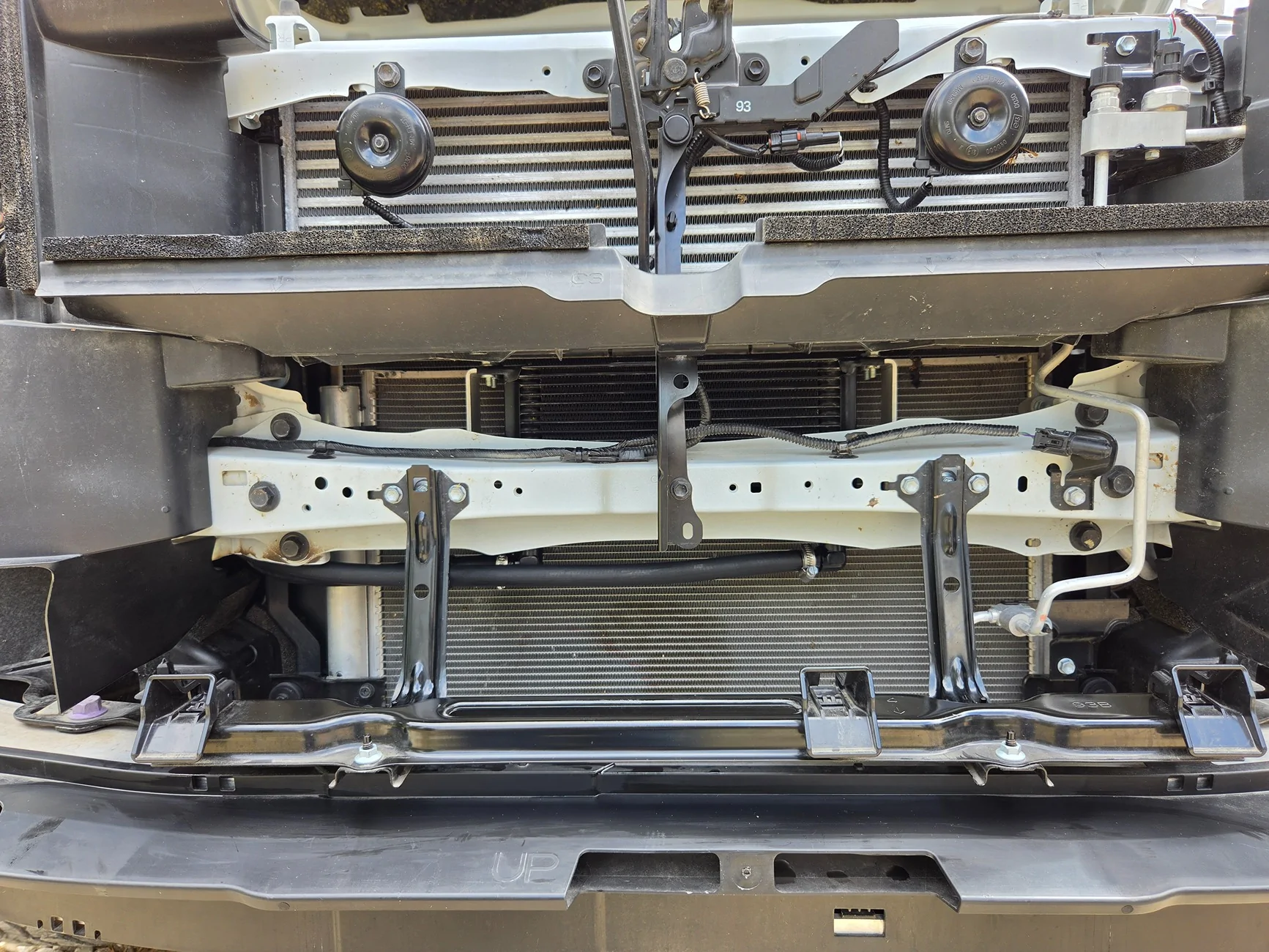

So your kit will take these existing lines, then extend them to a new bigger cooler? Will the front end need to come off to install this?

Yes the front bumper/grill assembly needs to be removed. Once you know how to do it it's really not that bad. I have a video linked on the cooler product page on my website on how to remove this. It's just alot of the same size bolts and push pins.
There are hardlines coming from the transmission and stop beside the motor. You just have to remove one of the short rubber hoses and replace it with a hose going to and from the new cooler. Each hose is only about 3 feet long and easy to access. The kits include the extra hose.
It's most recommended to run the fluid through the existing tiny coolers and the secondarily through the new aux cooler, then back to the trans.
