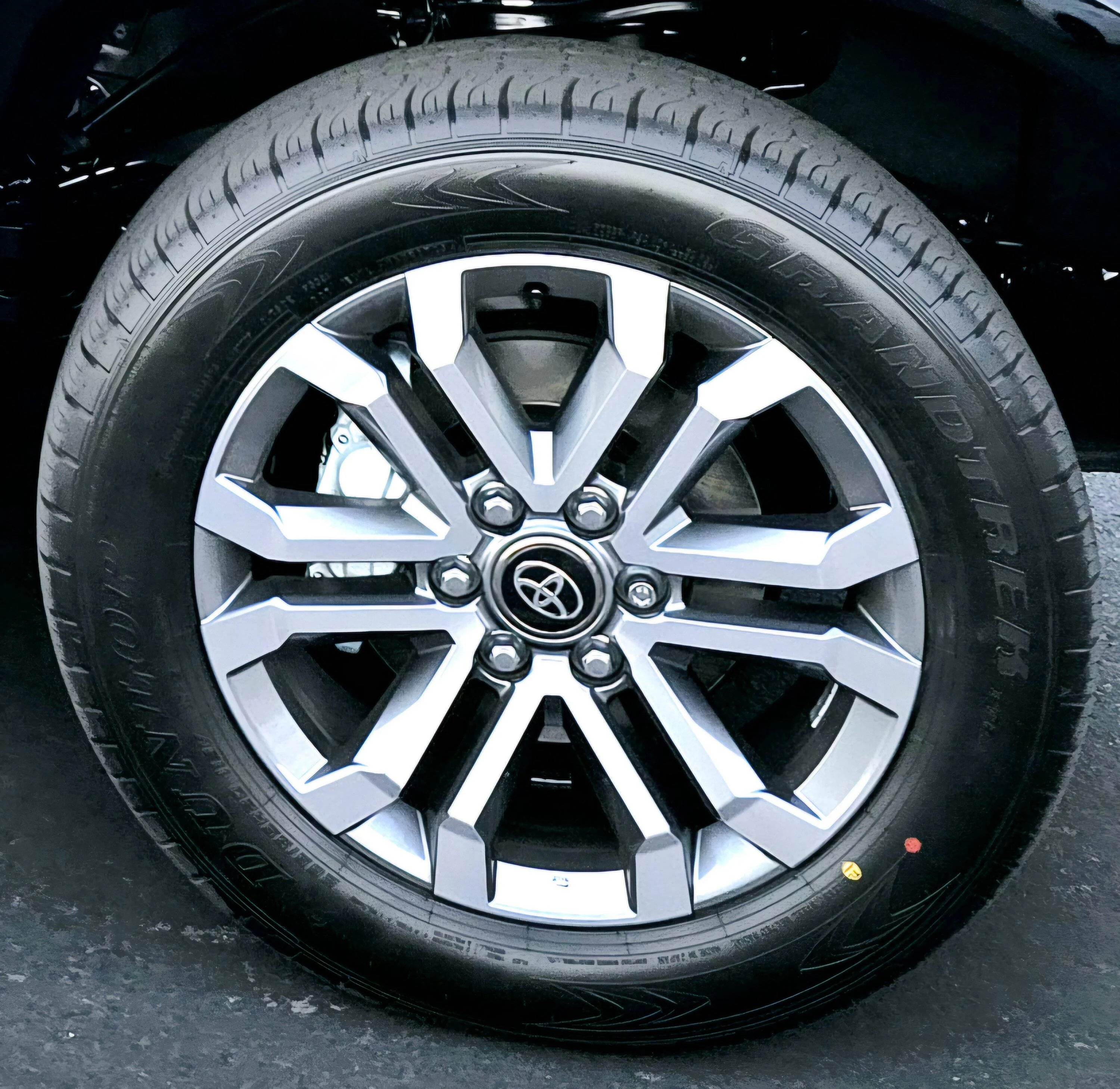

Was wondering if anyone knows how much the stock 20" wheels weigh on the Limited trim? Looking to replace them and want to shed some weight with lighter wheels. Want to keep all other specs identical.
2025 2026 4runner 6th gen How much do the OEM Limited 20" wheels weigh? 20250406_185537

well the MY24 4R limited wheel with oem tire was around 85lbs
to shed weight go with smaller 18's and or aftermarket
just dont screw it up with mounting load E tires which will just add the weight you saved on the wheels back on.
go with either SL or C load tires

Agreed. Planning to go with the 18" TRD upgrade wheels to stay OEM but get more cush than 20s. Definitely going with something SL to keep the weight and road noise down and have a smooth ride. I'm thinking the smaller wheels will shed enough weight to make up for the difference of the larger tires (re MPG). I don't have the technical knowledge regarding rotational mass etc, but I'm thinking that a 5-10lb lighter wheel should allow for a 3-8lb heavier/larger tire without impacting MPG. I was able to find some info on 5th gen wheel weights but not much out there on the 6th gens yet.

from what i can find from a reputable source (tiresize.com) (wheel-size.com)
these are +/- 10% for the wheel weight only
30.53 lbs : 245/70R17 110T / 7Jx17 ET50 48 - 52
32.91 lbs : 265/55R20 113V / 8Jx20 ET45 43 - 47
31.57 lbs : 245/70R18 110H / 7.5Jx18 ET55 53 - 57
35.3 lbs : 265/70R18 116T / 7.5Jx18 ET55 53 - 57

That's awesome thanks! I'm surprised that they're all so close in weight. From what I found on 5th gens, there was a 10-15lb difference between 17s and 20s... the 20s were a little bulky at 40lbs.

2023 4runner (i ref the wrong website in my previous post, its wheel-size.com not tiresize.com)
30.53 lbs : 245/70R17 7Jx17 ET15
34.17 lbs : 265/70R17 113S 7Jx17 ET15
34.17 lbs : 265/70R17 113S 7.5Jx17 ET15
34.17 lbs : 265/70R17 113S 7Jx17 ET4
32.21 lbs : 265/60R18 7Jx18 ET15
30.93 lbs : 245/60R20 107H 7Jx20 ET15

Is it possible those are the stock tire weights, not wheel/rim? Kind of odd that the 20" is lighter than the 17s.

higher quality material for the higher end trims (and the cost is reflected in the purchase price), cheaper heavier material for the peasants :ROFLMAO:
tire weights will vary widely since toyota doesnt settle on one brand to put on vehicles

I just took the 20's off my 2026 Limited. They weigh 74.4lb with the Yokohama Geolandar X-CV G057E which according to specs are 36lb. So that would make the 20" wheel about 38lb.
My scale is spot on - the wheels and tires I put on add up to the publishe specifications.

Also note that my 2026 Limited wheels were +60 offset. Not 55 or 45 as I've seen in various posts. 20x8 ET60
