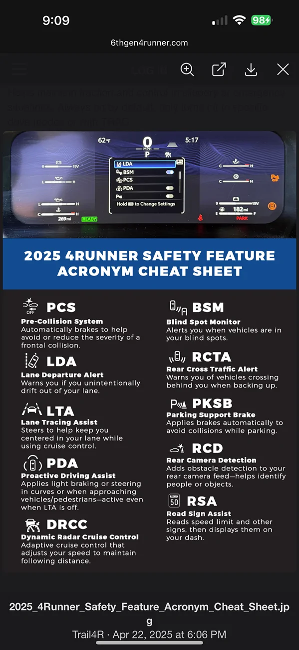

Here’s a little cheat sheet.
Hi, not sure where this graphic came from, but some of the icons are not correct for the names. The icon shown for PKSB is really the icon for Intuitive Parking Assist, and the icon for RCD is really the PKSB icon. The icon for RCD is not shown here, and the icon for RSA is different as well. See pg 590-592 of the manual.
64
2,703
1,528
or just look in the manual for the icon breakdowns (in ref to the cheatsheet pic)
