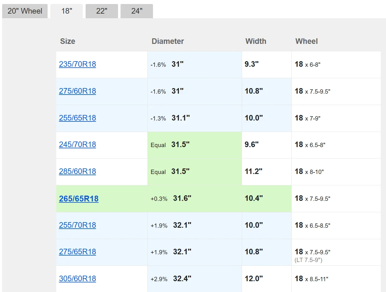

When shopping for snow tires, it looks like 265/65/18 are within 0.3% of the 20" full size spare.
Assume that is "close enough" for a short trip with the spare tire in case of a flat?

Yeah, the issue isn't binary like a light switch. Basically the bigger the difference in circumference, the more differential action the diffs are putting up with all the time. They are designed to do that (its right there in the name) but it does build up heat with a large difference for a long time. Would being a little off be a problem? No not at all. I mean, think about what happens if all your tires aren't at the exact same air pressure. Or what happens when you go around turns.
What matters is that it isn't off by a LOT, and that you don't drive on it like that for a long time or with the diffs locked (can't imagine that scenario, but just don't do it.) Your example is only off by 2 rotations per mile, you'll be fine
