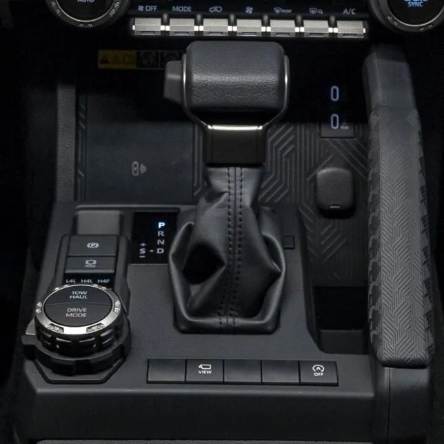

zachavm
Zach
Apr 15, 2024
42
Subaru Forester and Ascent
This is one thing I haven't sorted out from what's been posted. The full time 4WD LC has both center and read locking diffs. I assumed the full time 4WD 4Runners would too, and I still suspect that's the case, but when I read the press materials released so far it only says they will have a center diff lock, it doesn't mention the rear diff lock.
Unfortunately, I don't think that is the case. Here is a zoom in of the center console on the 4Runner limited. It is a crop from the press material. As you can see, there is no rear diff lock control. You can see the settings on the 4wd shifter (L4L, H4L, and H4F) showing that it is a full time 4wd model.
2025 Toyota 4runner Full time 4WD on Limited trim only? 2025_Toyota_4Runner_Limited_BrownLeather_01_cro
Though I really hope it is at least a limited slip rear diff, I've seen nothing in the press material or the Tundra site that suggest that will be the case for the FT 4WD. The one hope is that the 2WD Tacoma uses a limited slip rear diff. I'm hoping that is the rear diff used on any 4WD that does not have a locking diff. Otherwise it would require 3 different rear differentials.
