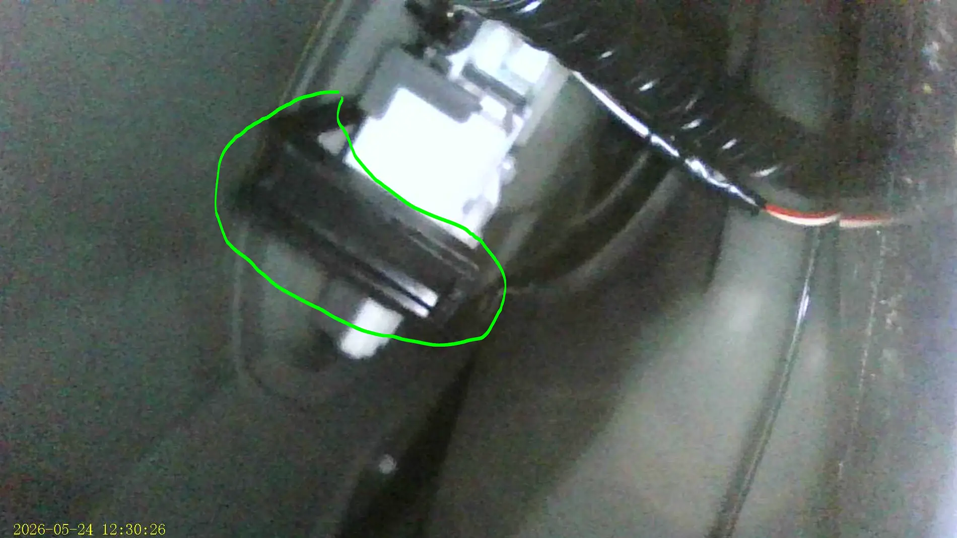

remove the access panel on driver side interior and operate it manually
this is an image from a borescope on my 2025 4runner,
taken thru the bottle jack access door
motor that activates the gas door is white assembly and you see a
little black plastic pull handle circled in green and closest to camera.
2025 2026 4runner 6th gen Fuel door won't open 1779638018925-24
get a hold of that handle and pull it releases door latch.
may need to pull trim so you can get your hand in there
or fashion some type of hook from a coathanger

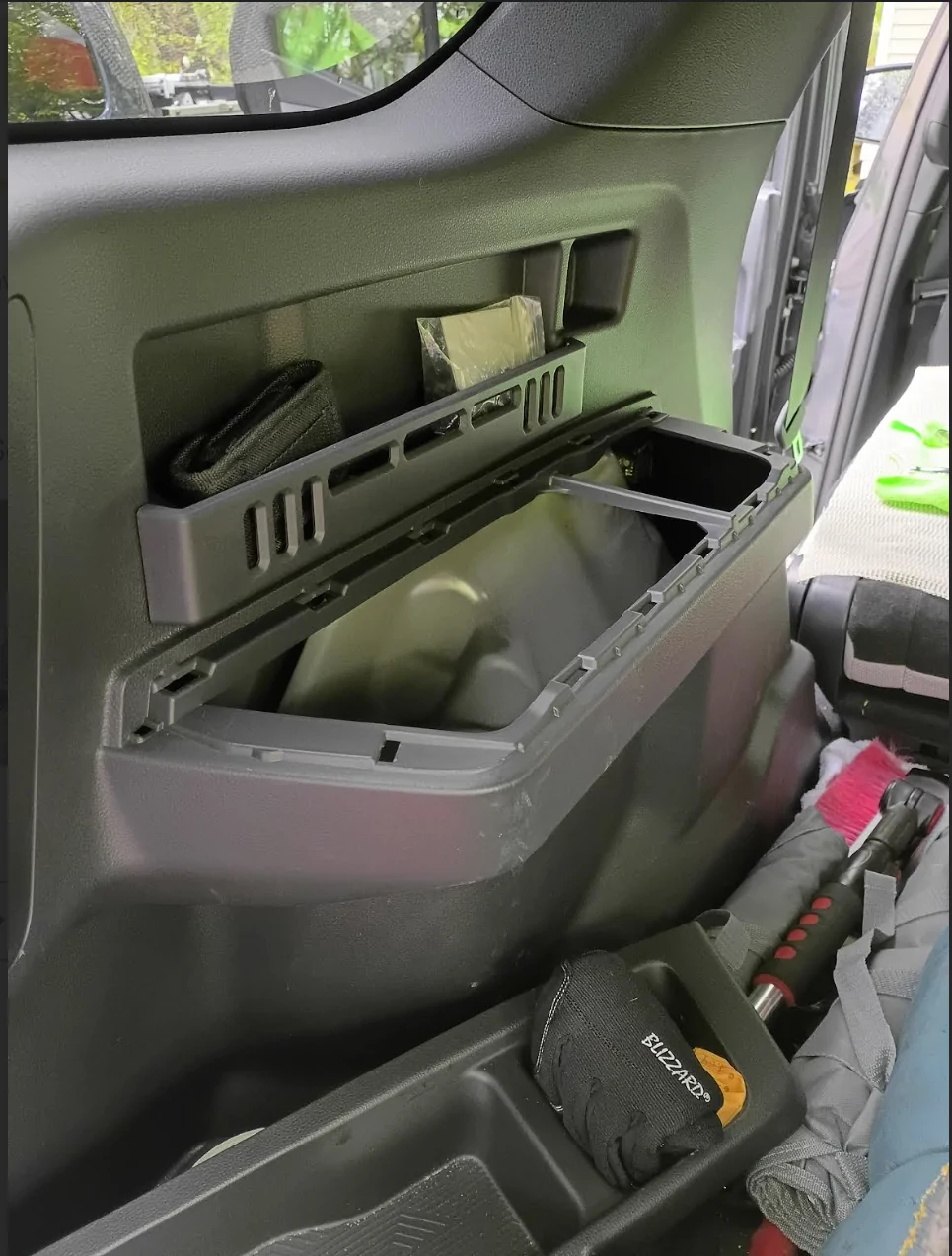

We have. 2025 Hybrid ORP…the jack compartment didn’t have a visible handle when the jack was removed…but the 12 Volt accessory battery is visible as you look down. Is the manual release handle in a different location in the Hybrids?
Kev
127.0.0.1
860
745
earf
a bunch of Toyotas
you see that part where I say 'may need to pull trim' ?
yank this trim and reach in and find the handle. don't cut yourself

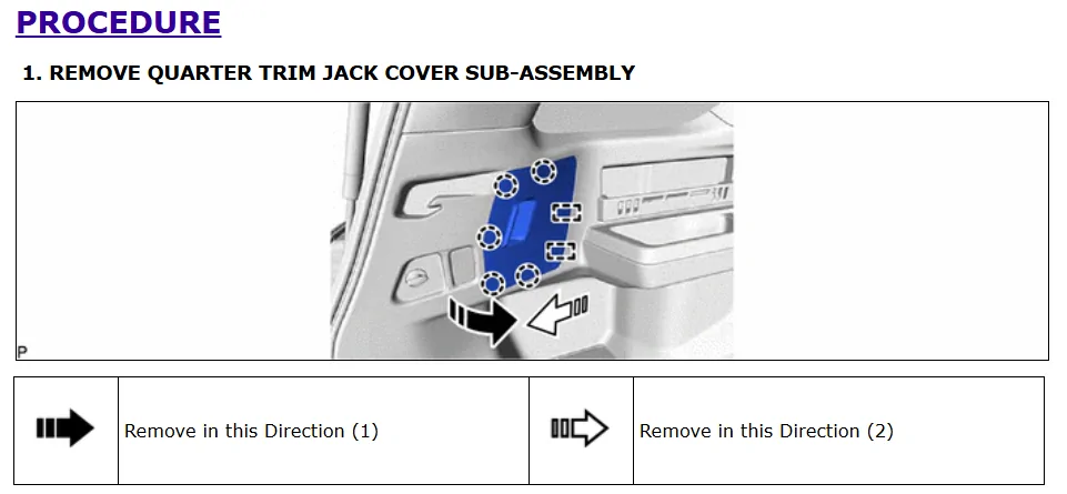

I'm using my borescope to send in a fish loop
and pulling from bottle jack access door
NOTE: The TIS procedure for replacing the fuel door motor
shows that you to go in via the Jack Access door
