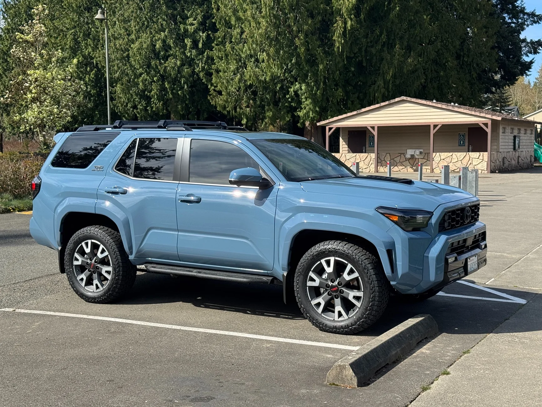

Hey everyone, looking for some expert advice! I have a '26 TRD Sport Premium and I'm currently running Falken Rubitreks on the stock 20s. I’m pretty happy with them, but I want to drop down to a 17" wheel for light off-roading. I'm slightly worried about the stance and potential rubbing.
Current Setup (Zero rubbing):
  • Stock TRD Sport wheels: 20x8 (+55mm offset)
  • Tires: Falken Rubitrek 275/60R20
Proposed Setup:
  • Wheels: Method 17x8.5 (0 offset)
  • Tires: Falken Wildpeak A/T4W 275/70R17
Will pushing out to a zero offset with this 17" setup cause any rubbing that requires trimming or modification? Thank you in advance!

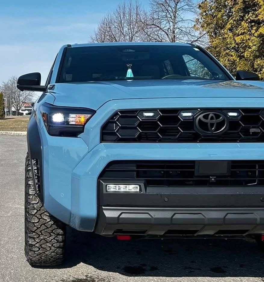

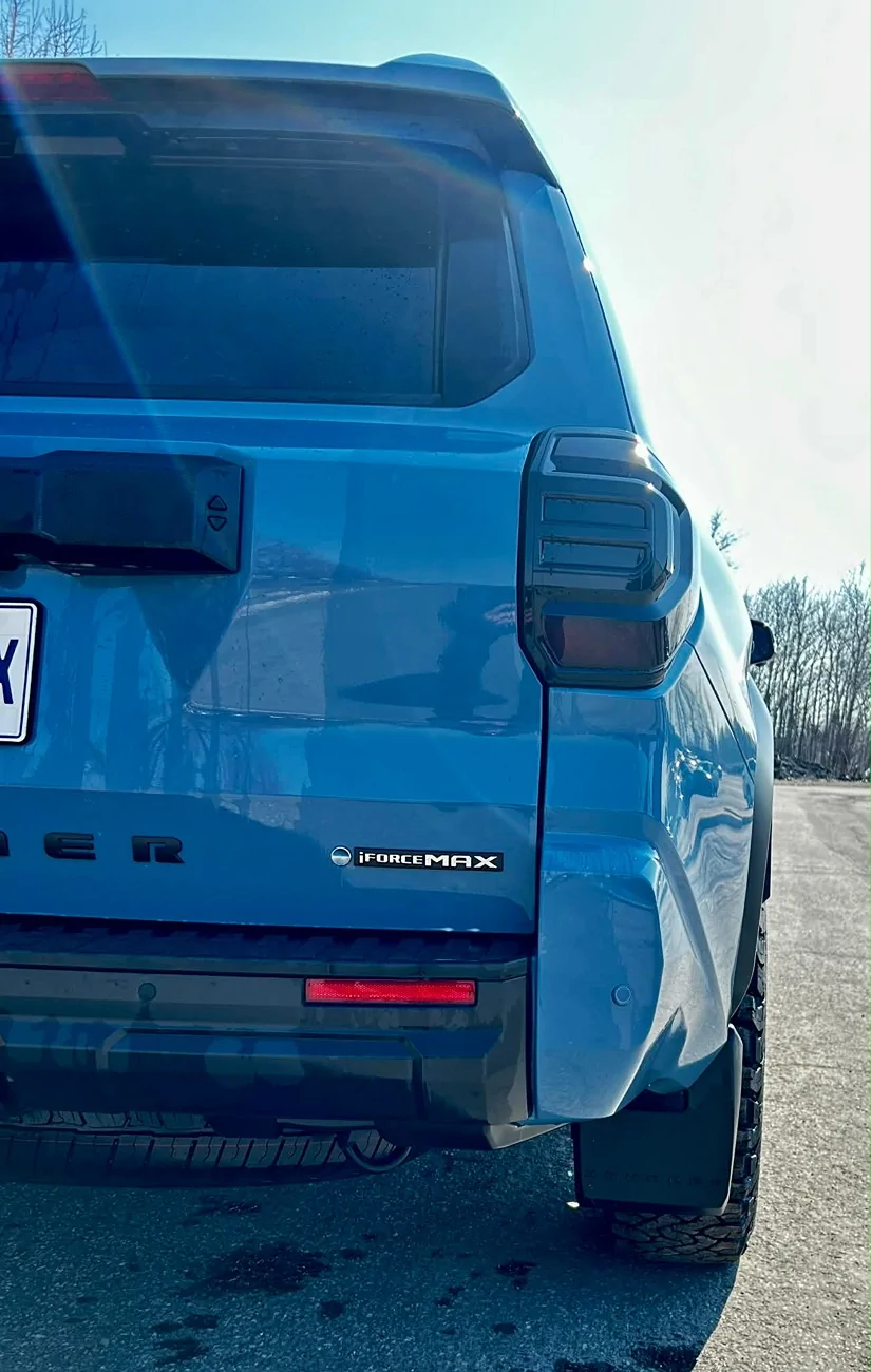

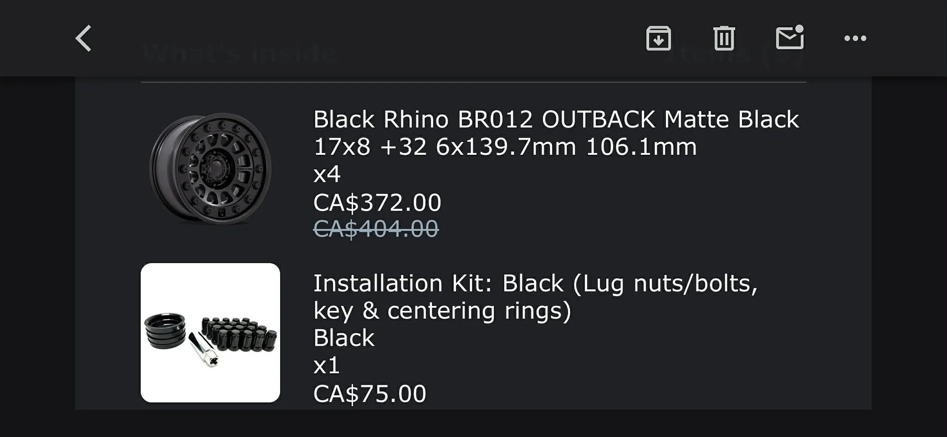

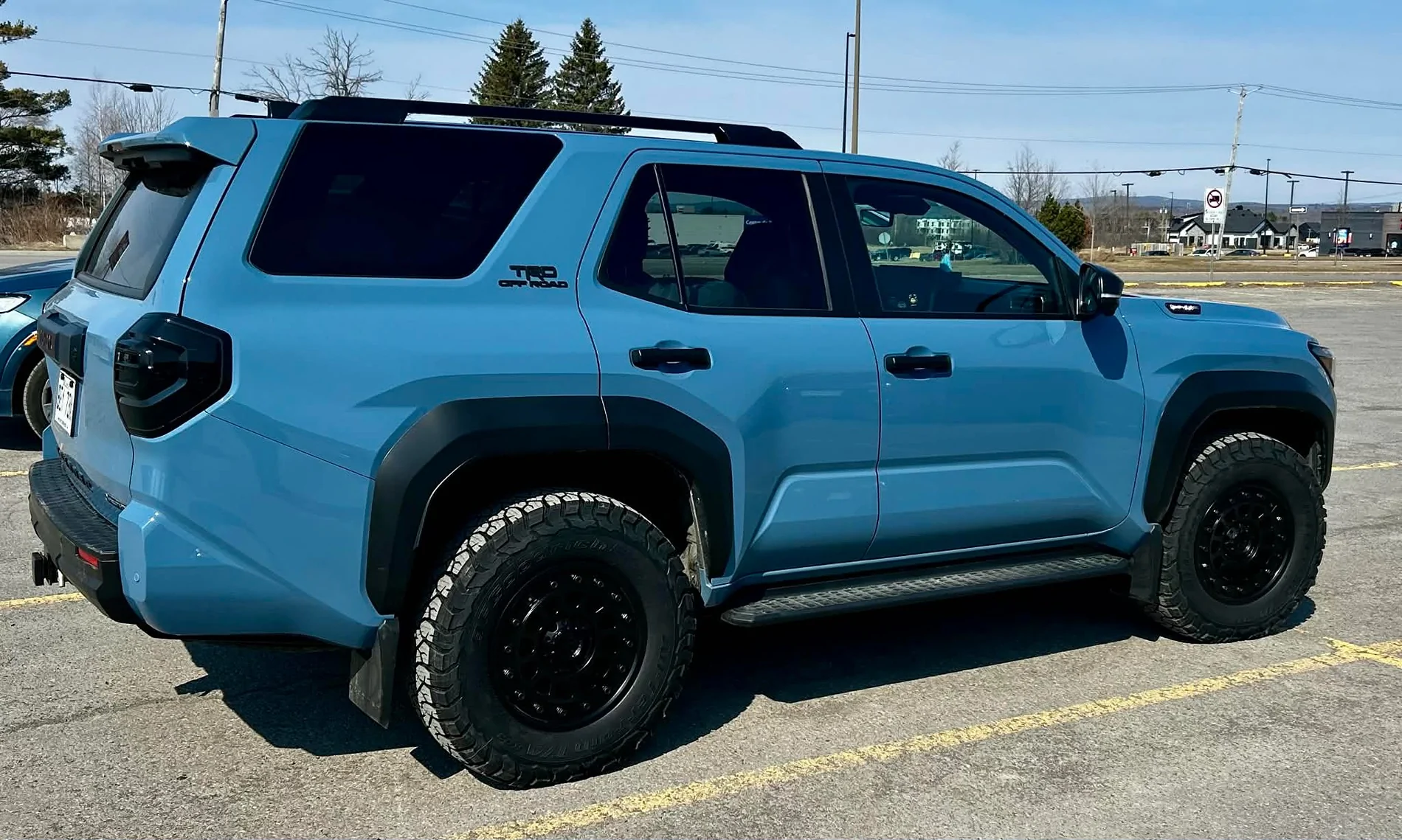

J'ai opté pour des jantes de 17 pouces x 8 pouces avec un déport de +32 et des pneus BFGoodrich KO3 275/75R17. Aucun frottement. Quelle que soit la position de la roue avant, je peux passer ma main où je veux. Avec un déport de +0, je n'aurais pas pu le garantir.
English translation:
I opted for 17-inch x 8-inch rims with a +32 offset and BFGoodrich KO3 275/75R17 tires. No rubbing whatsoever. Regardless of the front wheel's position, I can move my hand wherever I want. With a +0 offset, I wouldn't have been able to guarantee that.

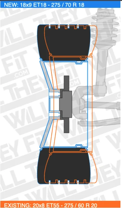

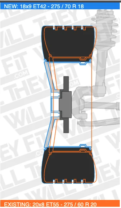

Thank you for all your replies. I realized my 17x8.5 with zero offset and 275/70R18 would most likely give me trouble without mods.
Now I'm looking at two 18x9 wheels, +18mm and +42 offsets. Can anyone tell me if these setups will give me issues without any lift/mods?
Current setup - factory 20" TRD Sport wheels(+55mm offset) with 275/60R20 - no rubbing whatsoever.
18mm offset
2025 2026 4runner 6th gen Fitment check: Moving from 20s to 17s on '26 TRD Sport Premium – Will 0 offset rub? 18 offset Screenshot 2026-04-12 at 10.09.00 PM
42mm offset
2025 2026 4runner 6th gen Fitment check: Moving from 20s to 17s on '26 TRD Sport Premium – Will 0 offset rub? 42 offset Screenshot 2026-04-12 at 10.08.26 PM

The factory wheels are +25 for Pro wheels, +45 for the TRD wheels and +55 OR if I remember correctly. So 45-55 would likely be best option

Ended up ordering 18x9 wheels with +42 offset and 275/70r18 Nitto Terra Grappler G3s. Keeping my fingers crossed.
