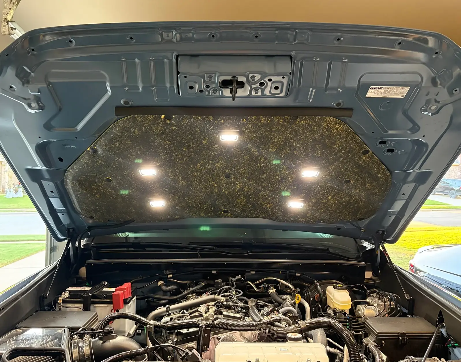

No more yelling at my son to hold the light! Big shout out to Billy Uldrich for giving me the idea and all the help.
DIY instructions:

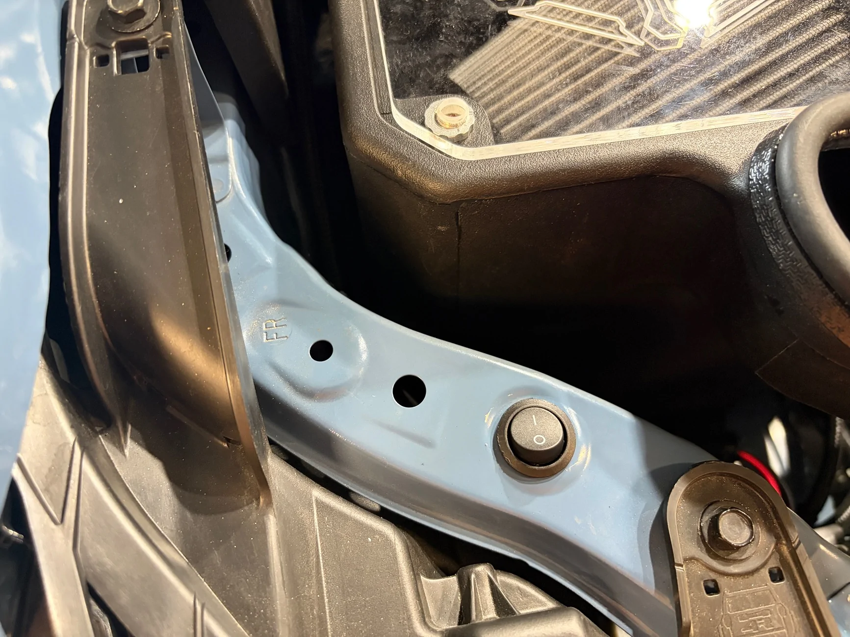

Ok here you go! However, I did modify these instruction to make it a cleaner install and I only used 5 lights. Also, I have attached the supplies I ordered from Amazon. For the switch you need to trim the sides to fit in the hole. Use 5 MICTUNING C2 rock light pods instead of 8 simplifies the wiring slightly and reduces the current load. With 6 pods (assuming ~2-3A each at 12V), the total draw will be around 12-18A, which is well within the 18AWG wire's ~10A continuous rating per wire (safer with short runs) and the Nilight relay's built-in 30A fuse capacity. The single ground wire approach still works perfectly. Below is the revised box-based wiring diagram and steps tailored for 6 lights.Revised Printable Box-Based Wiring Diagram

• Mount the DaierTek rocker switch in the engine bay (Trim the switch and put it in the hole near the air intake).

• Flip switch ON: 5 lights should turn on (relay clicks). OFF turns them off.
