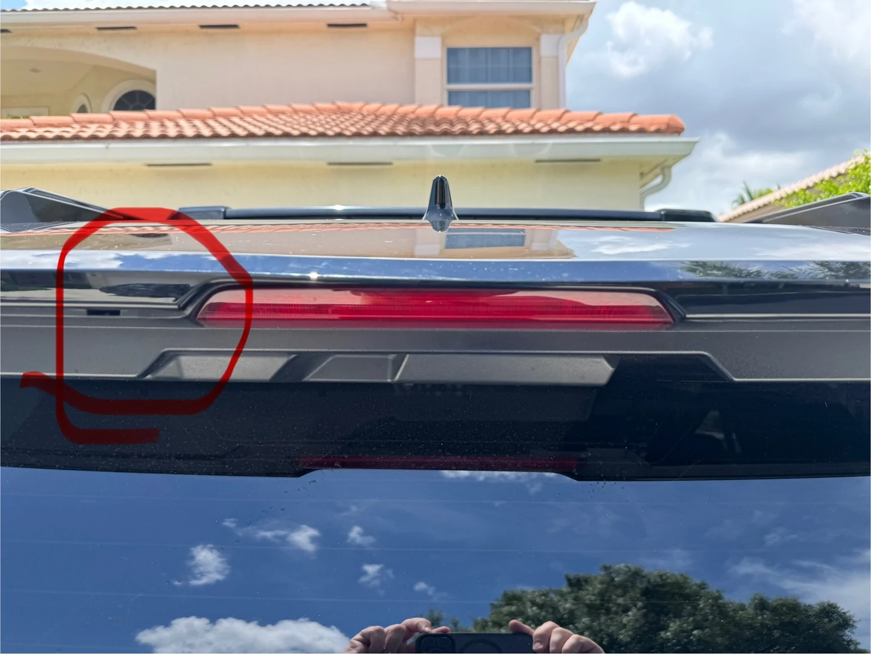

FoozGrind
Apr 4, 2025

Hey all,
I wanted to share some feedback, experience, and a video that might be helpful regarding the bass rattle in the driver side window. I've posted this as a reply in some of the threads but thought it might be helpful as a separate post. Like many have shared that ONE of the issues they are experiencing with their new 4R ($R) is the rattle noise coming from the driver side window.
I experienced the noise shortly after taking possession of the SUV. Since the noise was so obvious I took it back to the dealer about 4 days after receiving the truck. The sales manager confirmed the noise when I played 'Filthy' from JT at about volume 40. Scheduled an appointment for the following day with the service dept - went through the same demo with the service mgr. He heard it too. I asked if I could have the tech working on the truck to video what he found (see attached). It's been a few days of bass bliss in the new Limited Hybrid.
Hope this is helpful.
CG
Brought mine in today to get my brakes fix and have this noise and my spolier fixed. I swear it was coming from the seatbelt adjustment area near the drivers ear but i showed them this video and a song to test and bam noise is gone. THIS fixed it thank you.

How did they fix the spoiler?

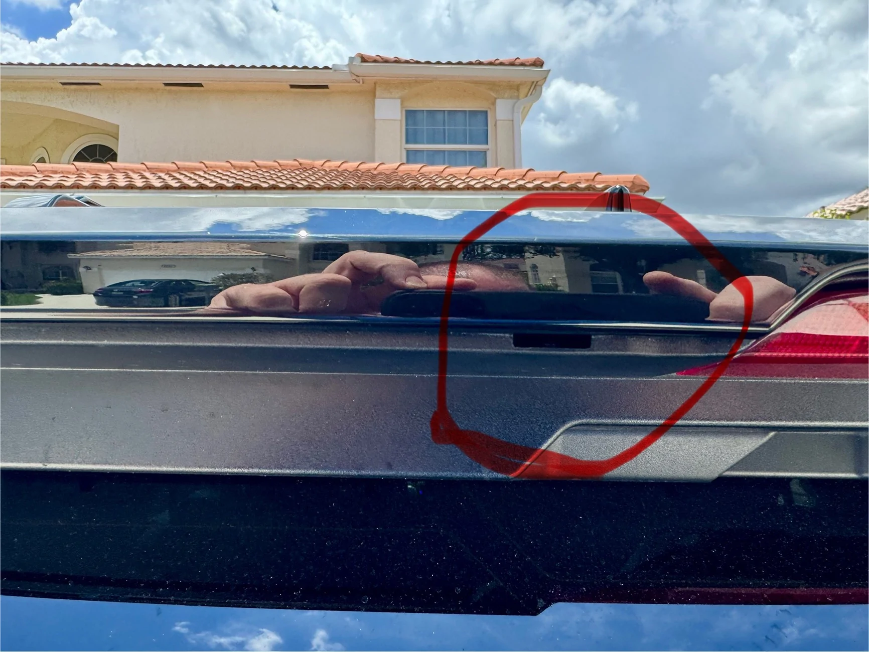

Regarding the spoiler... was it just the short up and down movement/ slight loose fit? Or something else?
(y)
No the two pieces that connect it together the clips are not holding on the left side.
