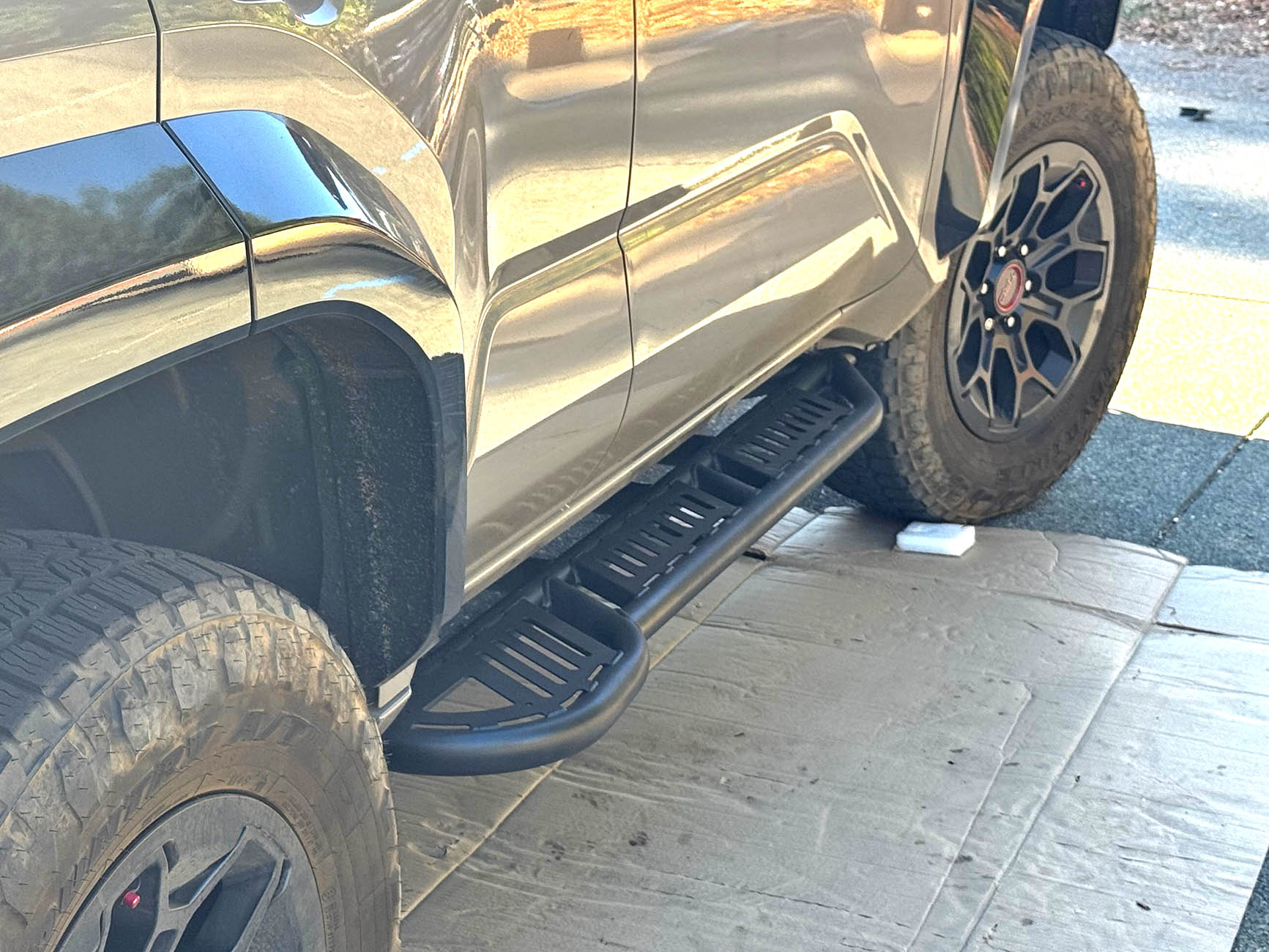

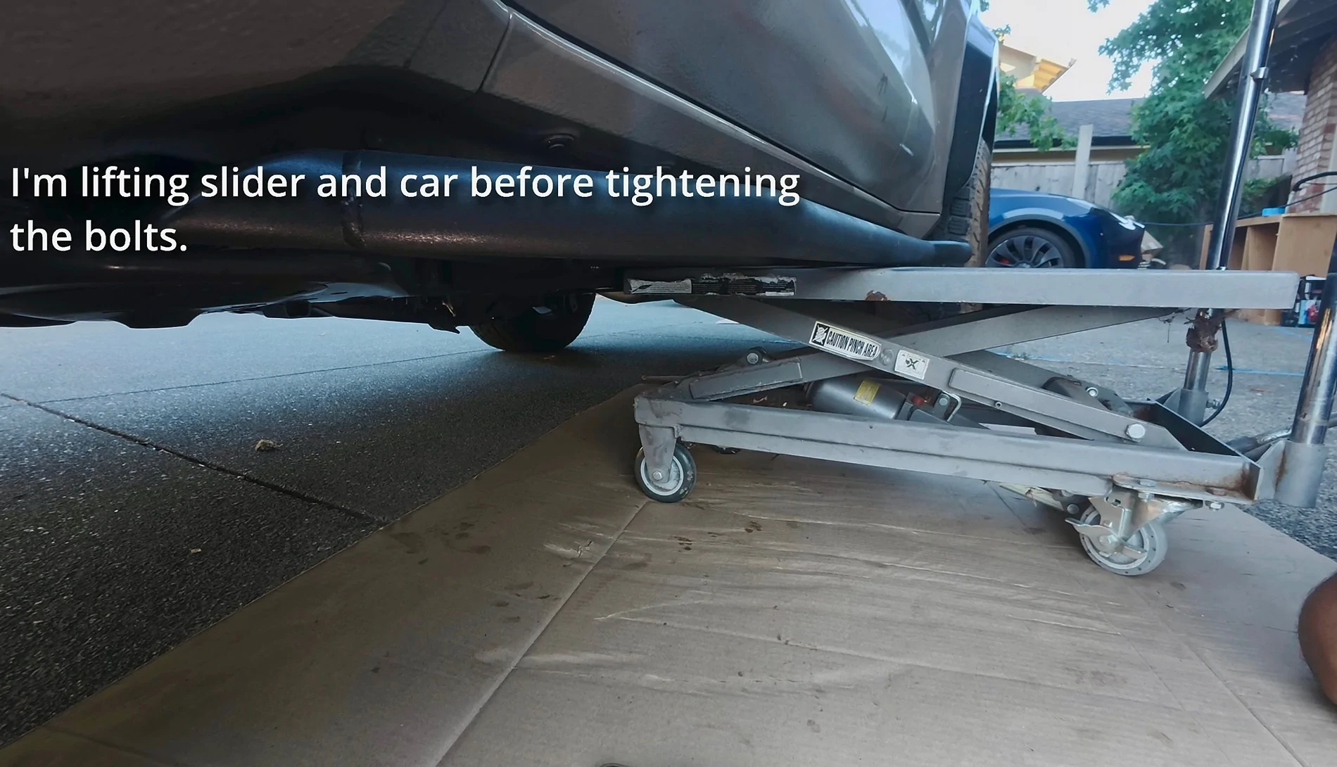

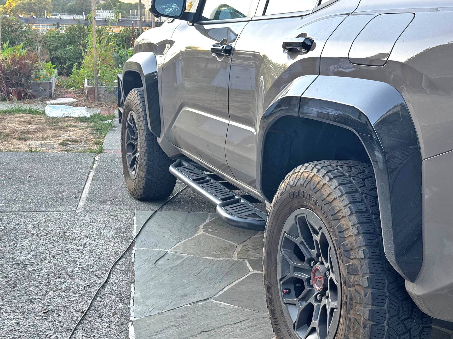

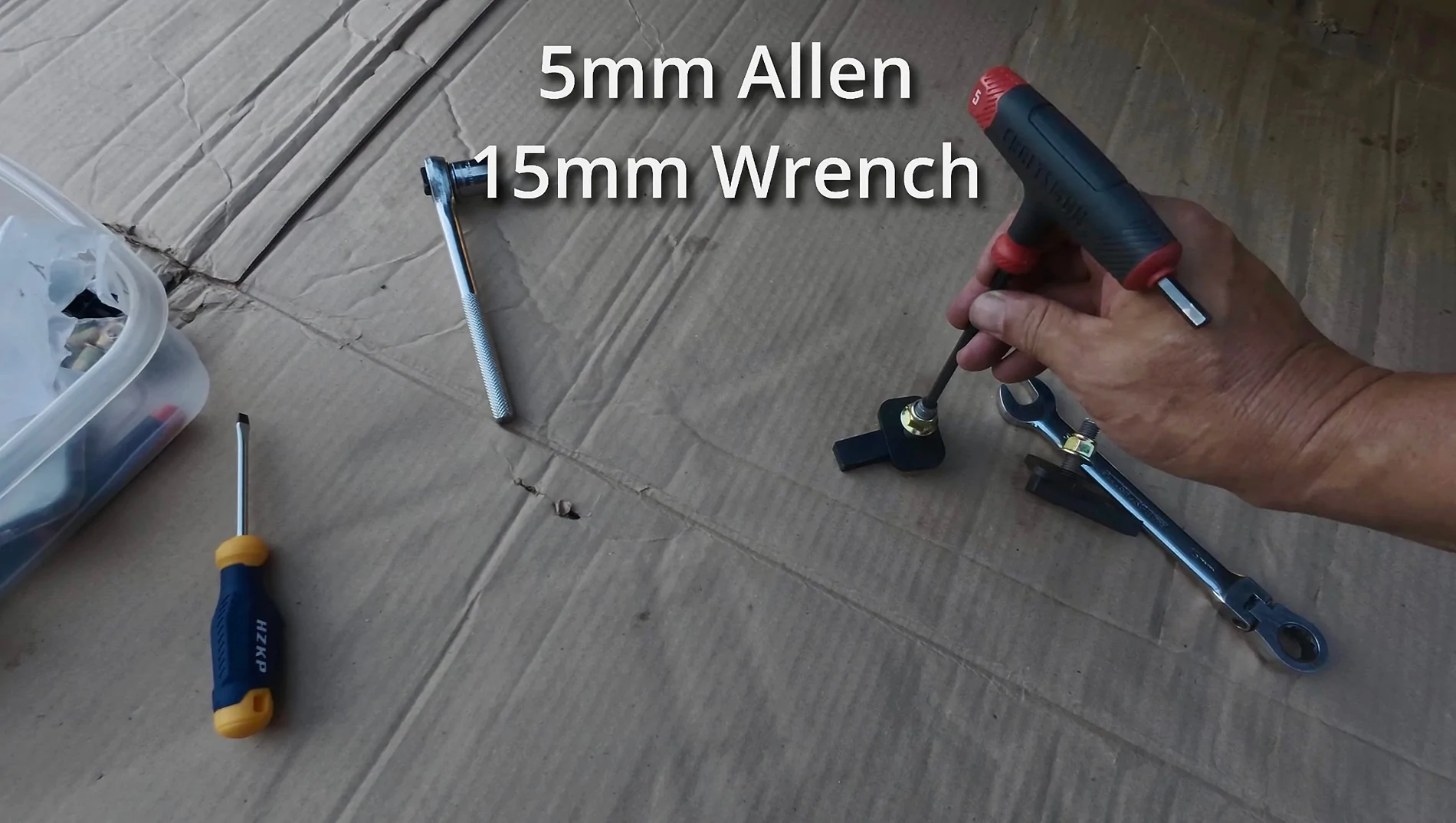

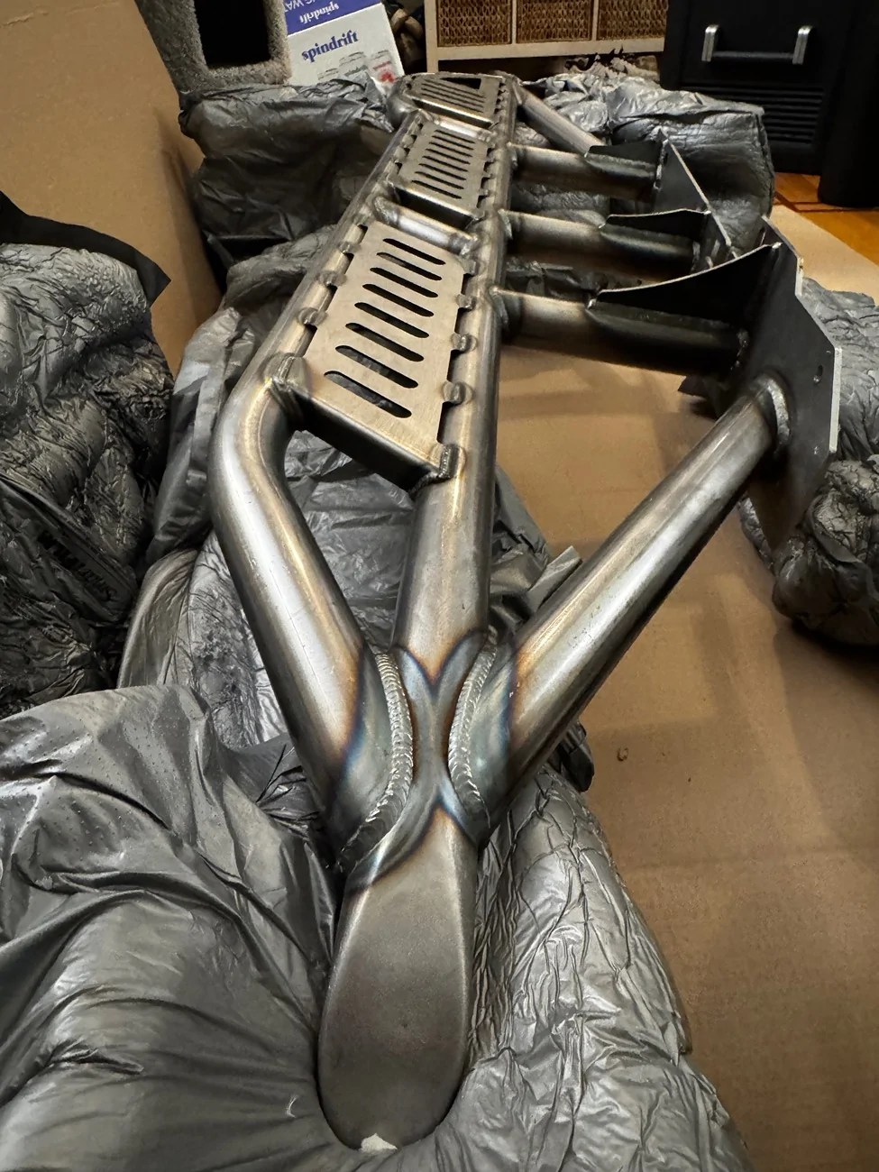

Hi all. I just uploaded my install video for Westcott Designs Rock Sliders. Westcott doesnt have install instructions or video so I was doing this blind.
Hopefully this video will help those of you considering this.

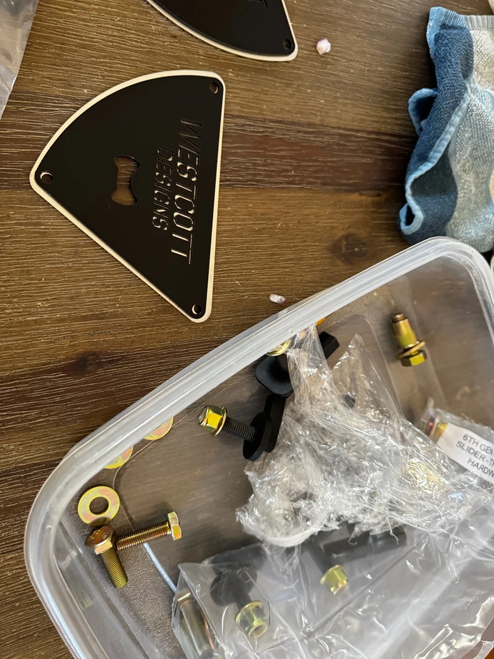

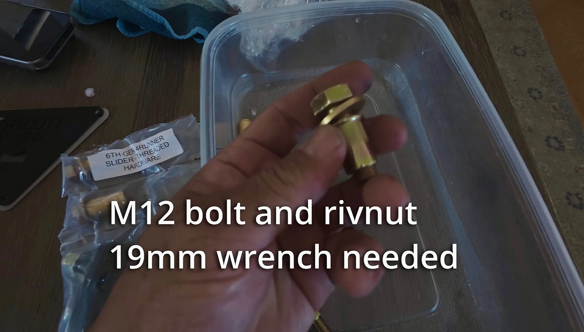

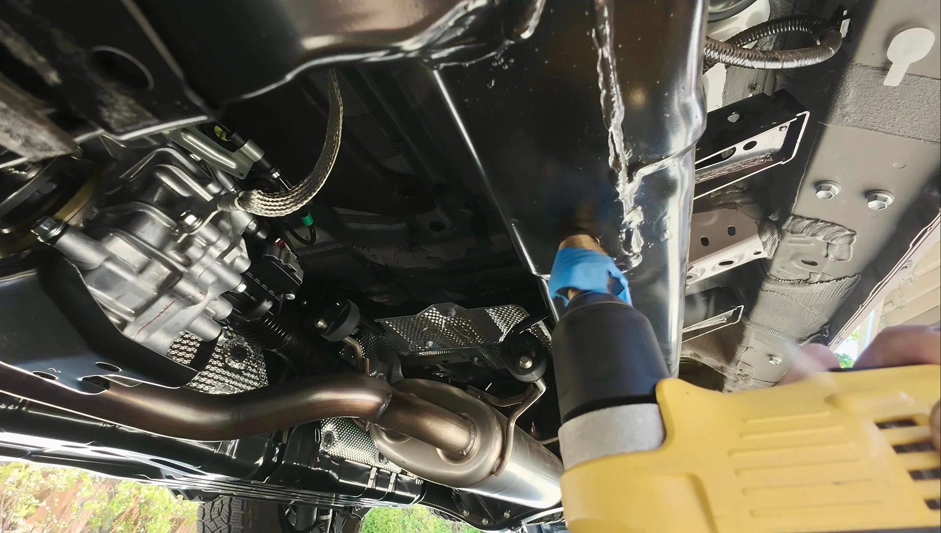

In theory its a very simple install. Only 8 fasteners per side. But the challenge is the fasteners. Three types. 3 regular bolts. 3 nylock nuts on special bolts that require an allen to hold and two rivnuts.

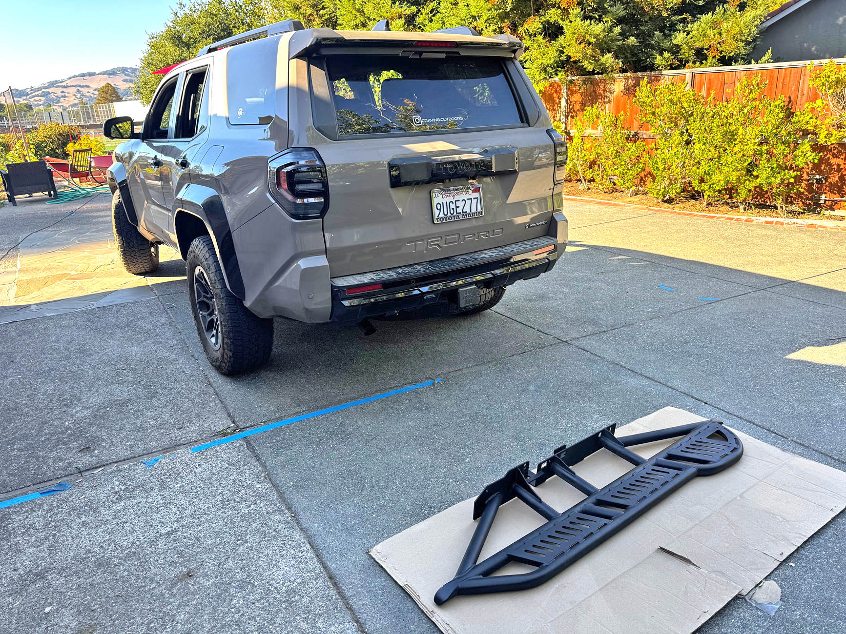

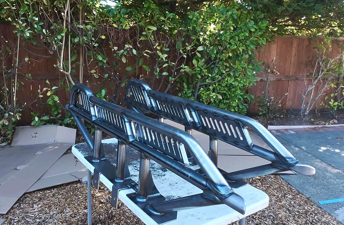

I also ordered raw metal and painted myself using a process ive used in the past with great success.
Here is the link to the video that details what why and how.
Then some pics. Hope this helps someone! Feel free to ask questions.

Thanks! The rivnut install was hard the way I did it. Waiting for the M12 bit for my tool would have been the way. But Im a dumbass and like to do things the hard way! Lol.
Although I will say that the nylocks were also a pain in the ass. Good luck on your install!
