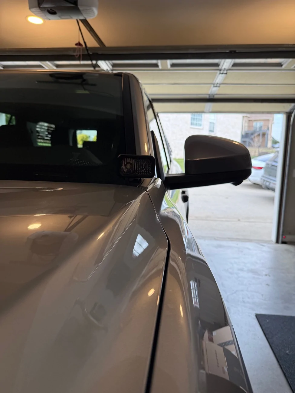

I went rogue and mounted these to the fender bolt. Super easy. I just 3D printed a small spacer, drilled a small hole in the rubber trim, and replaced the factory bolt with a longer screw. Might drill the hole out larger and reprint a spacer with a top lip that would sit on top the rubber. Not sure if it’s worth the trouble. Hood clears and they feel rock solid.
