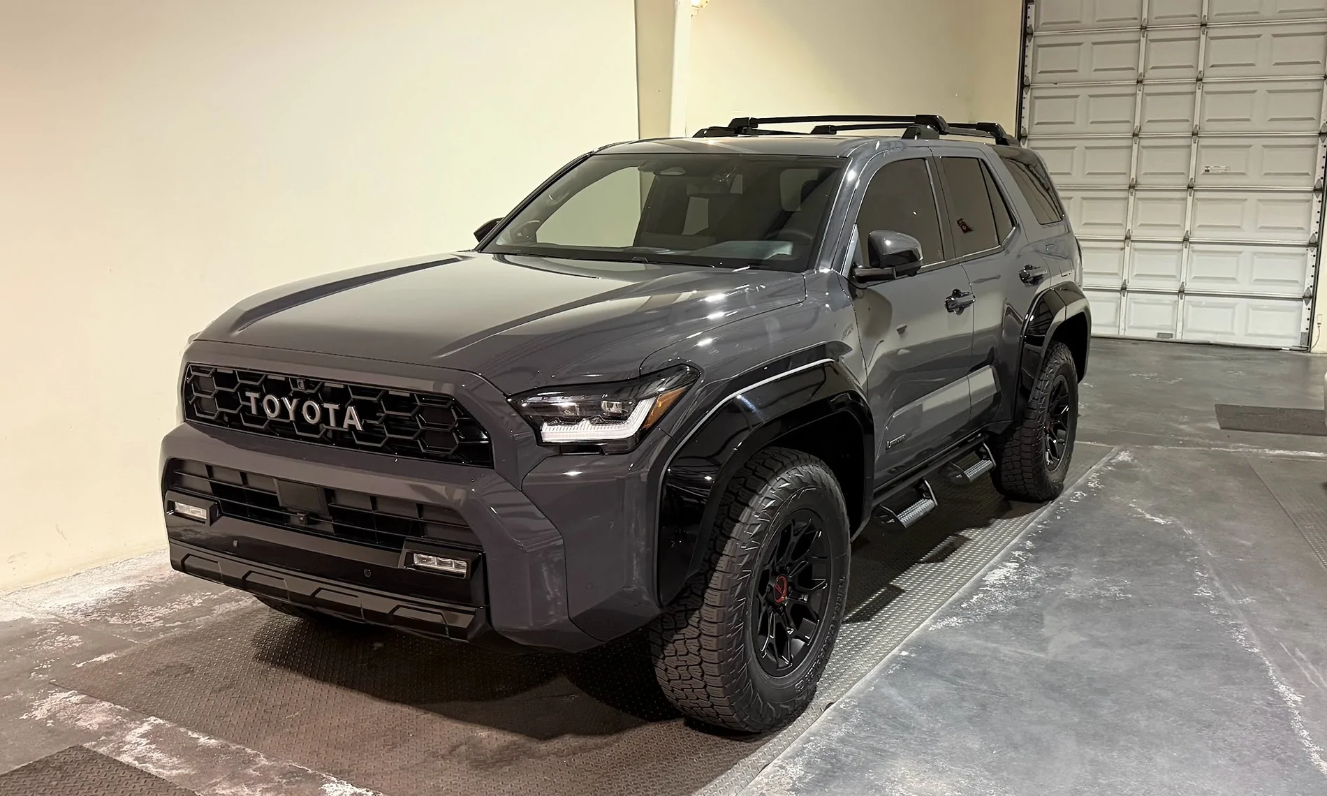

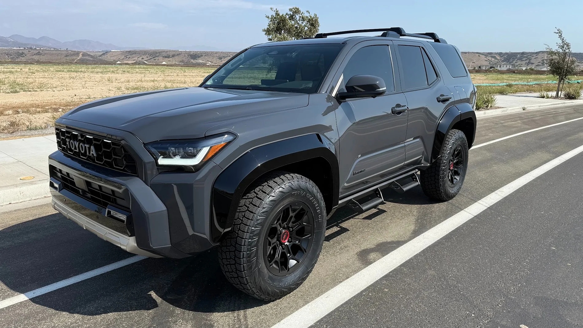

I purchased my Limited because I wanted the brown leather Portobello interior which ONLY came in the Limited. However I didn't like the look of all the chrome etc. So I did this:
- Purchased the bronze overlay kit (only kit that had the "Limited" badging) and painted it matte black. Then stuck it on and it removed all the chrome badging.
- Purchased and installed for cheap the gloss black roof rails from a forum member here.
- Purchased and installed the TRO PRO upper grill.
- Purchased and installed some TRO PRO Rims and rapped them in Nitto 275/70/18 tires.
- Had a local shop paint gloss black the front and rear gray bummers.
Obviously I did some other stuff but not related to the OP's question.
