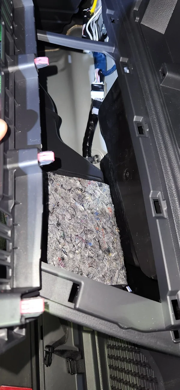

Has anyone had any success at removing the small side storage baskets in the cargo area under the side windows? I've pried quite hard out and up without luck so far. I'd rather not rip them off in pieces yet, any help would be appreciated.

you should remove the entire trim panel and access the back side
attacking from the front I am not sure it's doable but will require specialized
trim tools and high chance of breakage

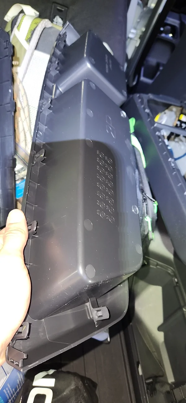

Thanks for the suggestion. I tried it today in warmer weather, above freezing, with a forked pry tool and finally got one fastener popped out and then all the rest (3). No harm to little bin/baskets and will push back in if needed.
