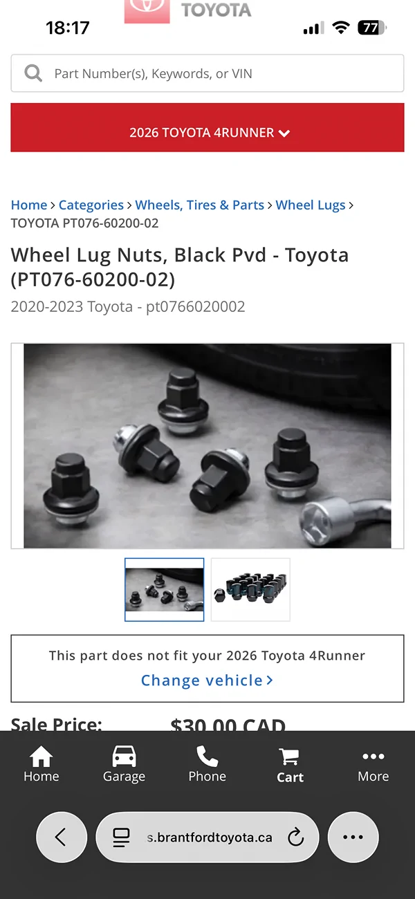

Can anyone confirm that Toyota P/N
PT076-60200-02 are the correct lug nuts for a 2026 TRD off road premium. Website says may not fit (bottom of pic)
Or any aftermarket lug nuts?
2025 2026 4runner 6th gen Black lug nuts IMG_7968
These are for prior gen. Your screenshot even includes that point.
They are M12x1.5 6th gen 4runner is M14x1.5

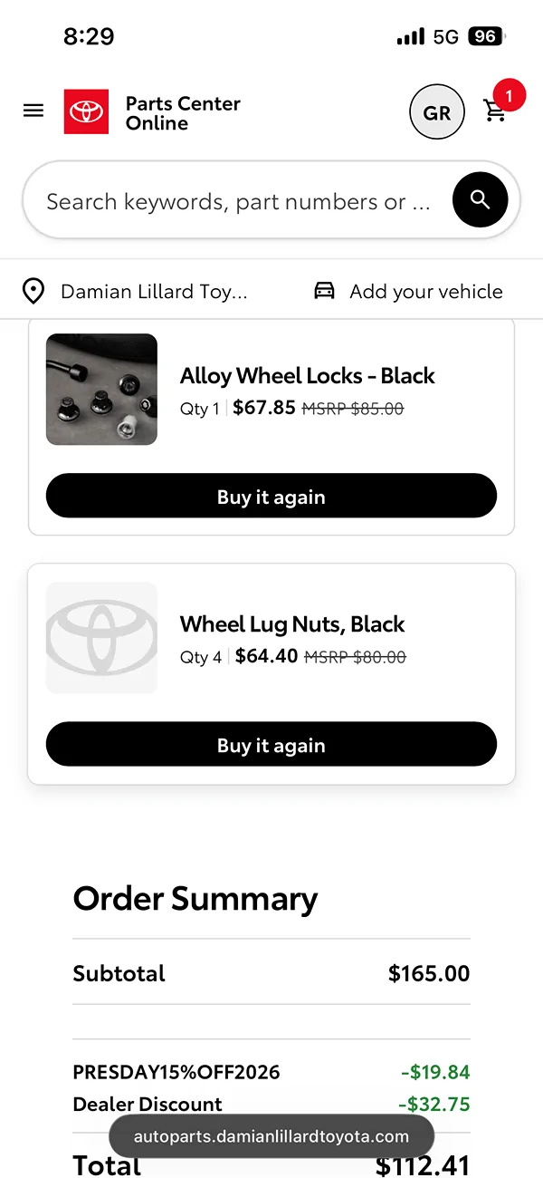

I ordered these for my 25 TRD ORP:
- Wheel Lug Nuts, Black, Toyota Genuine #PT076-0C200-02: https://autoparts.springhilltoyota.com/products/product/wheel-lug-nuts-black-pt0760c20002
- wheel locks, Toyota Genuine #PT276-34231-02: https://autoparts.springhilltoyota.com/products/product/alloy-wheel-locks-black-pt2763423102
Note: The wheel lug nuts come in sets of five I believe. I ordered 4 (20 total + 4 wheel locks = 24)

Have you installed them yet? Toyota website is telling me they dont fit
Yes. Been on for months (installed February, two tire rotations since then).
Though, heads up, I just remembered that they are 22mm. The original ones were 21mm. Wheel lock is 21mm. I pushed back on dealer and they confirmed those were correct.
I just carry two Koken wheel lug nut sockets, a 22mm and 21mm. Not a big deal for me.
