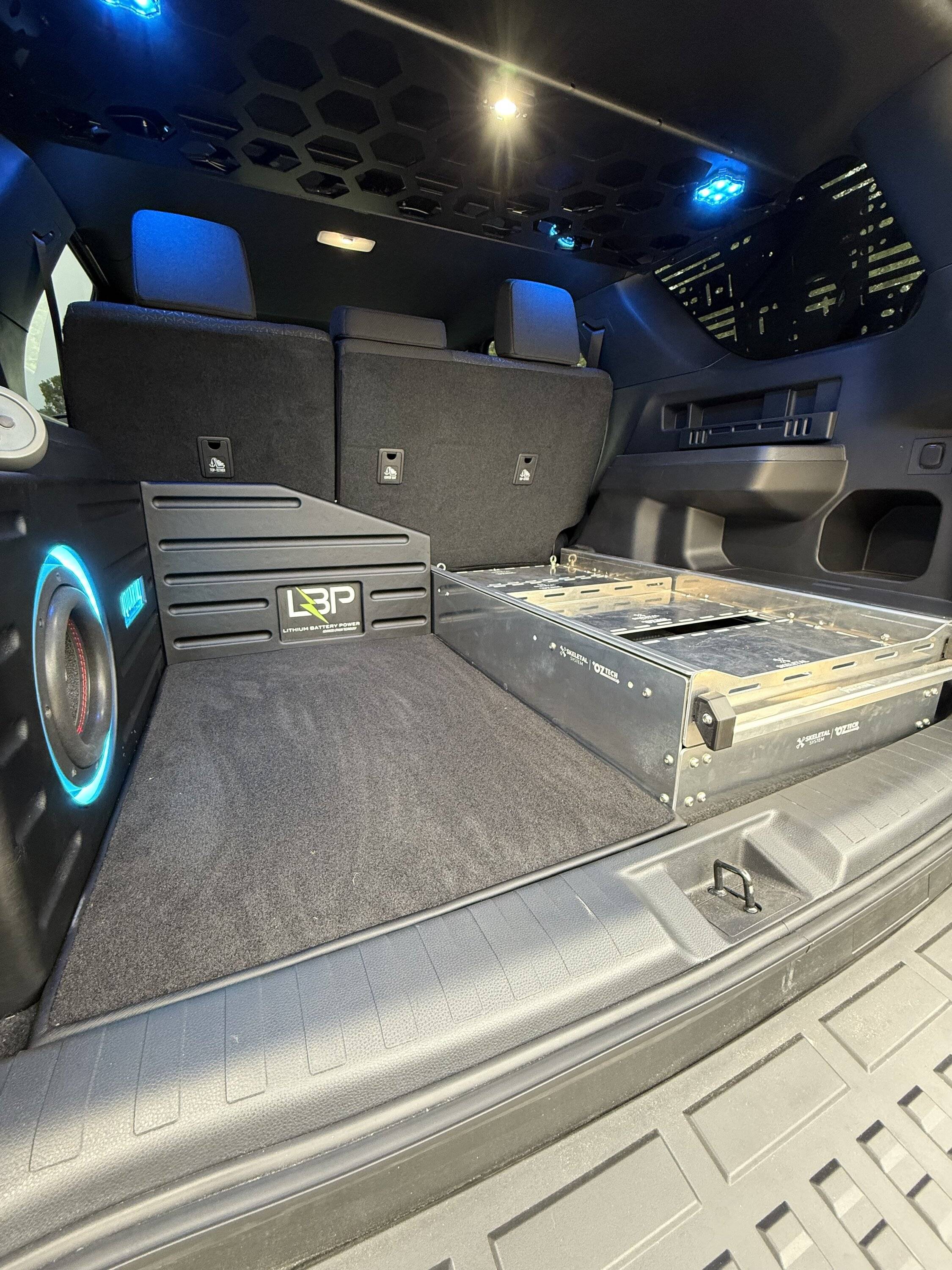

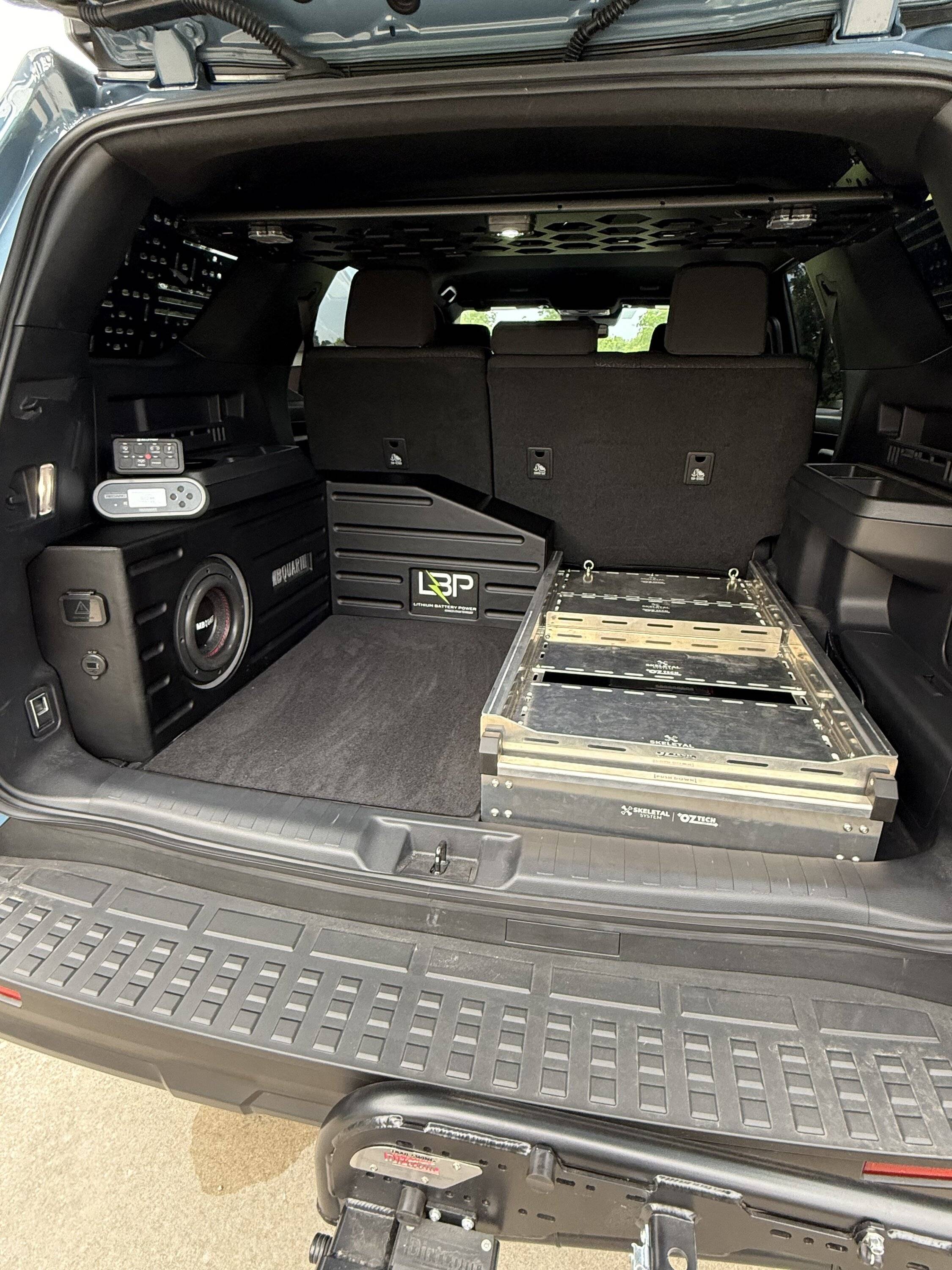

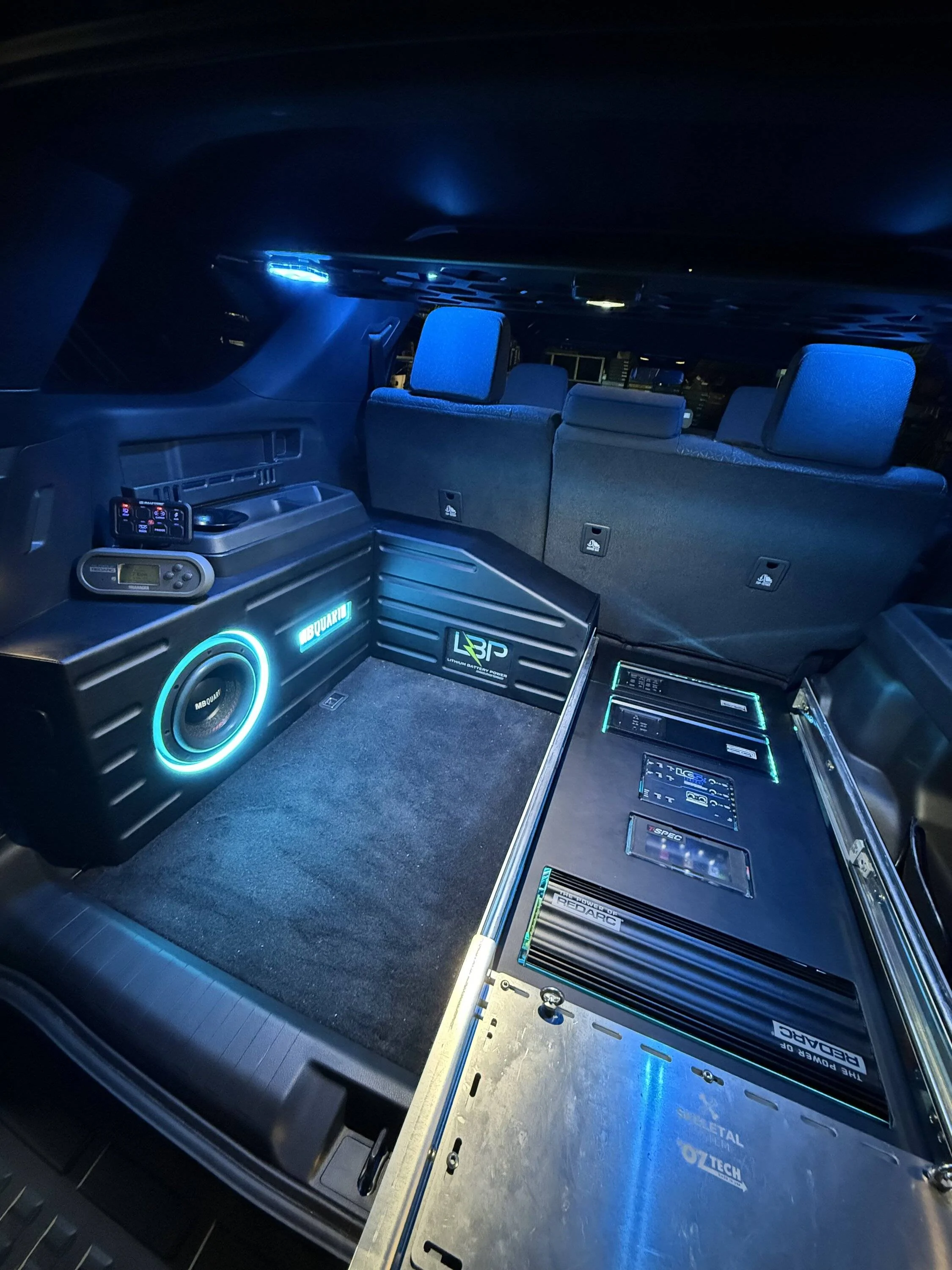

Been working on building out the rear area of why build. had Oztech USA custom build me a slide that would house all my audio gear and dual battery solar set up.
Oztech slide
MB Quart amps and 8"sub, along with soon to be released door component set up speakers
Audio control lc5ipro
REDARC manager 30 dc2dc charger, solar input, ac hook up
Lithium battery power dual 108 ah lithium batteries
Bulletpoint 8 gang solid state switch panel with rubigrid mounts
USB outlet, with volt meter, Anderson connectors for solar and refrigerator hook ups
Diode Dynamics led lighting, with bulltooth controller
