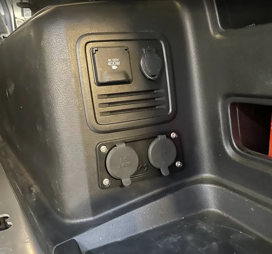

We always wire in the Dometic Hardwire kit. It has a threaded port for fridges and a standard "cigarette lighter" port. It can be flush mounted or panel mounted and comes with all the wiring and fuse for the setup. Here's how I've done it on several 5th gen's and how I'll do it on our 6th when I finally have a chance to wire the batteries and compressor I have mounted under the platform!
