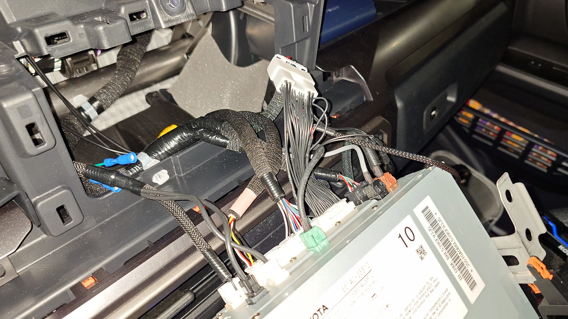

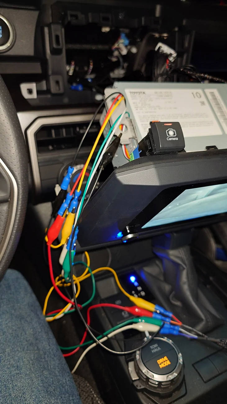

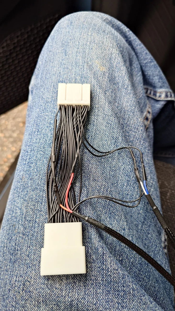

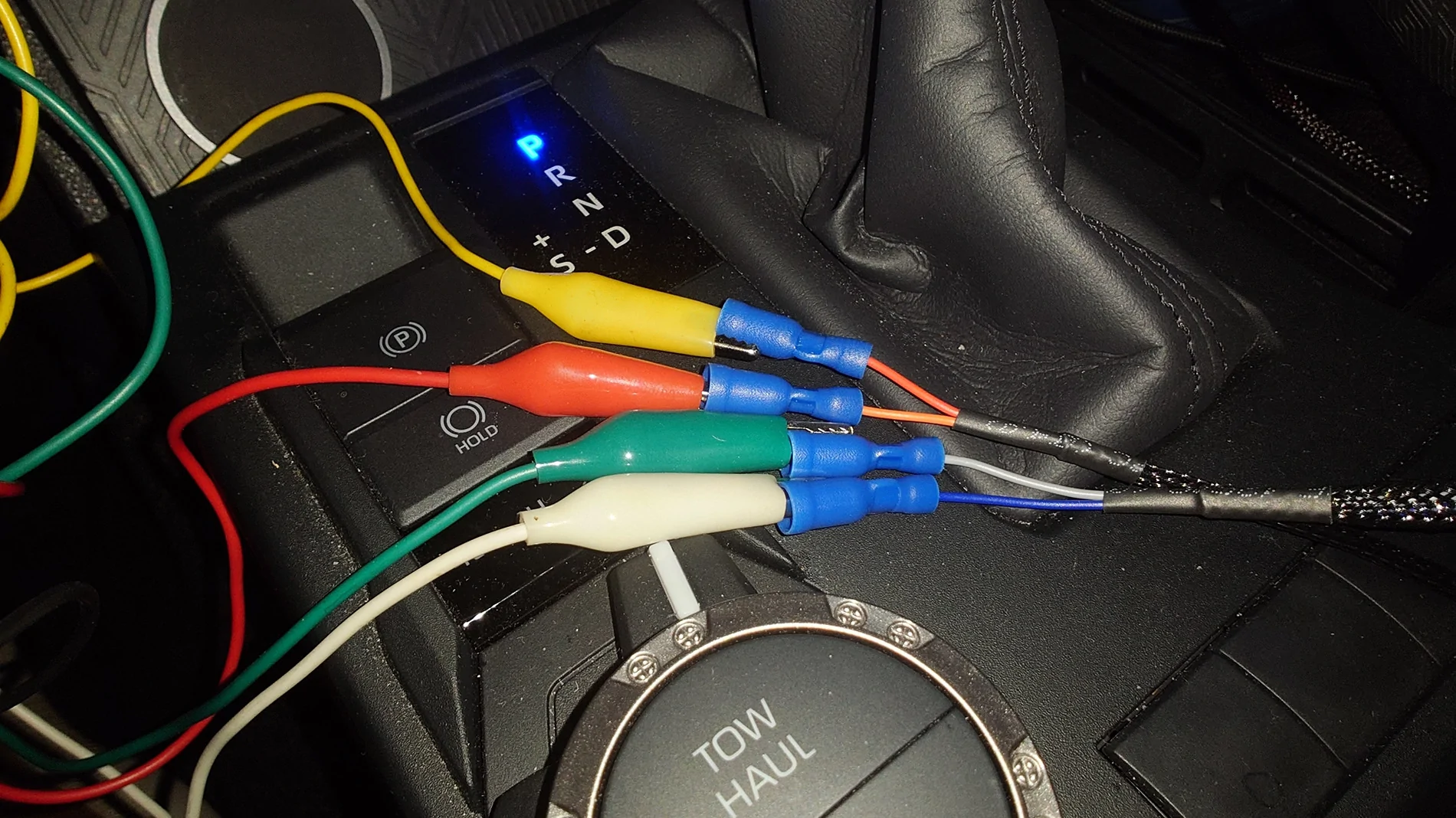

...and jiggling the wires around to get clear pics of all the connections I just blew the fuse for the dash backlights so I can't video it all working. (it still works just my dash backlights are all out now) I'm done for the night!
The alligator clip leads colors here all match the wires on the square switch. So those are the same connections you would make by color. The black wire is ground clipped to the frame.
This is after transplanting the blue & grey from the video harness to the main harness.

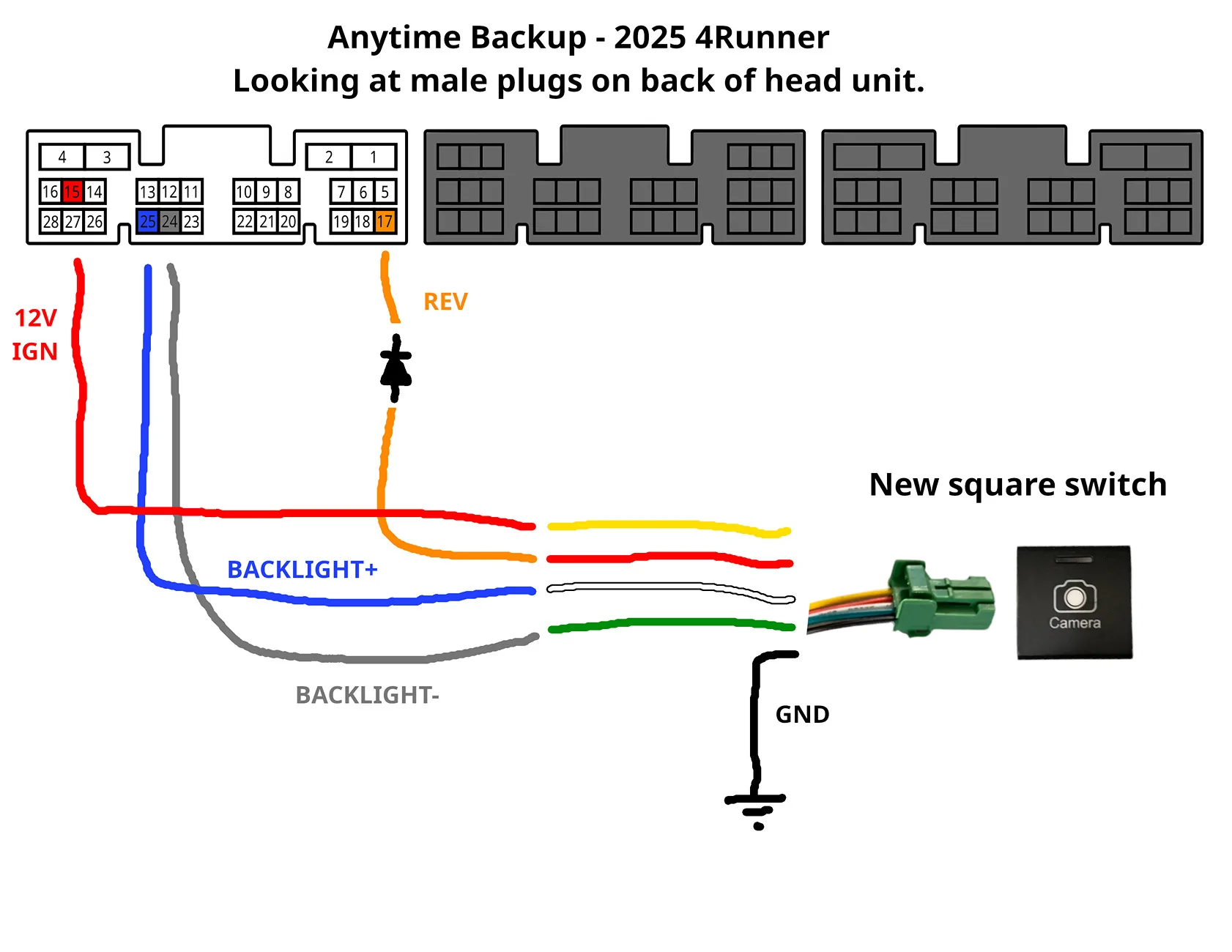

Grey: backlight - on pin24
Blue: backlight + on pin 25
If you want to avoid buying the video harness, all these do is just tap the wire. The wires still connect stright through from the male to femal plug. So you can just buy the tacoma 2025+ harness and just tap the wires on pin 24 & 25 any way you want.

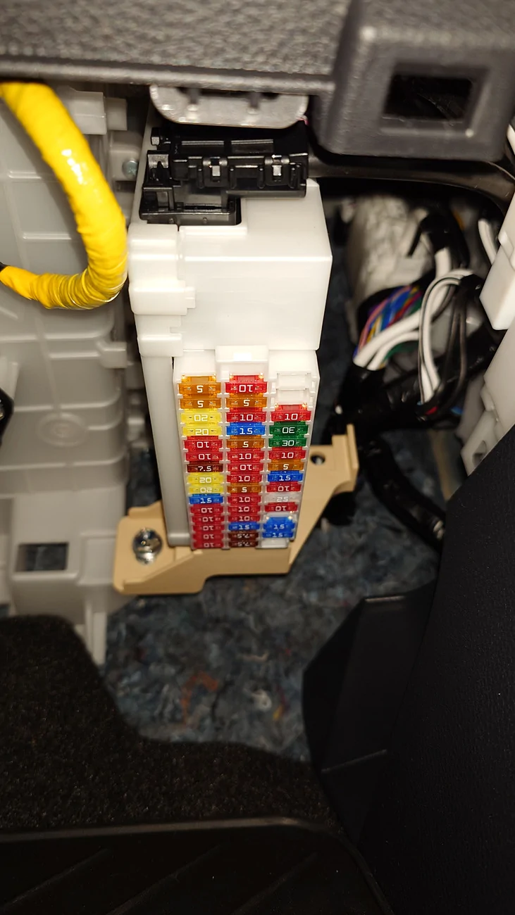

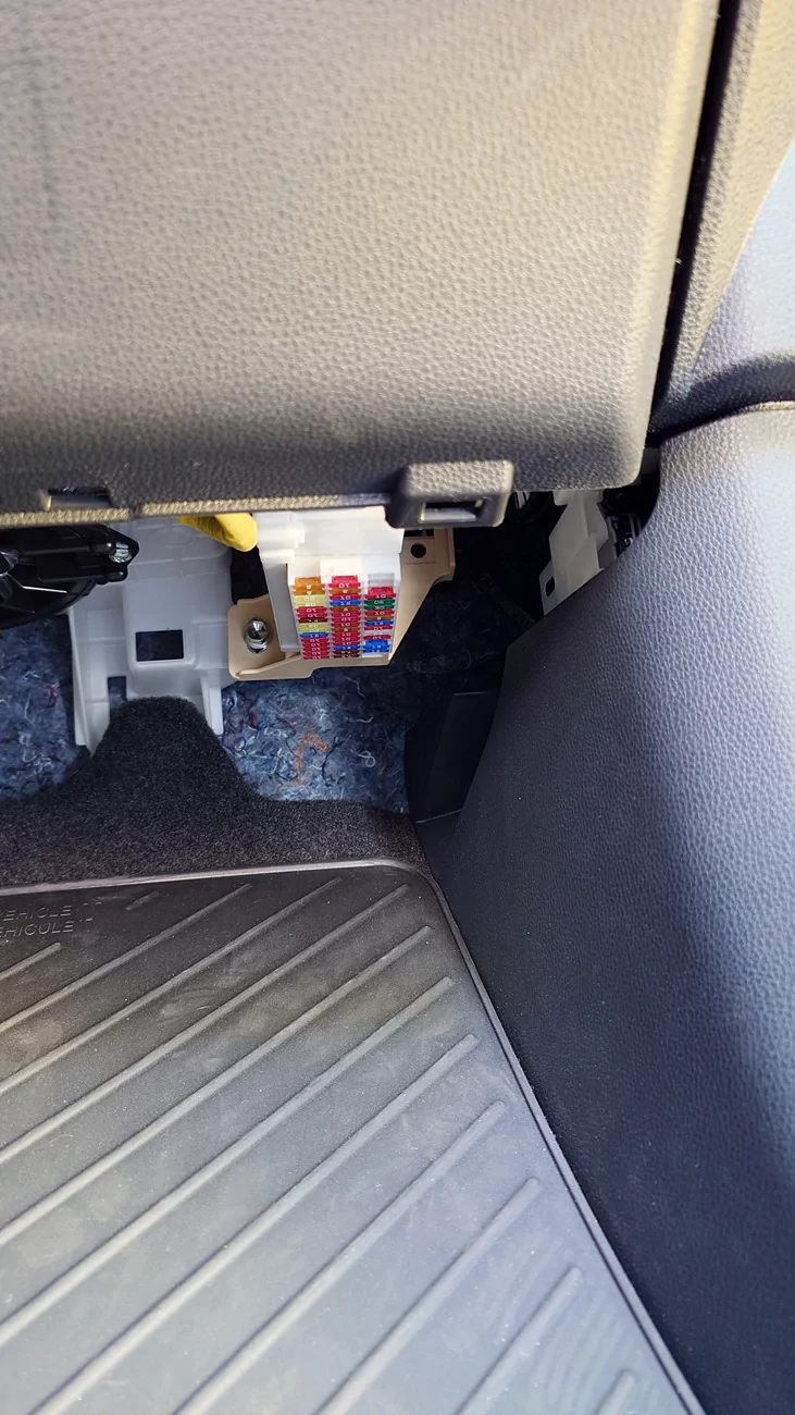

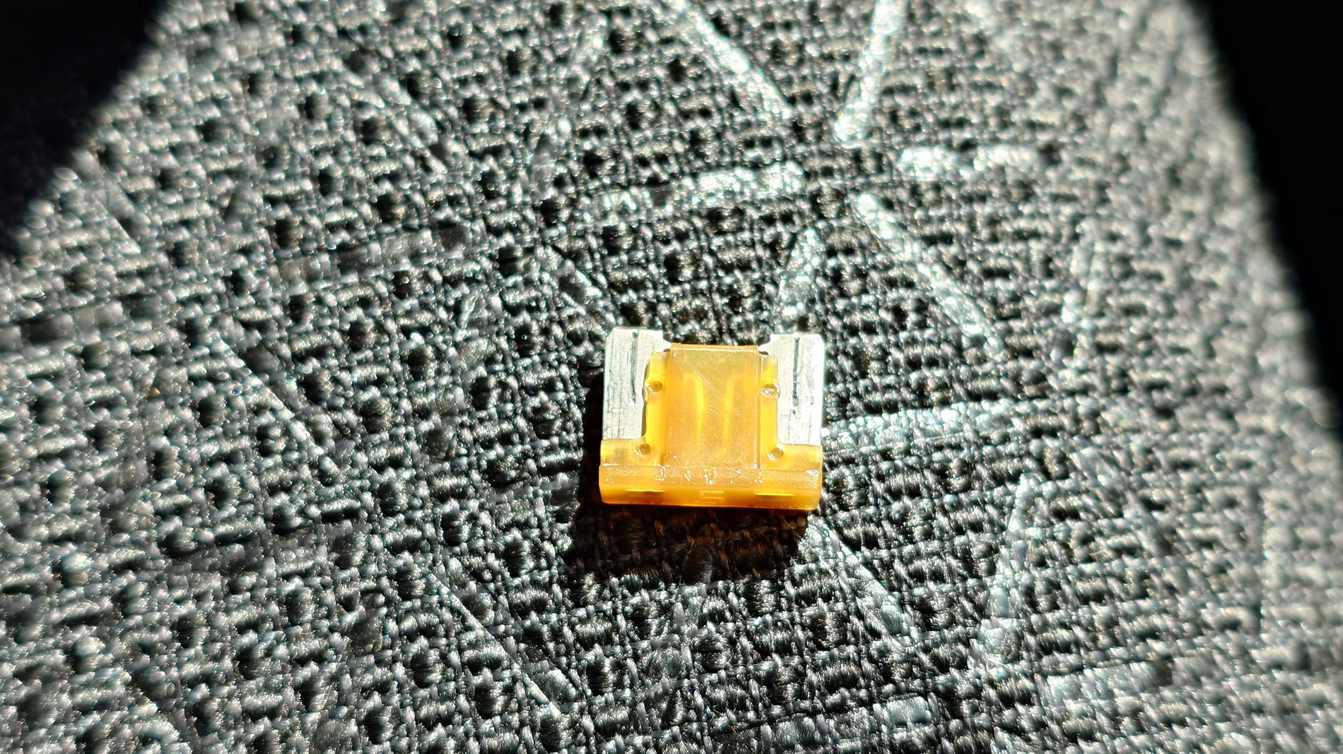

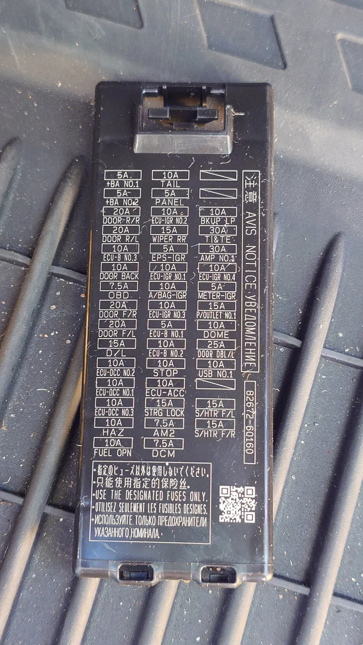

yeah the fuse was no problem. under the glove box, the 5A labelled PANEL. ATM-LP type.

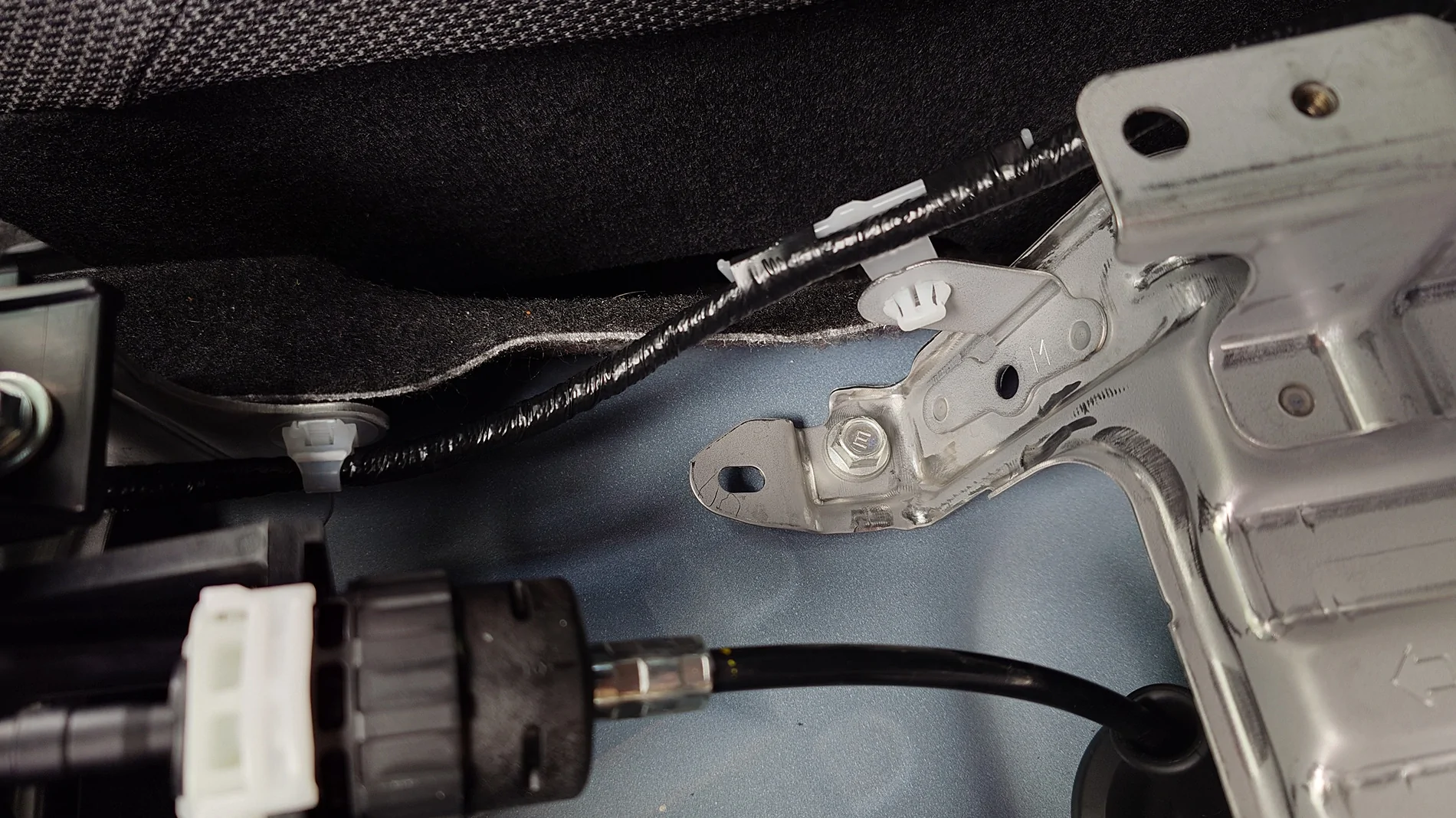

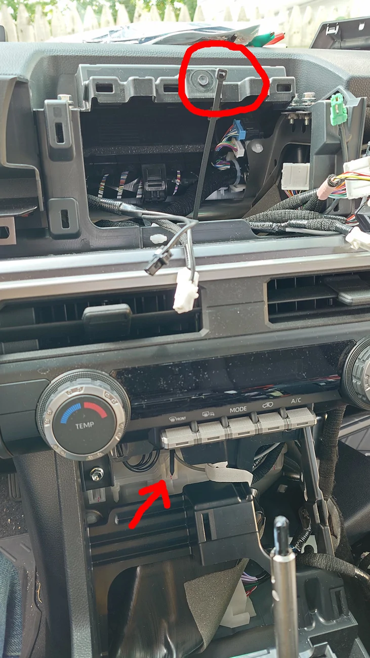

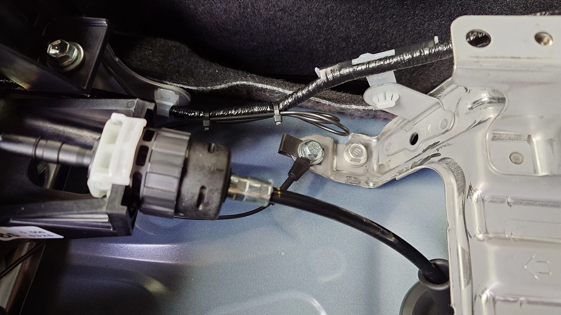

Zip-tie to fish a path from the radio down to the shifter. I taped the long wires from the harness to the end of the zip tie to pull them down from the radio area to the shifter area.

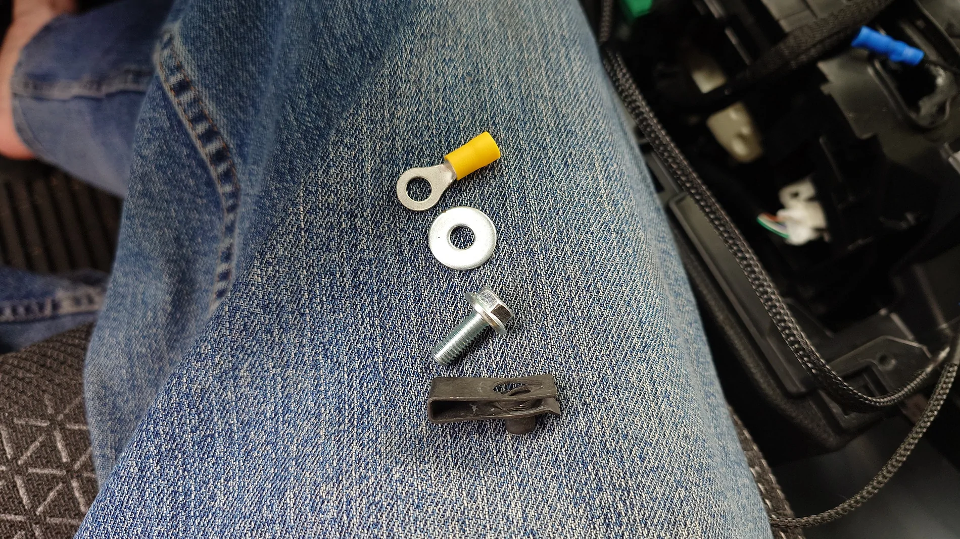

There's a great spot for ground under the console but it's just a tab with a hole, so you just need to supply your own speed nut & bolt to use it. M6 is overkill but I already happened to have this M6 speed nut and flange head bolt. Autozone has a bunch of different speed nuts, probably home depot & lowes too, ace hardware, etc.
https://www.autozone.com/nuts-bolts...eda-parts-m6-1-0-speed-nut-2-piece/551888_0_0
https://www.autozone.com/nuts-bolts...-m6-1-0-x-16mm-flange-bolt-8-piece/848414_0_0
The wires coming off the anytime backup harness are basically the perfect length to reach all the way to the switch installed where I have it below the shifter. I originally thought I was going to have to add some wire in the middle but in the end I just cut off the female bullet connectors I had on the switch and crimped males on and connected the harness wires directly to the switch wires. I taped up the bundleso the plastic insulators on the crimp connectors wouldn't rattle on the metal under the shifter.
The black wire from the switch goes to the speed nut. Crimp on ring terminal big enough to fit the bolt. Excess black wire zip tied to the nearby wiring harness to keep it from flopping around.
I still have to draw up a clear reference diagram but all of the necessary info is here at least in the form of a few of the pics and descriptions. I edited one of the early posts to add a pic of the stickers that come on the bags for the anytime backup harnesses, which was the only place that info existed anywhere. It's not even on their site. And a few more bits of reference pics below.

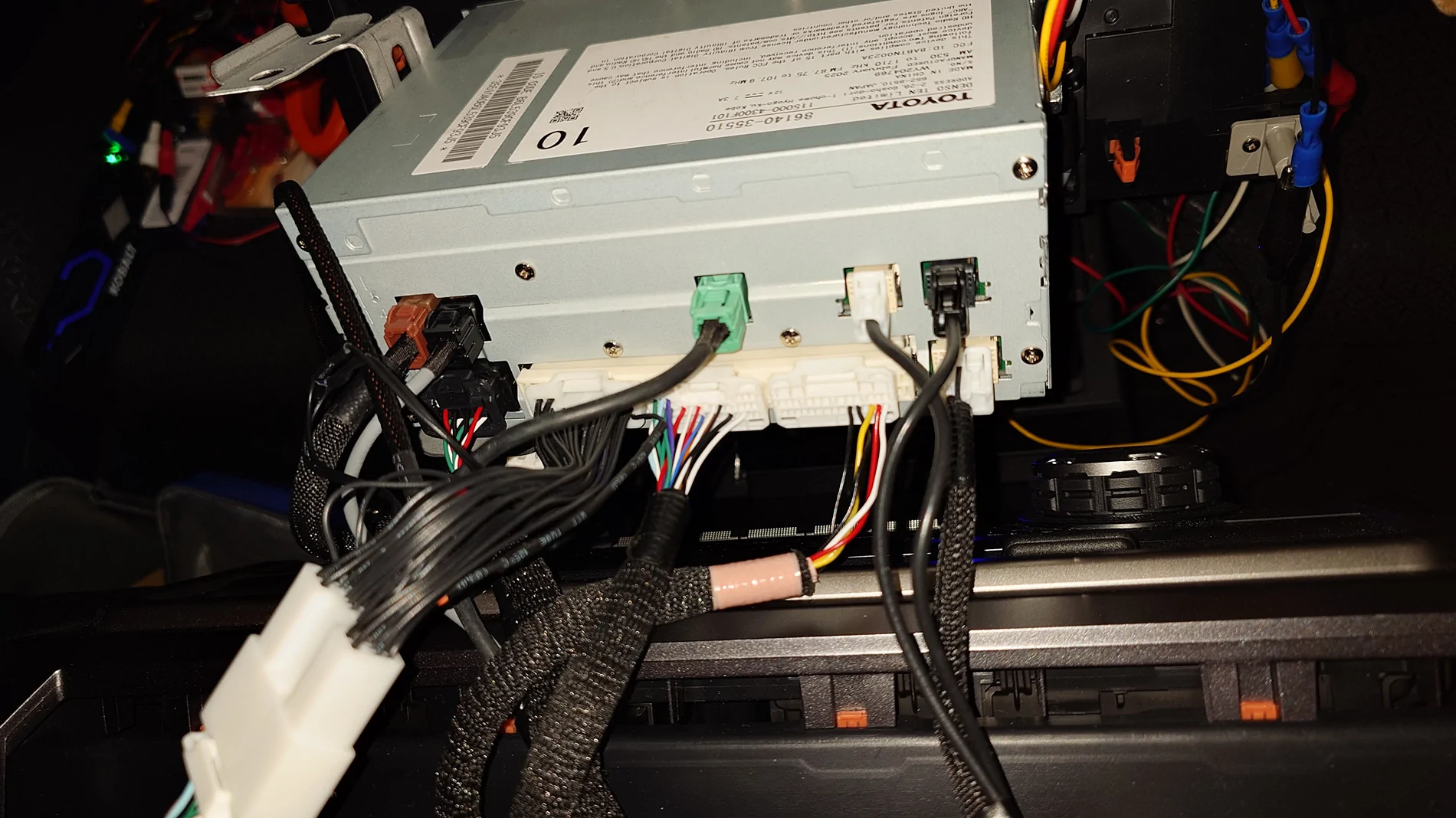

Apparently switching this kind of high speed data lvds is not so simple. The signals may be over 3gb and that requires special handling.
https://teslamotorsclub.com/tmc/thr...t-for-switching-front-and-rear-cameras.20657/
I mean I would still try it, it's only 4 pins, just switch all 4 with a 4-pole relay and see what happens. Maybe it works fine, maybe the data is so noisy the screen is just black, maybe it maosty works with noise and glitches. Maybe it would be good enough to enclose the entire relay in a shielding box.
But at the very least it means finding the part number for the official forward-facing camera, to get a camera that outouts the same kind of signal and so the image isn't left/right mirrored. I can't figure out the 4runner part number but I did find a tacoma part number and they are $150 on ebay, but they do look right with a 4 pin connector and fitting 2024-2025 tacoma.
https://www.ebay.com/p/25073231098
And if a simple relay corrupts the signal too much then it means a fancy circuit based on a DS25CP104A or equivalent high speed 4-bit lvds bus switcher. Blech.

The mounting angle is no problem. I didn't mention it because it no longer matters, but I found other cameras that are adjustable yet still pops right in the same hole no problem. But those cameras are not usable anyway because the problem is the type of video signal.
The head unit does not accept the old cvbs type of video signal any more.
In order to make a front camera now, you would need:
-- The oem front facing camera, to get a camera that isn't mirror image and outputs the new lvds high speed data kind of signal (or whatever it is, we don't actually know, it could even be usb). I don't know any of the actual 4runner part numbers, but I think I found compatible tacoma and rav4 front cameras from 2024+ on ebay. The camera probably works but the mounting bracket is wrong. I think the camera can be seperated from the mount and you make your own mount. The important part is it's a camera that speaks the new lvds signal and doesn't put out a mirror image like a backup camera does.
-- Male and female versions of the green 4+2 pin plug. I found some on aliexpress for $20 for a single plug, and only the female side (the same as the end of the wire in the car, not the jack in the head unit. It might be necessary to make these from scratch with wire and 3d printing.
-- Trial & error the pinout and hope that doesn't damage anything before you land on it. (not that risky because you can just buzz out the connections from the green plug to the rear camera and assume the front camera is the same, you can also look at the signals while running to find power and ground at least, probably.)
-- Some way to switch probably 2 or 4 conductors of 3ghz signals plus another couple simple power. I found some 12v 4pdt special RF relays that claim to handle up to 800 mhz or so. Maybe that would actually be good enough without having to design an actual pcb and schematic using a proper high speed bus switch ic. Though they are surface mount so hard to use without a pcb anyway.
So I have only the anytime backup part working. Press the button and get the rear view any time, and it's backlight works on the dimmer with all the other dash controls backlights.
That was doable only because that does not involve a camera or even touching a video signal, all it does is raise a single wire to 12v, which tells the head unit to do the rest itself.

Wiring diagram.
The harness only comes with the red and orange wires.
You have to tap the pin 24 and 25 wires yourself.

The Beatsonic front camera kit (Beat-Sonic CS15 Front Camera) works. A plain old ordinary cheap or expensive analog composite ntsc camera displays right on the factory screen. Halleluja!
The only annoyance is they didn't hook up the button backlight wires even though they could have, the pins are available in one of the connectors they tap into. So you have to splice those in yourself. See my diagram above.
By default the camera switches itself back off after 15 seconds. This is programmable, but the directions are not on their web site, only on the included paper sheet.
By default it always only switches to the front camera, ie you don't get the "anytime backup" option, but apparently this is also programmable.
Thereis actually provision for a 2nd camera.
I haven't fully verified the various options because I have to stop working on it for today but it looks likeeven thopugh it's not the defaulty behavior you can set the timeout to 5 to 20 seconds or no timout, and can have anytime view like anytime backup, and I guess at least 3 views cycling between the normal backup camera and up to 2 added.
The 2-camera thing could be cool for crawling, you could have a dedicated camera for each front corner looking right at the tires. I might use it to add a rear view that's high up instead of the normal one, to keep an eye on trailers. Maybe even a wireless one that you could just pull out and stick wherever you need it in special cases.
Really since it takes an ordinary video signal the sky's the limit. There are all kinds of video switching things that let you switch bewteen a bunch of cameras, combine a bunch into a single display like what a security system does, wireless extensions, recorders, you could even have something like a borescope looking right at some part while driving, or simply let a passenger watch a dvd even though Android Auto & Apple CarPlay tries to say you can't do that. I think I'll take that 2nd video input and run it to a jack somewhere that's always acessible. Then you can use it just whenever for whatever.
