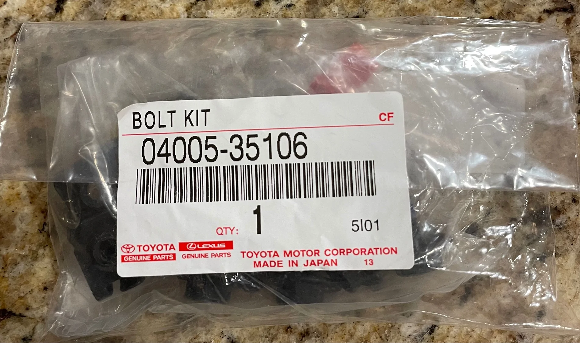

Took my 4Runner to dealer for the state inspection. They recently got a service bulletin on the air dam fix. I already removed it but they gave me the replacement bolts if I wanted to put it back on. Looks like the fix was blue Loctite…

Those bolts are only half of the equation. They won’t work with the existing spring nuts that use a coarse threaded screw.

my 4runner build date of 8-22-25 had the new loctite screws when i removed mine if i remember correctly.
