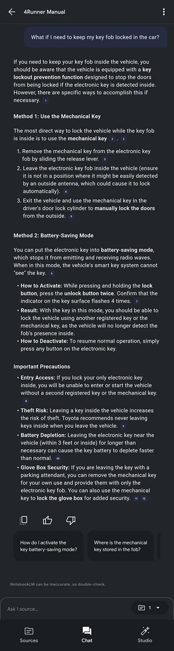

From Notebook LM reading the manual.
I’ll have to try that. I’m renting a camper van for a long road trip and the only vehicle that can transport my bikes to it is the runner with out having to pay another’s day of use. they will need to move from the outside lot, to inside of a locked gate because I’m picking up the van after hours.Only thing I could think on why I couldn’t just leave it in the front it seems it could be in a sketchy area of Denver? It’s kind of a difficult situation.
