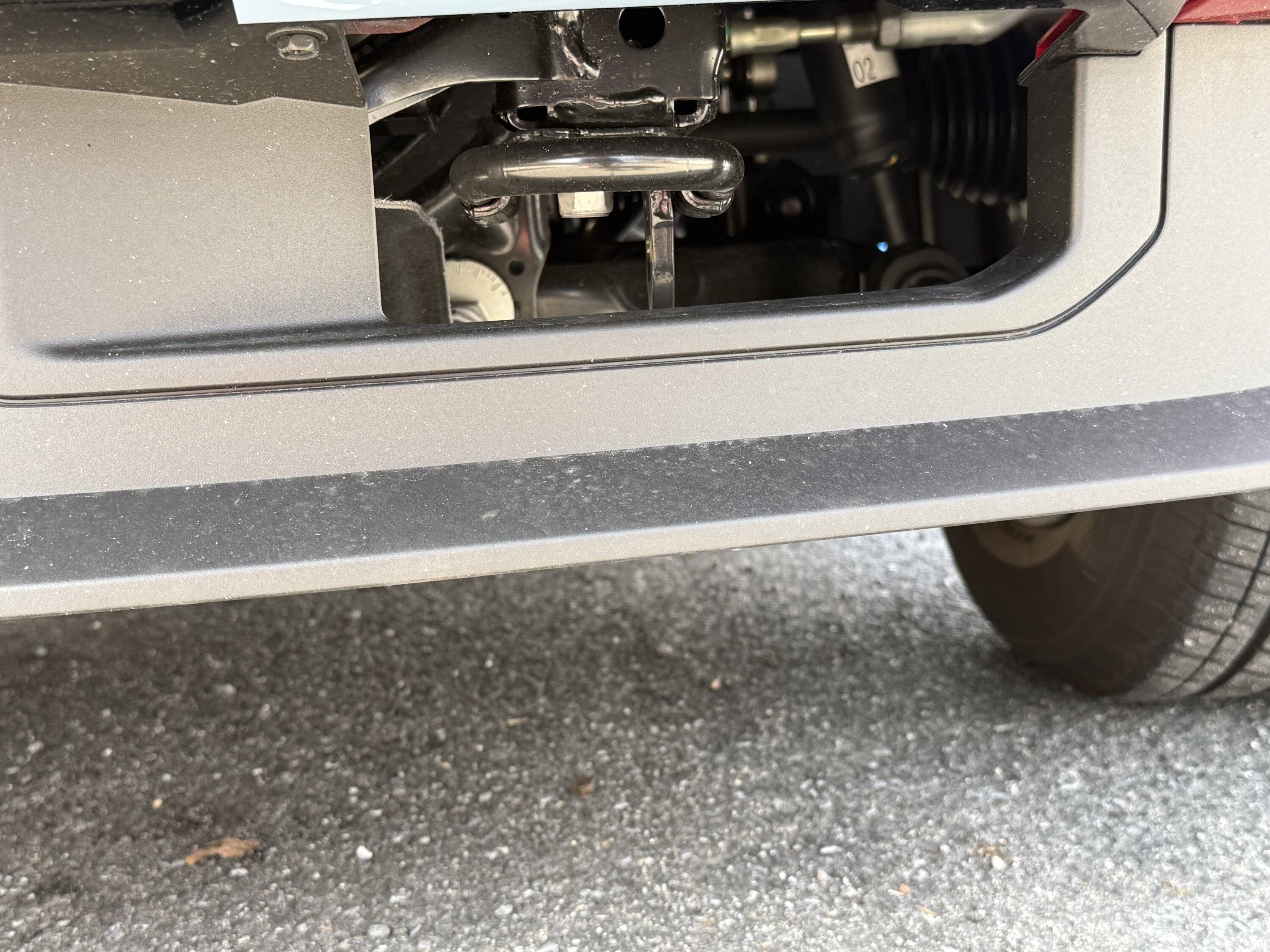

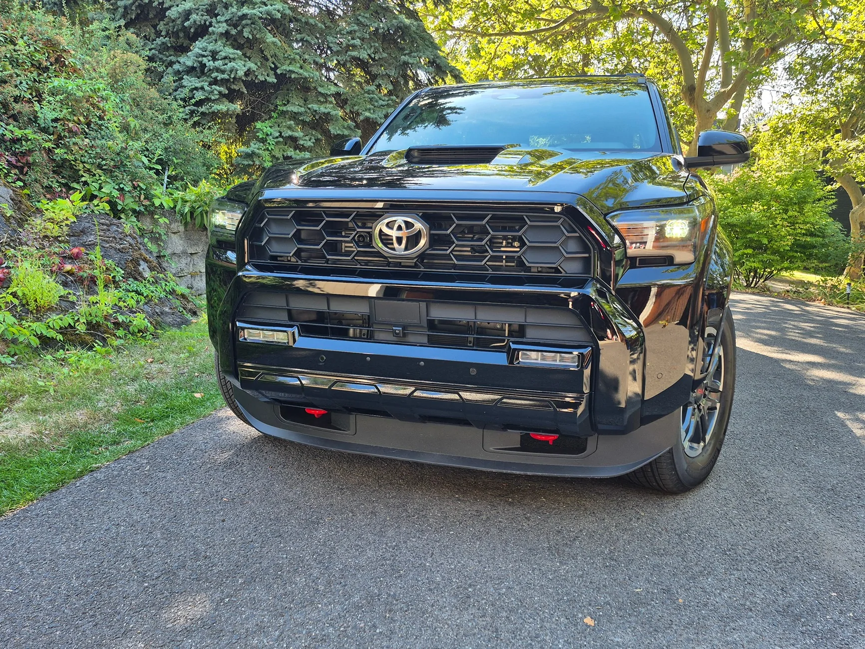

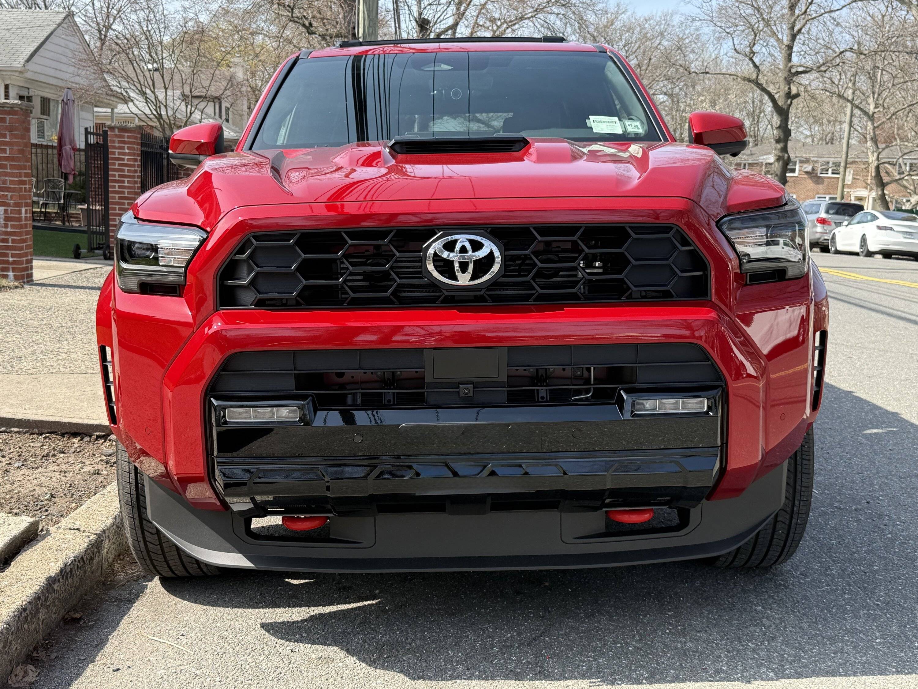

Any advice when spray painting the hooks?
I sanded mine down just to knock off the shiny finish. Then primed with self etching primer. I then did 4 coats of rustoleum red apple gloss spray paint. Let it dry over night.
